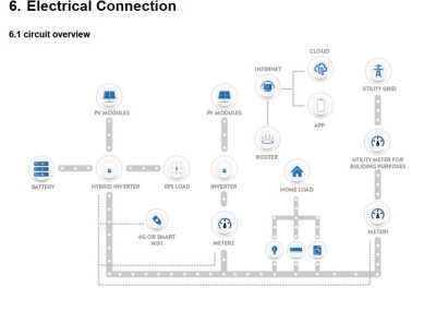

This diagram is from the manual which explains the connections.
Your existing micro inverters should be connected where you can see 'METER2' i.e. you will have 1 or a number of phases coming in from the external micro-inverters and they would be connected via a second meter. This meter would be the same as Meter 1 ~ i.e. a Chint DTSU666 (either direct connected or using optional CT's)
It would measure the generated power from your other PV modules so that it can include it within the Fox metrics.
