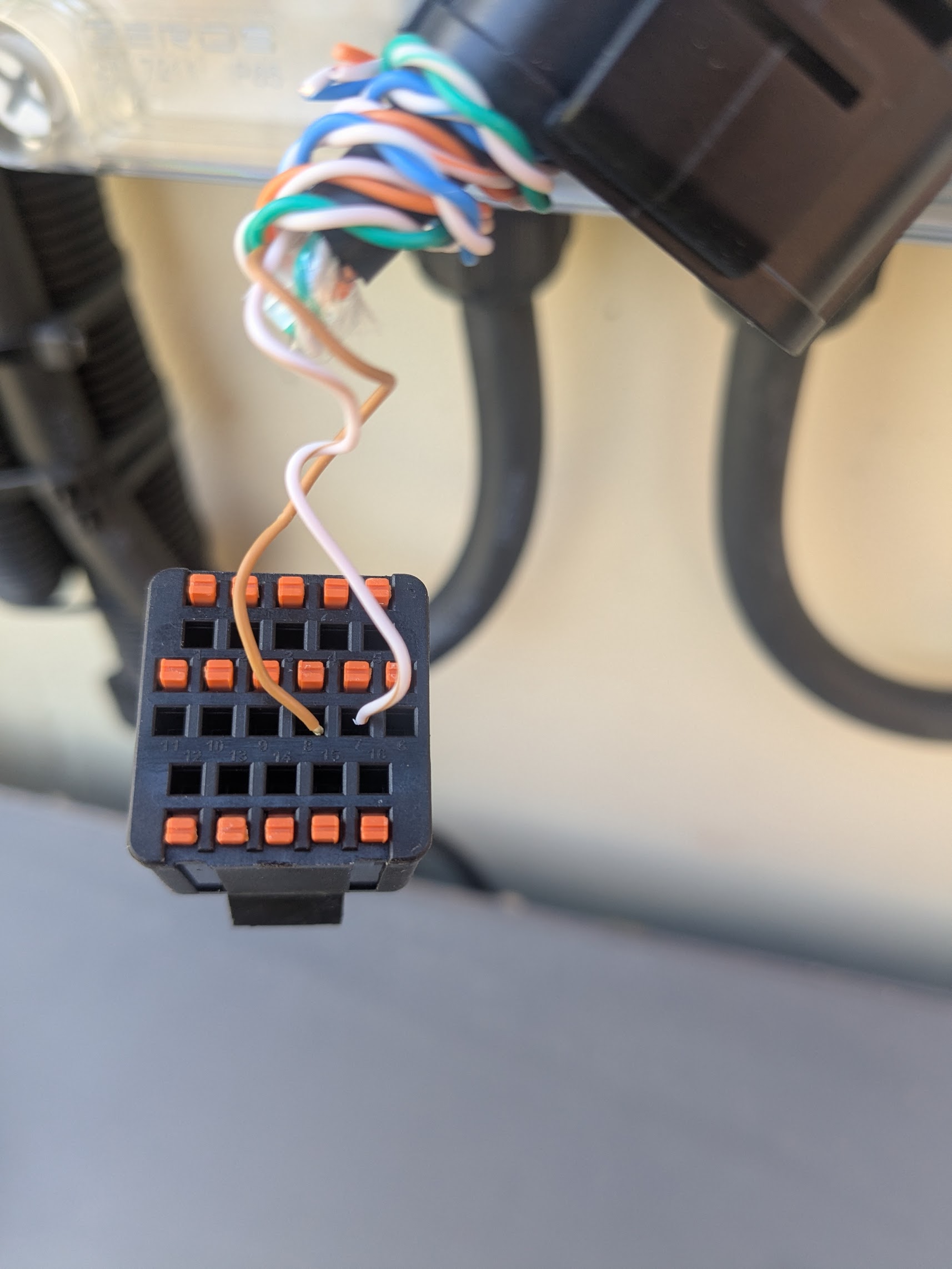

I've got myself an Elfin EW11A and I'm planning to wire it up to my H1-G2. Managed to shut down inverter, disconnect and disassemble the RS485 16-pin connector to take a look and (after a little scare with the RCD tripping, lots of error codes and zeroes everywhere) get it all back up again without breaking anything. The inside of the connector looks like this:

Except... they haven't. Now what? Are those orange things just spring clamps - can I just pull them back and stick the RS485 wires in?
Update: after looking at viewtopic.php?t=1658, I found a cable I had lying around with a couple of flat crimp pins and wired it up to the Elfin.
The problem is, the communication connector just doesn't seem to hold the pins at all and they slide right out again.

Those are push connectors on the new gen2 plug. You simply need to push the orange tab in, insert the wire and release and it should have a good strong connection. Check the guide to confirm the pins but I believe it's pins 3 & 4 https://github.com/nathanmarlor/foxess_ ... ring-Guide

Thanks - I did try pushing the orange tabs in with a tiny screwdriver, but it didn't seem to grip; maybe the pins I have aren't long enough. I'll try again with (longer) bare wire.

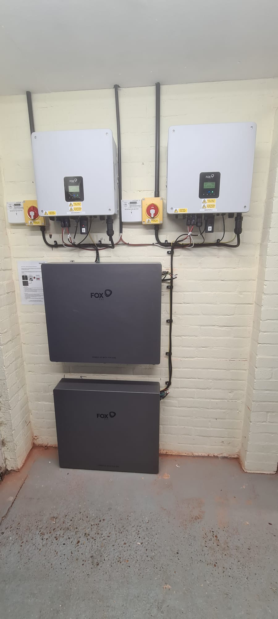

I have had 2x 6KW H1-6.0-E-G2 Inverters installed as a parallel setup with each having 1x 10KW EP11 battery.
I plan to set up the HSA connection as per @simoncozens described but I only have one CT connected to the Master Inverter and the Slave inverter has a blank over the socket where the Meter/RS485/CT clamp socket is.
My question is, as the Inverters are in parallel mode with only one CT but two meters, do I need to create two RS485/Wifi connections which means getting the plugs from the installer or does a connection to the Master inverter serve both.
Here is a picture of the setup:
