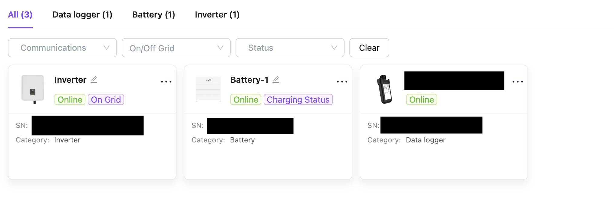

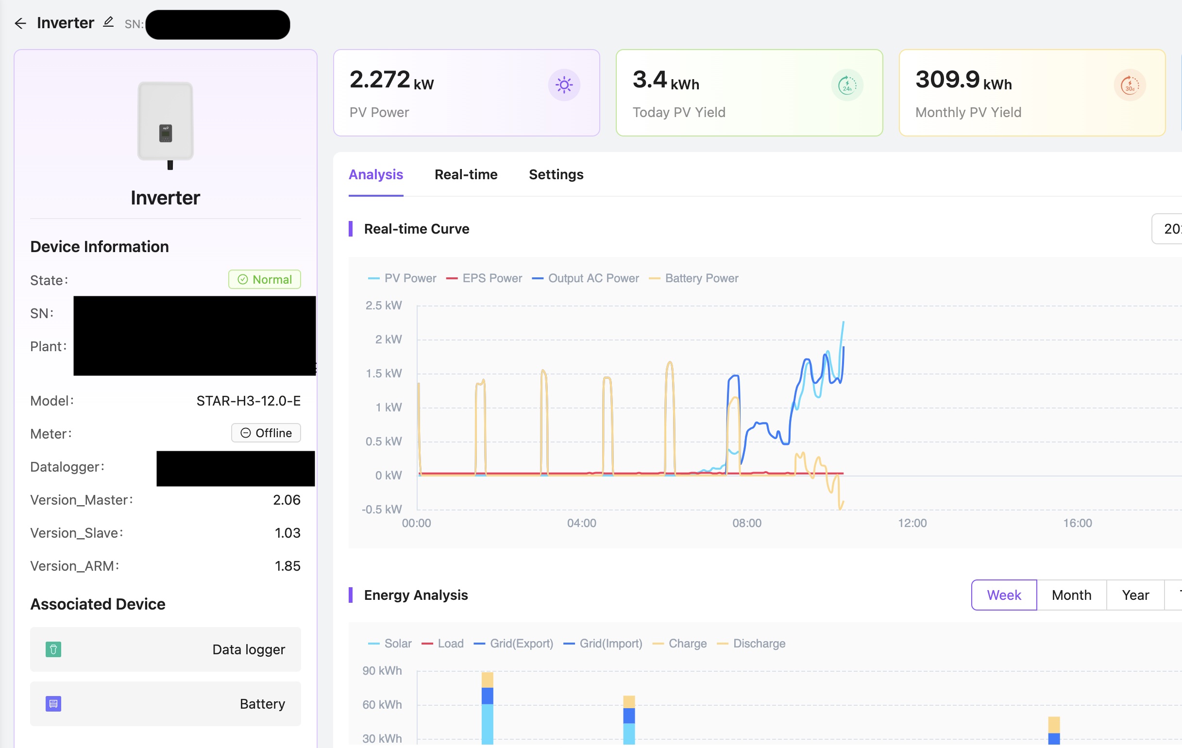

Current Status: Meter shows “Offline” under FoxESS Cloud (see screenshots)

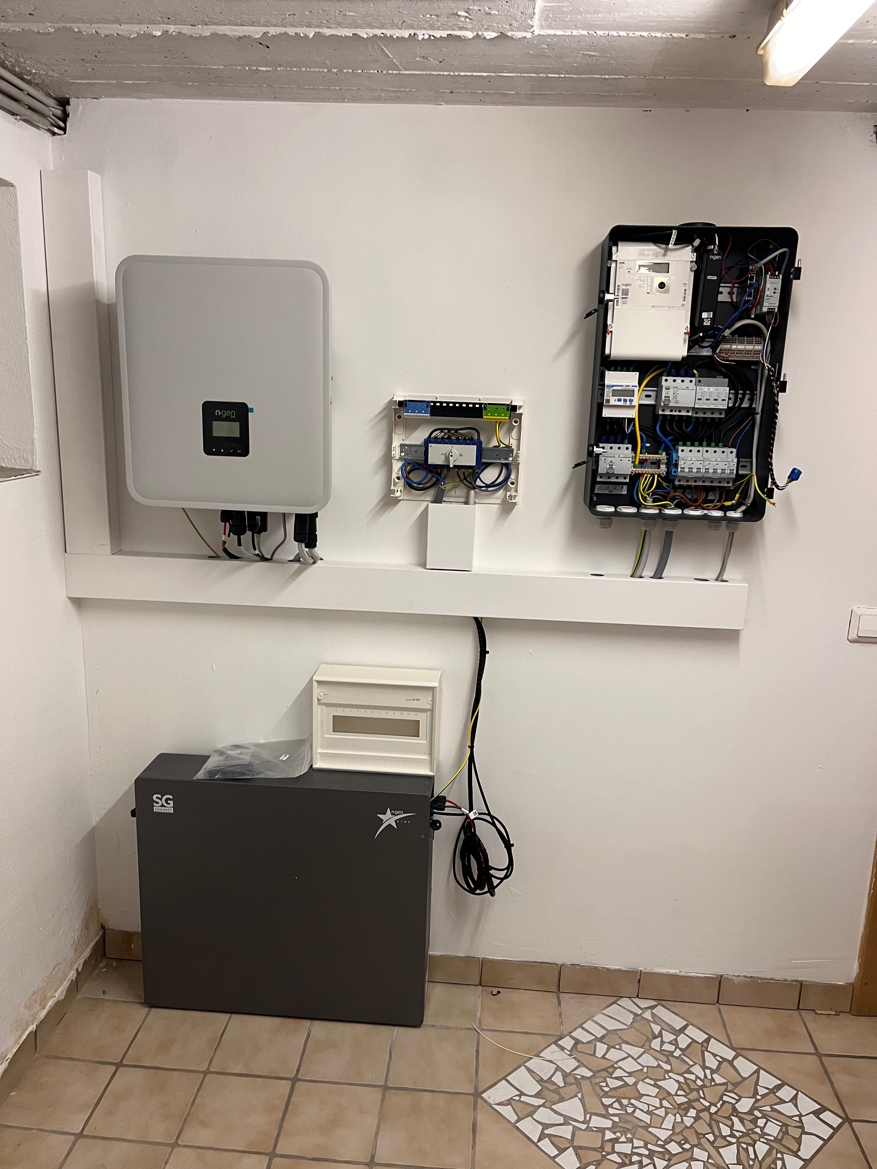

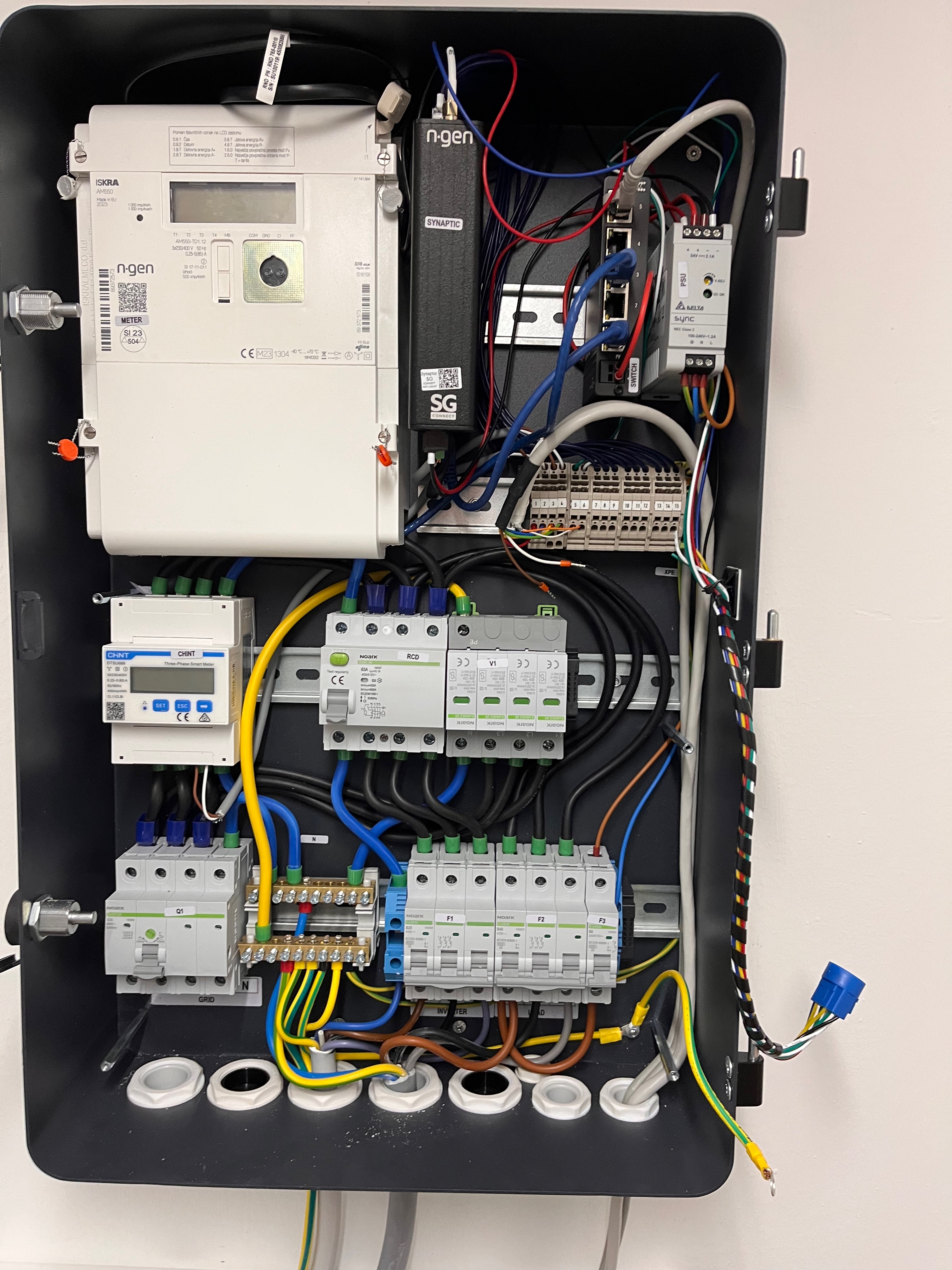

1) Does the wiring and component layout look solid to you? Photos attached.
2) Is it expected that the inverter shows Meter “Offline” in the portal even though the meter is clearly working (real-time readings on load, production, feed-in)?

I’ve attached photos of the installation (inverter, distribution box, battery) and screenshots from the portal. Your feedback is massively appreciated — I just want to ensure everything is safe, efficient, and future-proof.

Nice install, very neat.

Thank you. I am also very happy with your support - the team upgraded the to the latest firmware, except HMI/Manager/ARM remained on 1.85 (instead of 1.87) as the reasoning was that this is only suitable for the german grid system - if this is a misunderstanding from support, it would be good to clarify with them (ticket = 57945).
