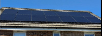

Still getting used to how my Solar system is working, after it being installed (and working for 3-4 weeks). As I look more into the reports, wonder if it is normal for 1 string to work better than the 2nd? My setup is - 14 x AIKO-A-MAH54Mb panels (south facing), 1 x H1-6.0-E-G2 Inverter, 1 x Fox 10.36kwh EP11 battery and a MyEnergi Zappi EV charger (wired separate from battery)

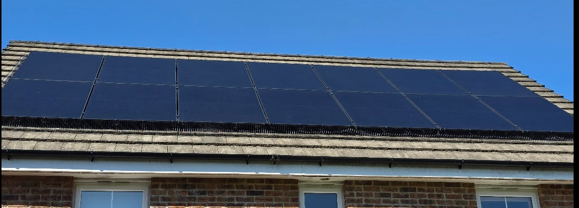

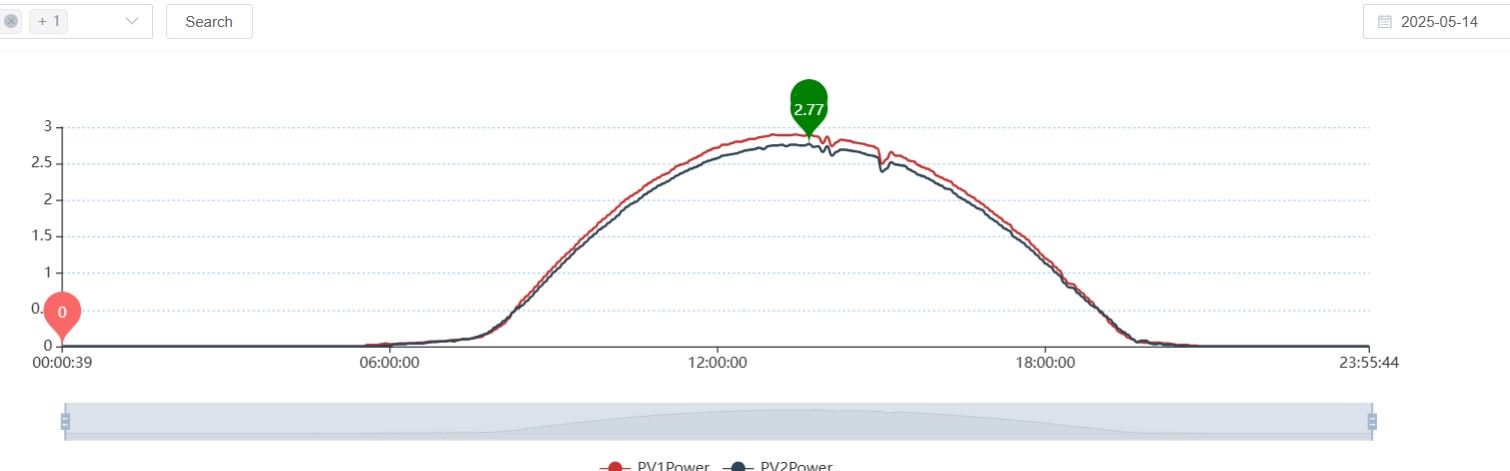

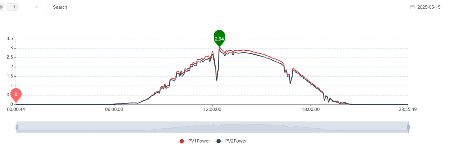

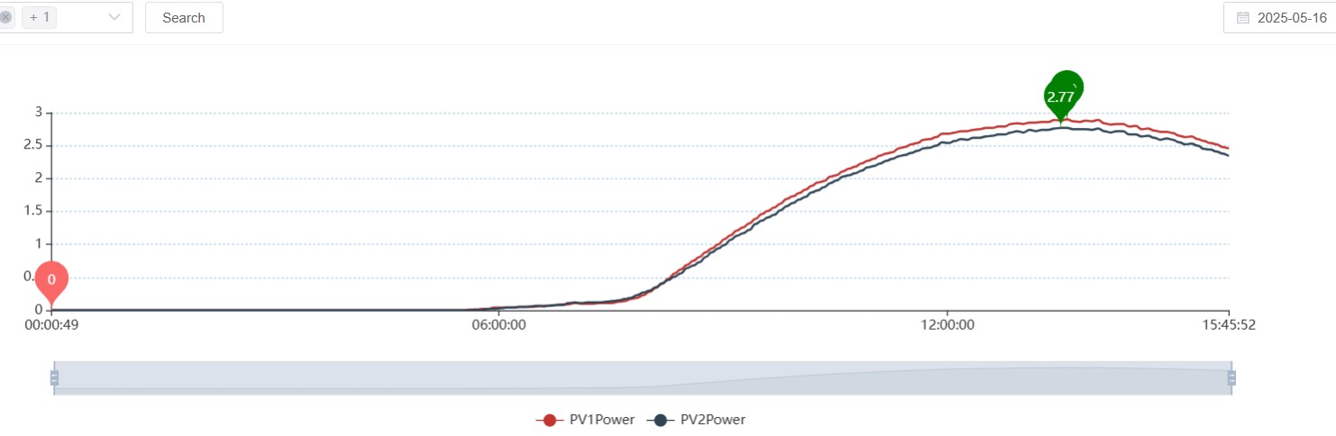

Looking at the last few days .. can see PV1 always outperforms PV2. In the pic of my solar array, I am not sure which is PV1 and PV2
It’s not unusual and the difference I can see there is only marginal, it’s most likely the top string is hotter than the lower string (heat will be rising from under the black panels) and for every degree above 25C you will see the panels derate by approx 0.5%
Thanks Dave, yet again thanks for the advice .. it is a good learning curve this solar stuffDave Foster wrote: ↑Fri May 16, 2025 4:26 pm It’s not unusual and the difference I can see there is only marginal, it’s most likely the top string is hotter than the lower string (heat will be rising from under the black panels) and for every degree above 25C you will see the panels derate by approx 0.5%
The slight difference can even be down to the dc solar cable length. I bet one string has a slightly longer cable run.
