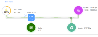

On the latest firmware I have, which is:
Model: KH10.5 - Master: 1.43 - Slave: 1.01 - Manager: 1.42
Last night I had this work model, see screenshot. Min SOC 100% is the key component - I was wondering what it would do.
At midnight the battery started to charge from the grid at a rate of 1.25kw.
My question is, why 1.25kw?
Thanks!
Thanks!
Posts: 1887
When you raise minSoC above the current SoC level the BMS requests a maintenance charge to bring the SoC up to the same level (i.e. not a full power charge), this is the same as would happen should SoC drop below 10%.if42 wrote: ↑Fri May 16, 2025 11:10 am On the latest firmware I have, which is:
Thanks!
The maintenance charge is at approx 4A and is hard coded - it which would suggest your battery voltage was approx 312V at the time.
