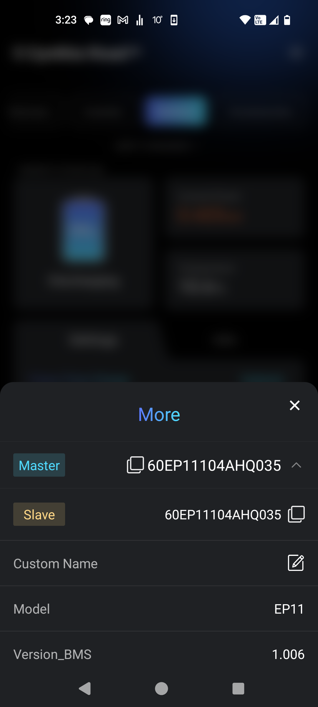

Hoping someone may be able to help with the app settings for discharging back to the grid. Have read the forum and watched videos but nothing is working.
I have managed to successfully set the app to charge the battery from the grid between 12.05am and 6.55am which is working fine but this setting stops working when I try to force discharge between 10pm and 11.59pm.
If anyone has any tips or if I am missing something completely, any help would be most gratefully appreciated. (I have added some pics to show what settings are currently setup based of web info).
I think the shortest answer is to say you cannot mix Force Charge Periods and Scheduler, it's one or the other - scheduler will disable your force time periods.
To do what you want to do, just use the scheduler and disable any force charge slots by setting to 00:00-00:00 - then use the scheduler first entry for your force charge 12.05 and 6.55am and the second entry for your force discharge between 22:-00 and 23:59
