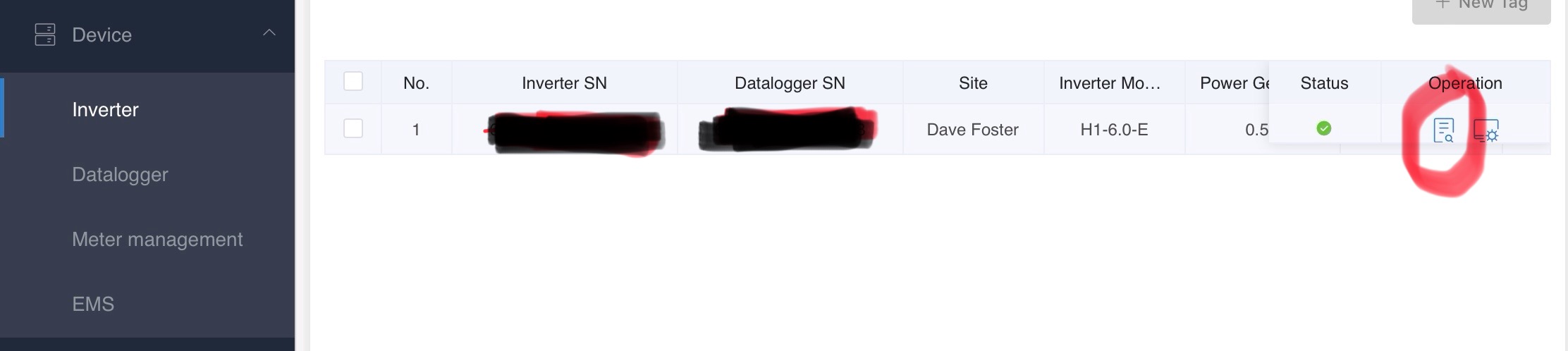

You need to go to the Inverter Details page, click the link circled here
Will take you to this page where at the bottom you have the blank graph at the bottom and you can select SoC
