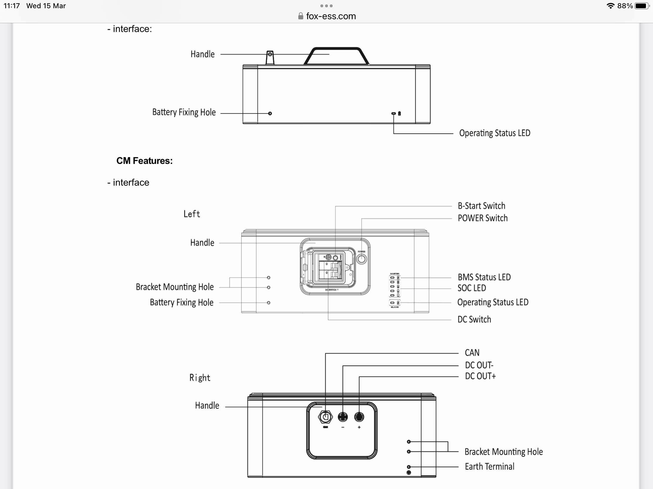

Can you please explain item 2 above. I have cube battery and cannot see a power switch
Posts: 1303
ianrob wrote: Wed Mar 15, 2023 11:12 am Can you please explain item 2 above. I have cube battery and cannot see a power switch
Hopefully that should help, its on the master module (CM)
