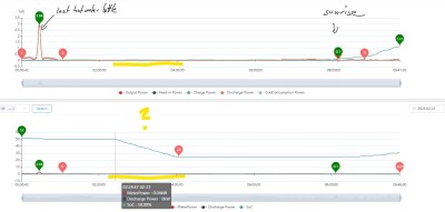

I just woke up with an empty battery. Then I encountered a strange discharge of my battery cube (CM4100, base + two bars = 10.89kWh), which would describe as: linear discharge without any load.
I have set the minimum SoC from 10% (factory default) to 25% (is that okay?). This is probably what made the drain stop.
The following screenshot describes the phenomenon quite good I think:
Needles to say, that there where no scheduled consumers this night. Also I can not find any load, feed-in or even discharge for that time.
My question is: what happened to my battery last night?
