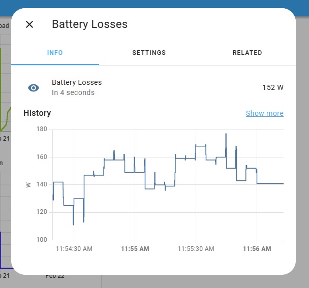

I use a home assistant that calculates the near real time losses at any point in time, this includes the 60~70W the inverter needs to stay operational which it takes these from the DC side (battery/solar), not the AC output - this is the current graph with some solar coming in as well
When you are doing your 94% to 14% soc calculation do you take any losses into account?, over time they will become more significant - it's probably safe to say overnight there may is a typical average of 120Wh lost so if the 80% change in SoC is (say) over 10 hours, you would need to account for the 1.2kWh which would come from the battery.
Of all the things in your system, solar generation, grid usage, export and in particular battery health are such key parameters and I would strongly recommend the installation of a Home Assistant as even when connected to the FoxESScloud it gives you access to many more sensors and even with 5 minute granularity of the cloud it's easier to work out solar generation, battery use, capacity etc.. in almost real time. - you can see more here. viewtopic.php?t=18

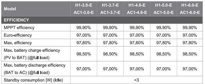

Similarly, I recognised my calculation ignored the inverter conversion losses. Since it is fed by the battery and I am only recording the energy output from the inverter, I can't measure those losses. I was mostly relying on the quoted numbers in the datasheet which refer to 97% efficiency for Battery to AC, though I appreciate the caveat of a spec. at "full load". see below:
Your assessment of 60-70W just to run the inverter is 3x more than I was reckoning from the figures I see on the power figures. Typically the PV power is 20W or so greater than the delivered power to the battery plus the house. I must look more closely when the house load is met from the battery but only 100-200W. You are correct that my overnight energy demand is mostly below 150W - with your figure of 60W to simply run the inverter, then I am easily losing 30% of the battery energy just to keep my house "alive" when the sun is not shining. That is a lot and means my original assessment that a 5.2kWh battery should be sufficient may be seriously out.
