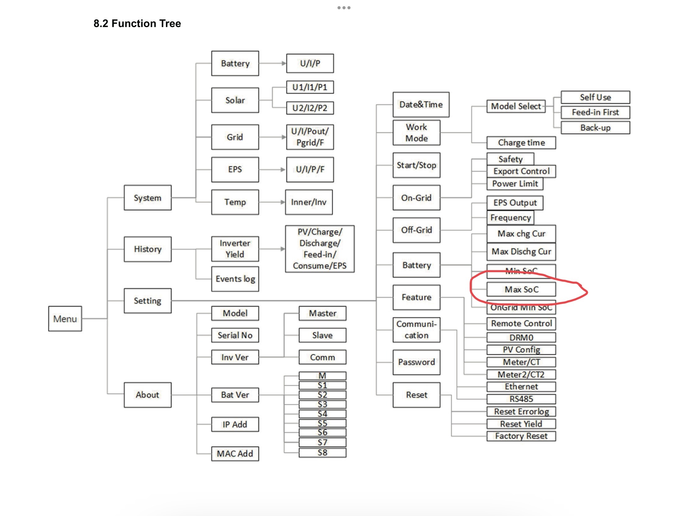

The second option can't be done on the app, it has to be done in inverter settings.
There is a setting called Maximum SoC, this limits the maximum amount the battery can be charged for off grid, but allows it to fully charge off solar - it's more fiddly and you have to be at the inverter panel to change the setting, it can be found here.
It can be accessed via the mobile app or Ess Cloud if your account is setup as an installer account rather than a user account. But if your installer has used their account to access your inverter, you'll have to ask them to release it and they'll then lose access so may not allow this.
