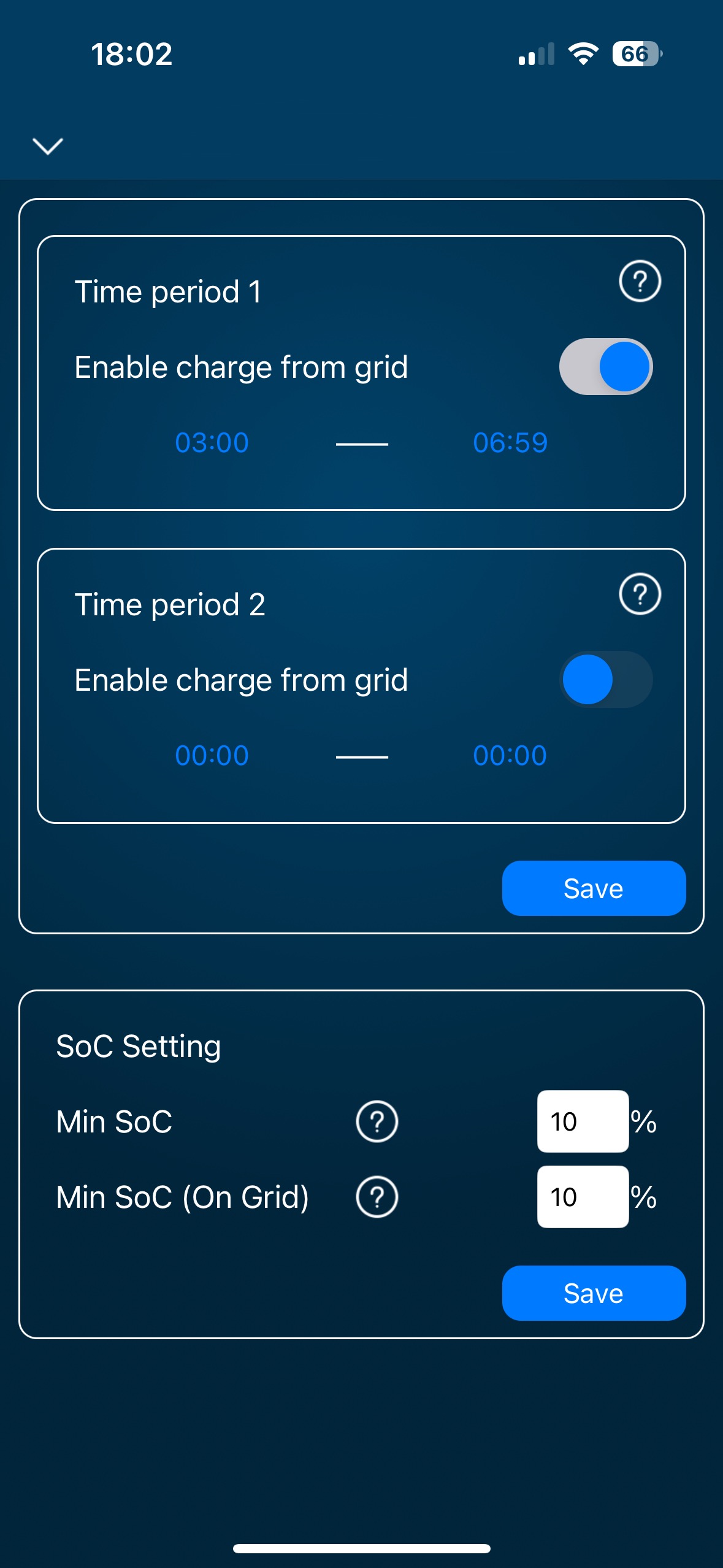

I’ve tried to set up or system to Enable Grid charge only during 3am - 6.59am. But for some reason the battery keeps charging from the grid then discharging on a loop since the PVs stopped generating at end of day (4pm / midwinter).
Here is what I’ve set in the app:
Any idea what I’m doing wrong?

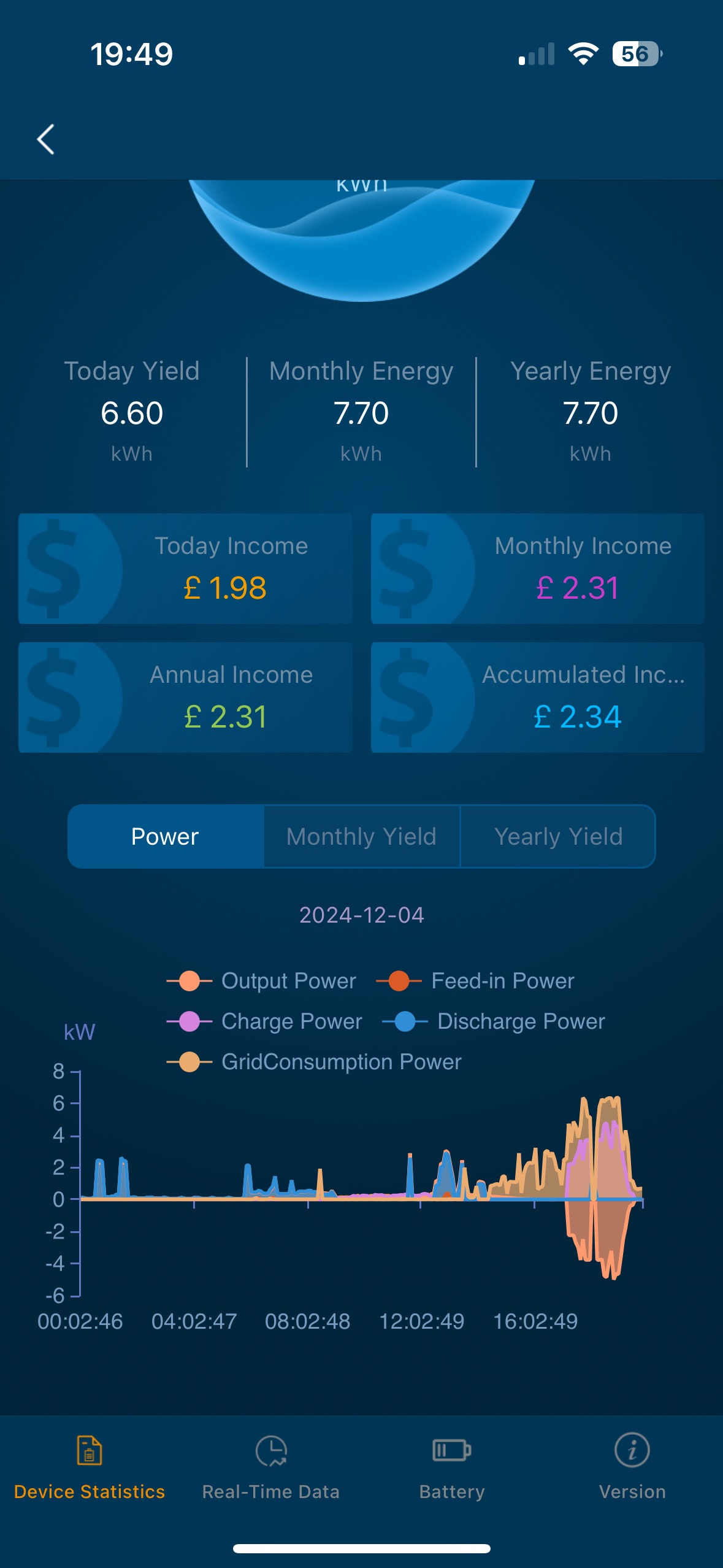

It’s possible your CT clamp has been fitted in the wrong orientation - the CT clamp measures the power flowing in or out of the house and if it is fitted facing the wrong direction you get a similar symptom to what you have just described.
Can you take a screenshot of the graph at the bottom of the Site Overview page and also the graph from the Device page - click ‘device’ tab at the bottom select the inverter and scroll up the page to show the graph that shows output power, feed in, charge, discharge - post them below please

Ok thanks, it’s not the CT clamp all of the traces appear to show the correct polarity - your battery appears to be behaving fine in meeting the load and discharging gradually through the day but there is no sign of it charging at 3am as your charge period suggests, instead starting to charge around 6pm - almost as if your inverter time clock is incorrect ?
If you go to the ‘house’ screen in the V2 app and click on Quick Settings here, does it also confirm your Battery Reserver Capacity (minSoC on grid) and System MinSoc as 10%, the work mode as ‘Self-Use’ and at the bottom Mode Scheduler should be ‘Disabled’ - If you also click on Charging Time do you see your 03:00 - 06:59 charge period with charge from grid enabled. ?

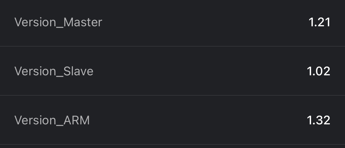

Can you also check the firmware versions - click on the ‘Device’ tab at the bottom, select ‘Inverter’ at the top and just underneath the picture of the inverter you’ll see the serial number - click on that and it will show you Master, Slave and ARM versions - can you post them and i’ll check they are up to date.
Yes all those settings are present and correct. I’ve only set those settings this morning so it wouldn’t have charged last night at 3am. But I just can’t work out why it’s been charging since 5pm today (it discharged briefly at 6pm then carried on charging - it’s now 100% and sitting idle).
Does it just take a while for the settings to register with the system?
Here are the versions:

Your firmware versions are old - the H1 (G2) is quite a new inverter and has seen quite a few updates - it’s now settled down but I would recommend getting those updated, your installer can do it remotely for you (or a request to Fox service with your inverter serial number)
For reference the latest versions are Master 1.29, ARM 1.44
I can’t see anything obvious as to why it has charged up (unless the batteries are very, very cold ~0C) I think the best thing to do now that you have confirmed all the settings is to let it run and monitor it in the morning to see what happens overnight - if it continues, i’d suggest getting your installer back and have him check over all the inverters settings.
