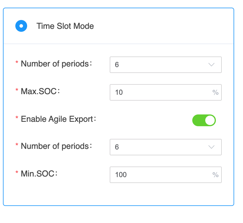

Hi Im trying to check that I set up the correct settings for my timeslot mode for my inverter.
The UI foxesscloud has me a bit confused, i have got Max SOC set to 10% and MinSOC set to 100%. Which sounds almost 100% wrong? But those were the defaults in the UI. Trigger price mode is the same? I have the system charging in the middle of the night so that appears to work?
I would have thought Min SOC would be 10 or 15 % and max SOC 100?
That's backwards you want the minsoc to be 10 and the max to be 100%
Ok ill change them, probably be good to change the defaults for UI then.
Yeh does look like a UI bug
