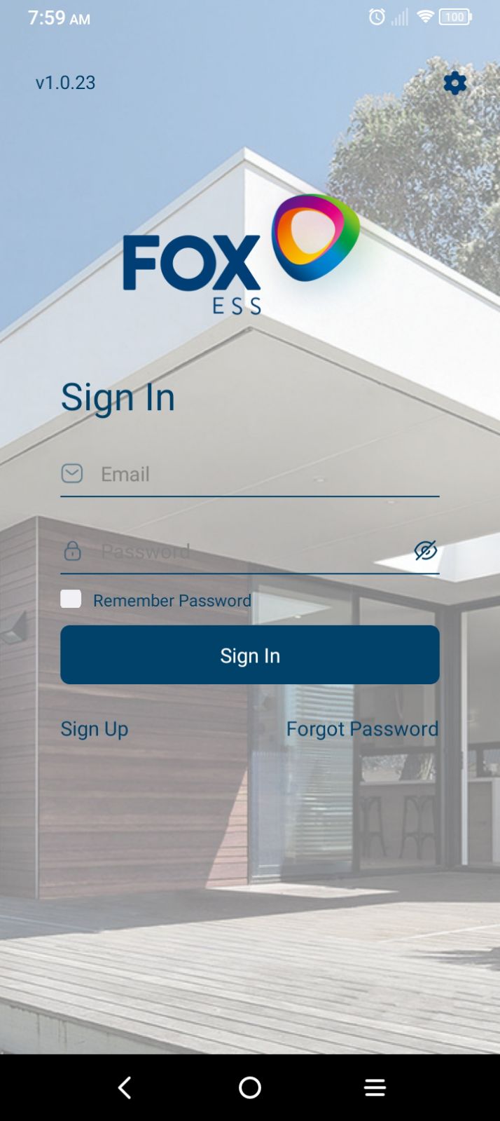

What does your app home screen look like in the fox 2 app? can you upload a screenshot?

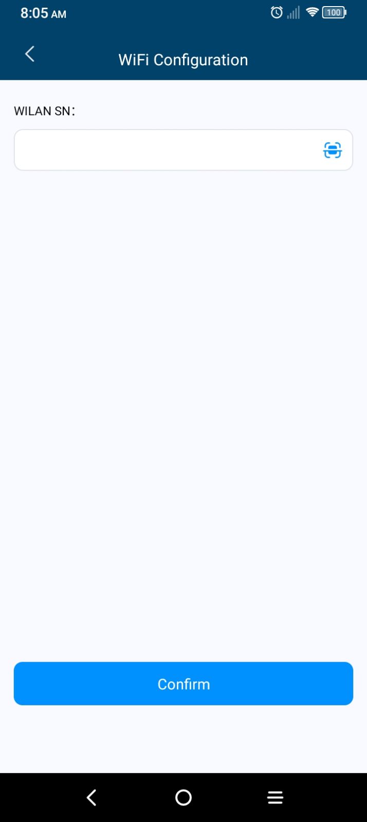

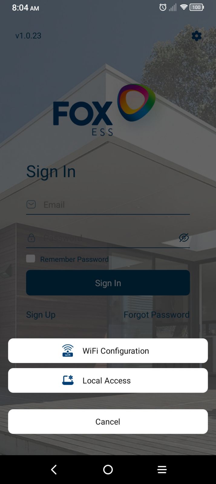

Thank you for the response to my inquiry. On the App Home Screen, I open 'settings', then I open 'WiFi Configuration', then in the 'WILAN SN:' field I enter the number on the wifi dongle and nothing happens. I have the dongle inserted in the G2 Hub and not the inverter. I haven't done anything to the inverter. Do I set up monitoring as an installer or enduser?
