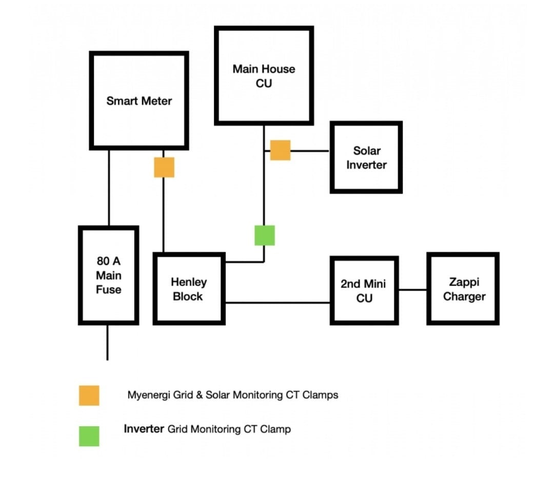

i've attached a schematic which shows this, hope it helps.

Yes it is the addition of the Henley block that splits the two feeds, the CT clamps would already be fitted but because the inverter is seeing the load from the Zappi as house load it will discharge the battery.Digger wrote: Fri Oct 11, 2024 3:05 pm I have the same problem with an Octopus installed Zappi and wonder if either the 2 extra CT clamps or Henley Block solved the above? It would be good to know before I engage Octopus Customer support.

If you add a Henley block to the live tail from your smart meter and split it so the house load and inverter is on one side, and the Zappi on the other (as per that diagram), your inverter will no longer see the Zappi as load.
