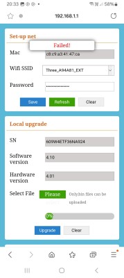

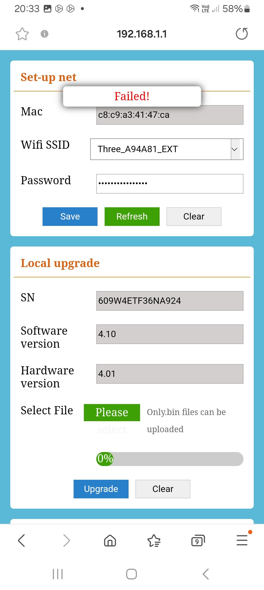

Hi Dave
I have managed to get the inverter and data logger onto my cloud 2 app first go today. I have tried loads of times to get the WiFi on line with no luck it initializes ok but fails to save. I have tried on a laptop with Google chrome and Microsoft. The inverter is in a building 30mts from my house so I have installed a tp link external wifi ariel which is only 2.4g. I have checked all the passwords and they are OK.

- Posts: 1241
Hmmmm, confusing.
So just a couple of thoughts - have you tried connecting your phone direct to the extenders wifi to prove it can accept a connection and give internet access
and the only other thought would be to simplify the name of your wifi extender and remove the '_' characters - i've never tried it with anything other than normal alpha characters and whilst it's clutching at straws it might be worth trying it to discount it.
If that doesn't work I would suggest you email Fox service and see if they can suggest anything, as failing that it might need a new datalogger.
