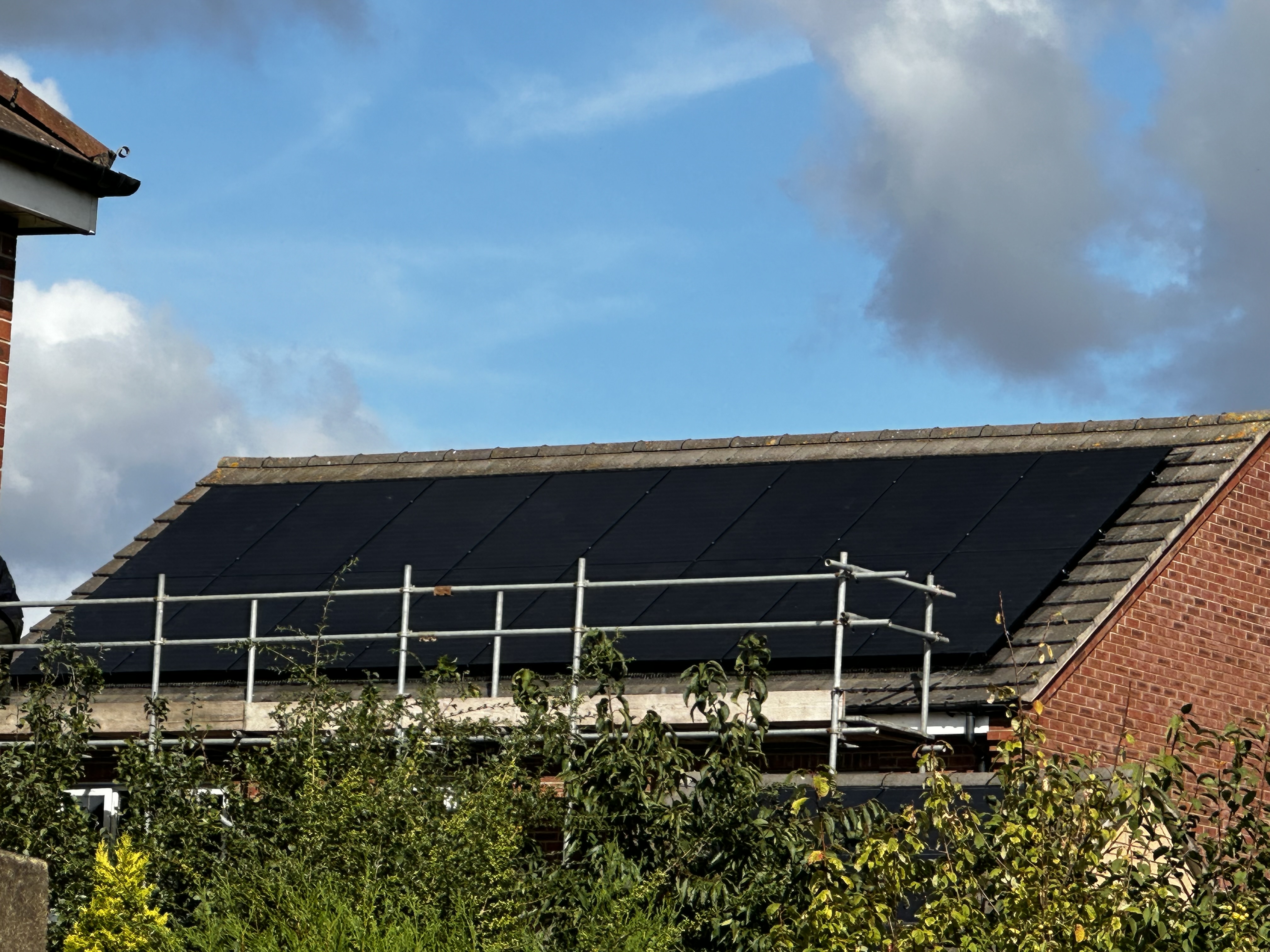

Had my system installed a little of 3 weeks ago!
16 x 435W Perlight Panels (6.96 kWp)
6 kW H1 Inverter
12 kWh Energy Cubes

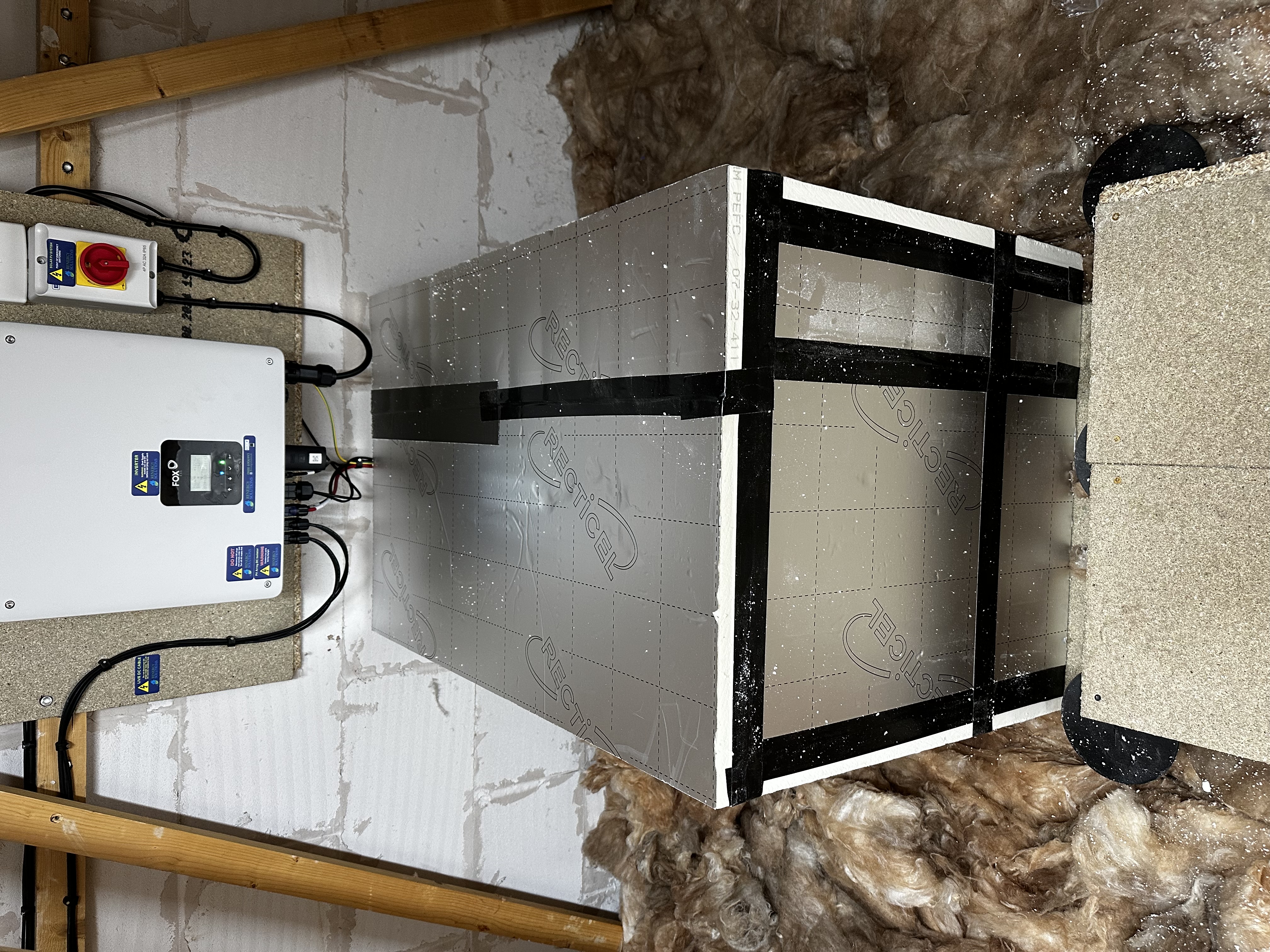

I also want to monitor the temperature of the batteries. I was a little worried about the temperature fluctuations since its installed in the loft. But will monitor and come up with solutions are the need arises.

In the loft temperature may be a problem in the very cold spells where you have several days below zero - typically the batteries restrict the charge current as they get cold, and it's all over below zero - although they will continue to discharge.
What many people have done where it is a problem, is to build a Kingspan (recticell etc..) battery enclosure with 50mm insulation boards leaving an airgap around them for air to circulate - looking at your install it should be quite straight forward.

I'll monitor the temperatures and see how things go. I already have some zigbee thermometers up there to measure the ambient temperature. As you say should be easy enough to insulate with a small enclosure! I've already seen the charge being throttled when it was cold but very sunny.

Already seeing battery charge being throttled due to temperature of the batteries. Was quite cold last night. Ambient temperature in the loft was 3oC and the battery is only charging at 1.1kW, with a temperature of 15oC.
Think I'm going to pop down to B&Q this weekend and see what I can cobble together! I've seen a few example now on the facebook group, should be easy enough, even with my limited DIY skillset!
Re: Hello from the East Midlands!
Built a small enclosure as recommended. Already noticing the battery temperature is more stable this morning after another cold night.
Temperature inside the enclosure is currently about 9oC more than the ambient loft temperature! Battery has stayed above 20 all night too!

Nice neat install and love the insulated box to keep them at a stable temp.

adamlc wrote: Sun Oct 13, 2024 11:58 am Built a small enclosure as recommended. Already noticing the battery temperature is more stable this morning after another cold night.
I'm going to copy this :D How much space did you leave around the battery for airflow?

I think officially it's supposed to be 30cm.
Realistically I think mine is about 20-25cm either side and about 40 on top. Although thats a pure guess!
I have zigbee temperature monitors and use home assistant, so I am keeping a close eye on all the stats to ensure it doesn't get too warm.
Its quite cold today, currently -1 outside, 6 in the loft and 11 inside the box. So it does help a bit!
Ideally I would like to ensure its sealed where it meets the wall and floor a bit better. But it better than nothing for now!
