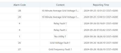

My inverter H3 5.0e does not invert anymore. I have disconnected it to reset, even had it out for a couple of hours, but it does not come back. It is currently 'stuck' in a loop: 60s checking, restarting, 60s checking, restarting,...
This occured after two grid voltage spikes in the afternoon on wednesday, and giving a relay fault in the night.
Unfortunately my installer went bankrupt, so I am at loss what to do now. Any ideas?

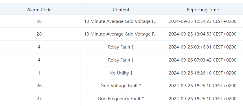

No I don't think it's dead, it is reporting a grid voltage fault (too high) and also a relay fault.

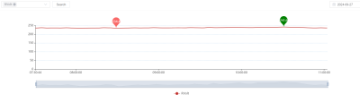

Probably a good start is to go to the Foxcloud website, look at the inverter details page and in the graph at the bottom select 'RVolt' - that will show what your grid voltage is over time and highlight the highs and the lows - if you can post that, I can make some suggestions.

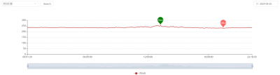

The RVOLT spiked on 25th, but has not spiked again:

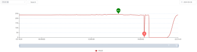

I followed the manual and disconnected the unit on 26th. First a few minutes, then for half an hour. Unfortunately it did not fix it, and does not invert anymore: I did not touch it today: It keeps being stuck in the loop: 60s checking, restarting, 60s checking, restarting,... No production either today... I'm in Belgium without local Fox service, but will contact them in the Netherlands.

Ok, your voltage looks good and is in-line with what you would expect so I think the relay fault (an internal error) is causing this - I know that Fox can remotely diagnose and have implemented fixes for this fault remotely - so will wait for Fox support to get back to you.
