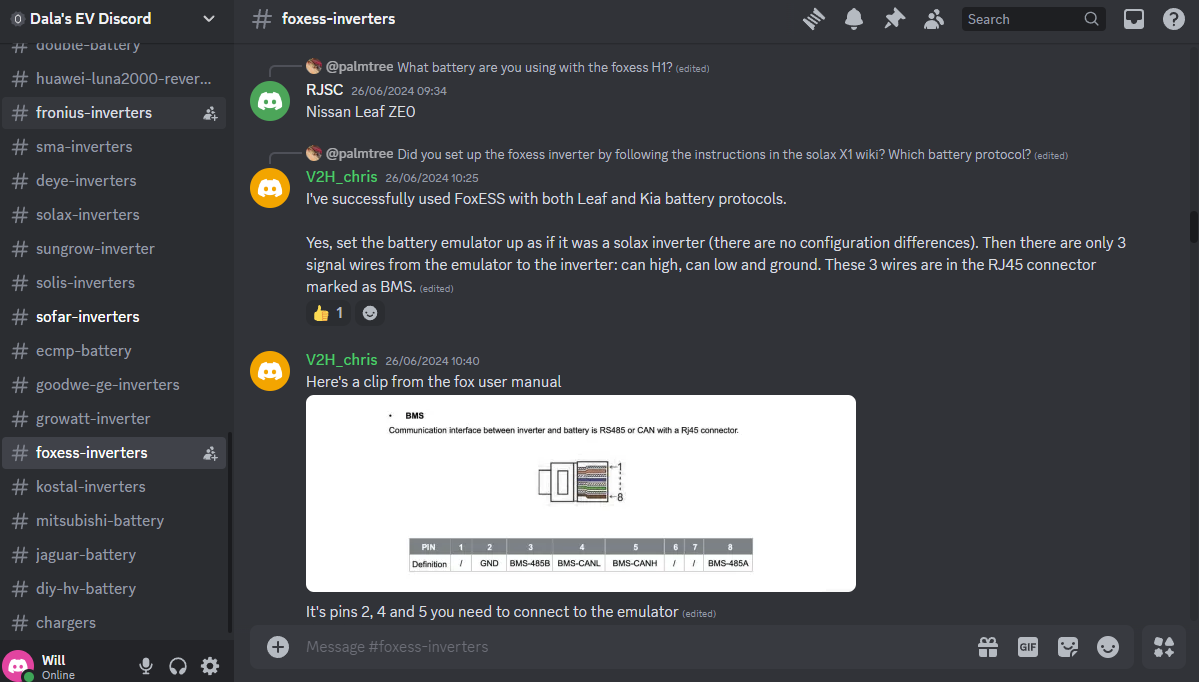

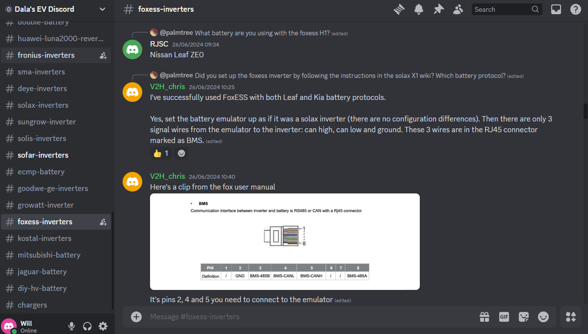

Sharing for general awareness for people looking to use thrid part ev batteries with their fox inverter for advanced users only.
While watching a video by Cory Mac on his channel https://www.youtube.com/@corymac I noticed that while quoting a good source of canbus information from a discord server called Dala's EV I spotted Foxess-Inverter channel.
So I signed up to Dala's Patreon to access the discord server https://www.patreon.com/dala/posts and noticed a number of people had successfully got a fox inverter working with generic and EV batteries by using a BMS emulator.
Video in question
