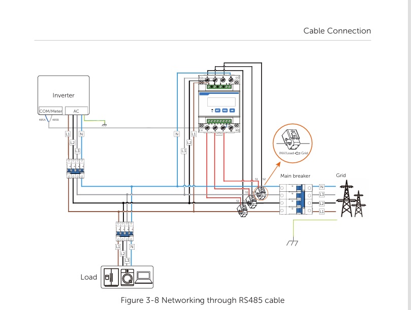

Yes you can use the Chint DTSU666 (-CT) which comes with 3 CT clamps
This for a Solax inverter (essentially the same thing)

It's the location of the meter in wiring diagrams that has been confusing me as it appears it has to be connected at the origin which clearly it doesn't necessarily have to be.
The property is a new build so is not part of FiT fortunately, we also have a ducting which runs from the garage to the house which already has a duct grade CAT 5 in it, this is currently used to hardwire a WiFi extender but we will be installing an external WiFi access point and using the CAT 5 for our CT clamps, we believe the total distance from meter to CT location to be 7-8 metres. We spent 2-3 hours attempting to fish an additional CAT 6 through the ducting but were unable to do so.

A standard solution (out of the manual) would recommend you fit a Chint meter at the source as you say as it is wired in pass through for all phases - but if you use the Chint meter with CT's you can break that link and fit remotely.
The meter 'hard wired' is more accurate than CT's ( which are typically +/- 2% accurate depending on load power ) but other than that it's a good solution.
