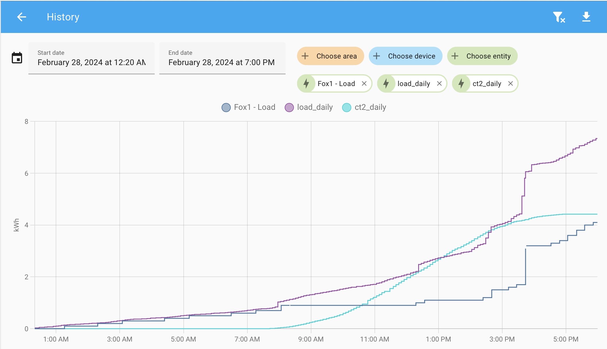

You’ve had better weather than me today, grey and overcast here
This is your trace to date, which confirms what you have said - Fox1 Load is their cloud totals (wrong), load_daily is the sum of your measured load power (correct), and ct2_daily the sum of the CT2 power sensor.
I’ve emailed FoxESS in China to ask them to review the load totals problem, it usually takes a couple of days for them to reply, sometimes longer if it’s complex when lots of different teams are involved, i’ll keep my fingers crossed and let you know when I hear something.

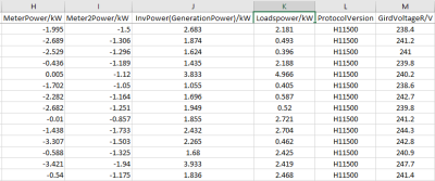

Basically I have got nowhere with this. I raised another ticket recently when the data download failed on the v2.0 app - explaining I need access to this data to get the correct daily load for the reasons highlighted in this thread. It seems impossible to get Fox to understand and sort this. I've sent them graphs, data, explanations but they seemingly just don't get it nor see it as a priority.
The infuriating thing is the correct data is there in the inverter logs (Loadspower/kW):
So as it stands, I have to download this data daily and work out the correct load from that - as long as the v2.0 app downloads work of course!

Well, after waiting so long for a fix and not getting one I finally bit the bullet and got the modbus wired up using an Elfin EW11A and home assistant running on a SFF Dell PC. It's working well and I've managed to set up a dashboard with most of what I want. There's a few things I would like to do with it but have no idea how.
- I've managed to set up a meter to count up the daily total of CT2, so I now have the daily PV generation of both inverters. I'd like to have a sensor with both totals merged and also a "live" combined value with an eye on uploading it to PVoutput somehow. I have the following code in the template editor which does work as intended:
Unsurprisingly there's also the load power issue, I'm getting a negative load power as expected. You mention I can correct for this in home assistant to give the correct live value and therefore daily total. How would I go about that?
Cheers
(Edited as the load power daily total isn't counting down now, it was just an initial setup issue)

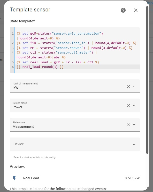

Ok this should be it, some of the sensors required may not be enabled by default in the integration - if they are not enabled you can enable them by going into HA Settings, Devices & Services and click '1 Device' on the Foxess Modbus integration - it will list all available sensors, and at the bottom it will says +xx entities not shown - click there and you can then click on each entity and slide 'enabled' to on and they will be added.
To do this you must have Grid Consumption ('grid_consumption') , Inverter Power ('rpower') , Feed-in ('feed_in'), CT2 Meter (ct2_meter) all available and showing in the list
As you've seen the inverter reports the wrong load power when your CT2 is generating, that's why the cloud totals get messed up - it can be fixed by applying this logic
Real Load = Grid Consumption + Inverter Power - Feed In + absolute(CT2 )
So we need to create a sensor for that which will report real time power (kW), then we need an integral sensor which will give you an increasing sum of kWh and finally a utility meter that resets on a daily basis and will show what you daily load looks like.
Rather than add them in your configuration file, it will be easier if you use the 'helpers' as you can sensors via the GUI which is much easier if you aren't familiar with yaml.
I can see you have named your inverter as 'h1_5_0_e' which adds that name to all sensor prefix's
So for the first sensor, click Settings, Devices & Services, then Helpers (top right) - then click the blue button 'Create Helper' and select 'Template' from the list, then select 'Template a Sensor'
The name will be 'Real Load'
in the State Template copy and paste the code below
Unit of Measurement : kW
Device Class : Power
State Class : Measurement
(Leave the Device field blank)
It should look like this (albeit my inverter doesnt have your h1_5_0_e prefix)
Click the 'Submit' button when done.
{% set gcR=states("sensor.h1_5_0_e_grid_consumption") |round(4,default=0) %}
{% set fiR = states("sensor.h1_5_0_e_feed_in") | round(4,default=0) %}
{% set rP = states("sensor.h1_5_0_e_rpower") | round(4,default=0) %}
{% set ct2 = states("sensor.h1_5_0_e_ct2_meter") | round(4,default=0)|abs %}
{% set real_load = gcR + rP - fiR + ct2 %}
{{ real_load|round(3) }}
