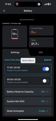

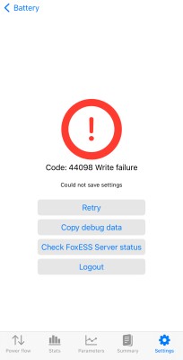

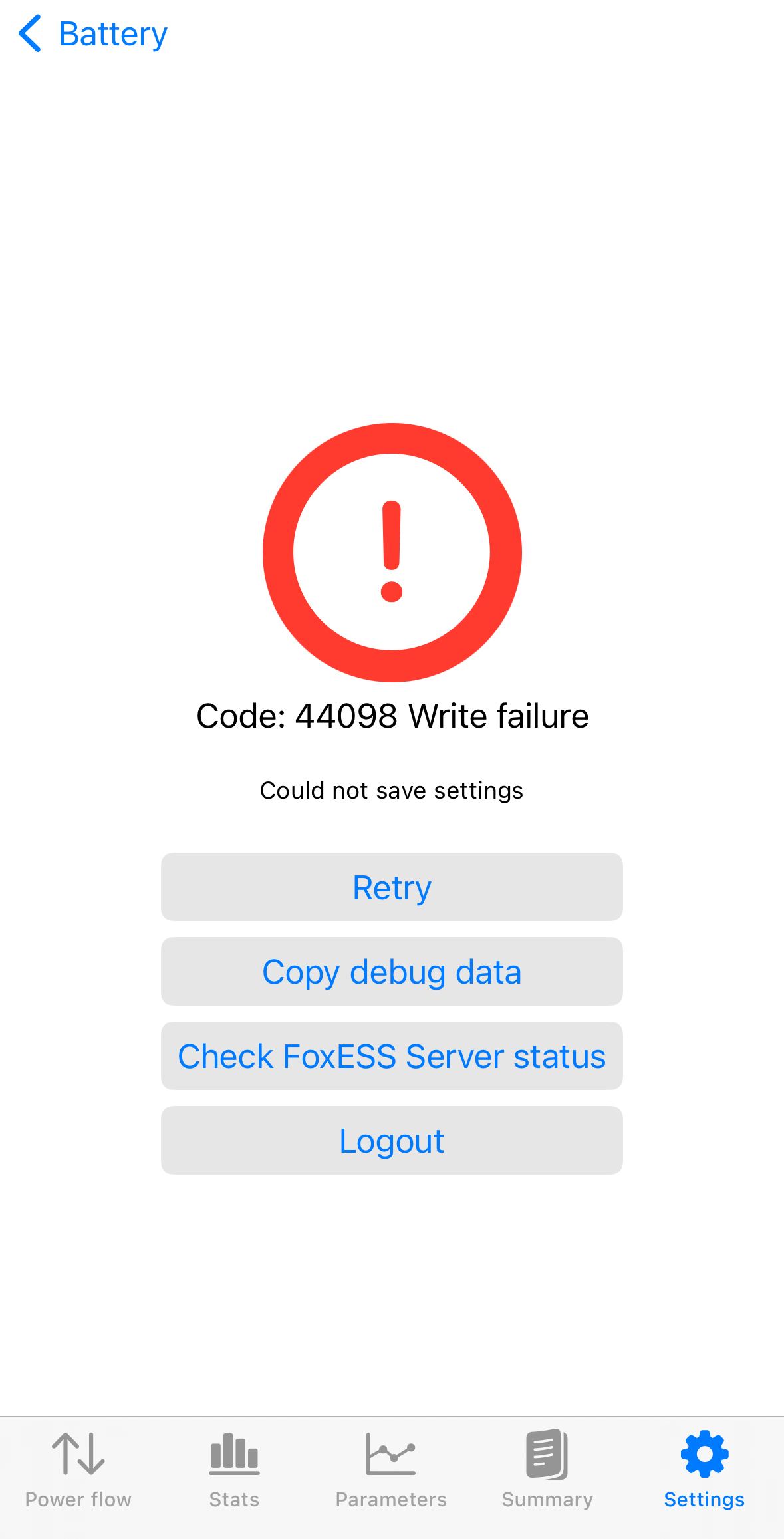

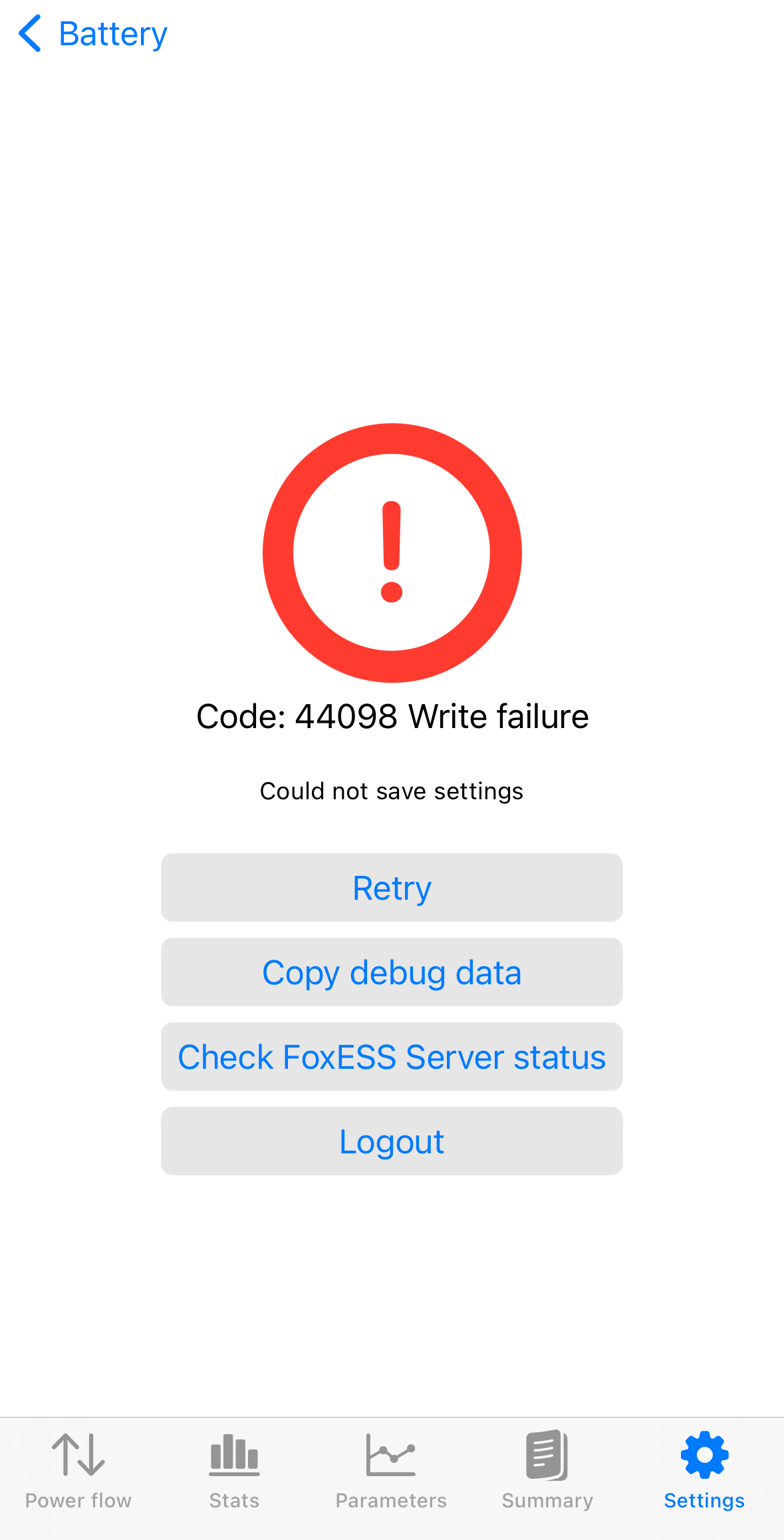

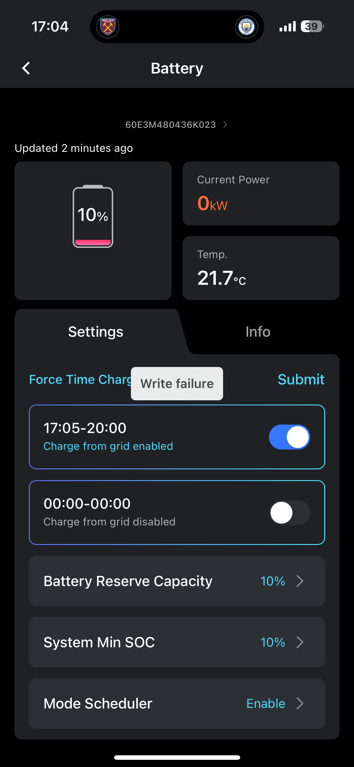

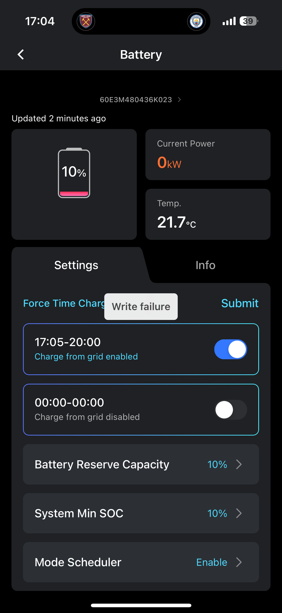

Hello. I keep seeing ‘write failure’ whenever I try and schedule a charge on my battery (see second attachment). I also have the energy stats app. When I try it from there it shows a ‘44098 write failure’ (see first attachment).

You have mode scheduler enabled, you can’t run the older charge periods at the same time as scheduler - if you disable the scheduler, charge periods will work again.
Alternatively if you are using scheduler, set a force charge schedule instead of using charge periods.
