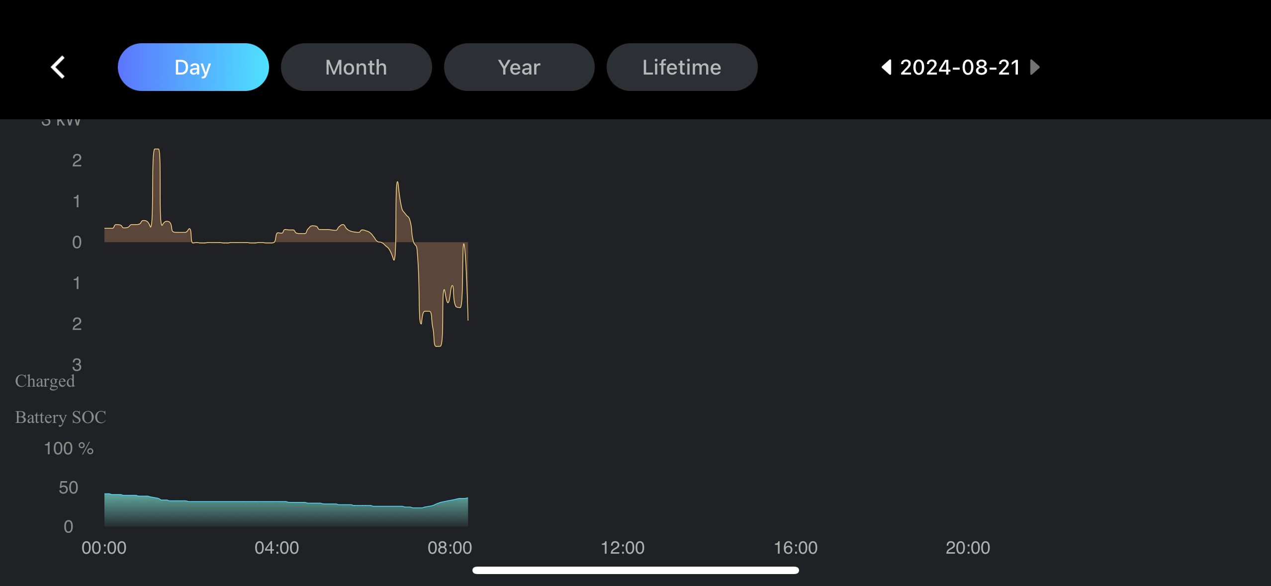

I tried to charge my batteries overnight for the first time last night, but it didn’t seem to work.
I set it to charge from 2-4 am. I can see from
the graph that the battery did stop discharging during that period (it just flatlines, and I appear to have switched to the grid) but the battery itself didn’t charge.
Any advice welcome! No doubt it’s user error on my part. Many thanks.

Nice system :)
If it stopped discharging, it looks like you set a charge period but didn't toggle the charge from grid switch on.
I'm assuming you are using the older (simpler) charge periods - I would leave scheduler for another day, there are so many things that can go wrong with that.
So basically set a charge period from 02:00-04:00 but make sure you have 'Enable Charge from Grid' turned on.
You would normally have your minsoc's set at 10%
You can set it for just a few minutes to give it a quick test charge and prove it's working ok.
