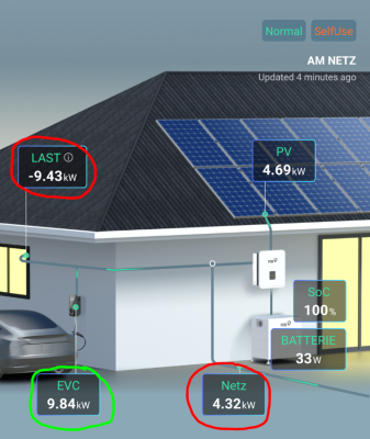

A very high negative House-Load and a positive Feed-In shown instead of Consumption - only when EV Charger / Wallbox is used.

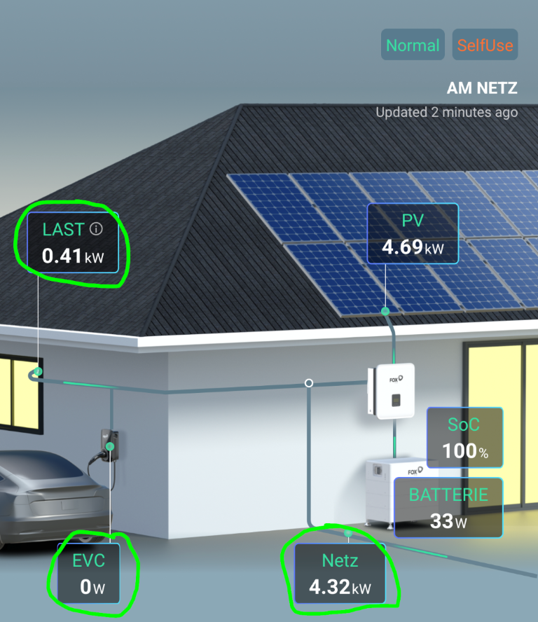

When not charging the car, the system shows reasonable figures:
When charging the car, the system shows a very high negative load on the house, and it keeps showing Feed-In, even though I actually consume a lot from the Grid then:

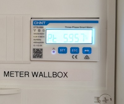

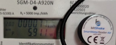

Photo of the GRID Meter (provided by the Electricity Company) showing that I actually consume energy from GRID
Photo of the first Meter (after which the Wallbox is installed) showing the same consumption as the GRID Meter

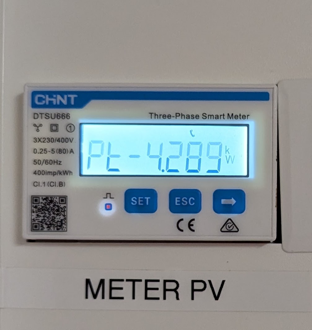

Photo of the second Meter (after which the Inverter is installed) showing the Power which the Inverter provides (and think's it is Feed-In) ??

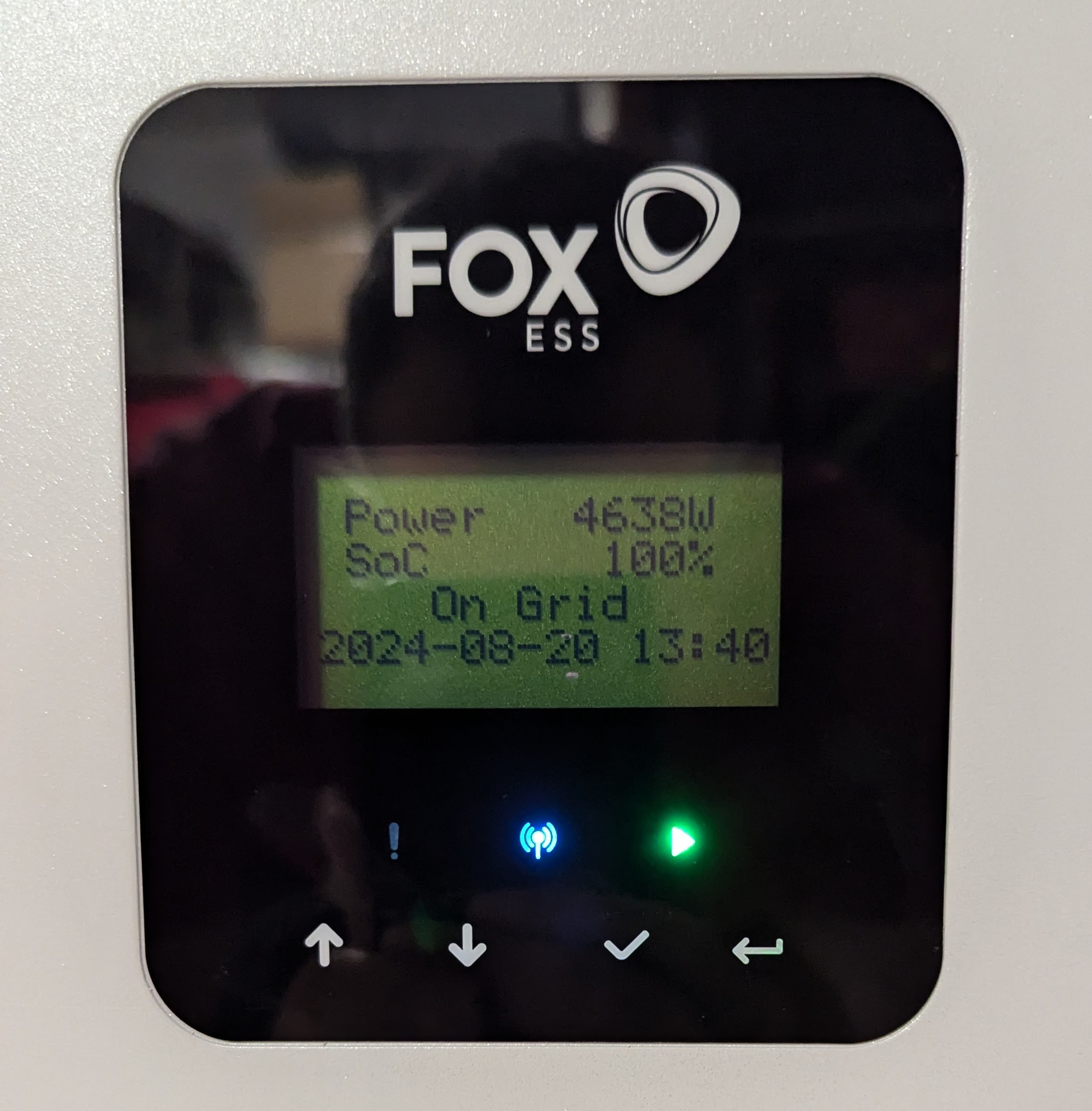

Photo of the Inverter Power display:

Also, I think when I switch to EPS power, off Grid, the (second) Pv Meter gets fed by the EPS power and provides data to the Inverter.
Shouldn't in an EPS case, the PV SmartMeter be off and not send any data to the Inverter?

From what you have said, it is correctly wired - you would normally have the EV connection (wallbox) in front of the inverter's meter so that the inverter doesn't see the load from it. The wallbox would then have it's own meter between that and the grid meter so it all looks correct.
The meter's themselves are showing what you expect with the inverter exporting it's surplus and the grid meter showing 5.9kw when the wallbox is taking nearly 10 so the net would be 9.8-5.9 = which is approx the excess solar generation.
I've never come across the wallbox in the app before but as the inverter meter cannot see it, it must be being added in the cloud with the inverter and wallbox both being in the same account.
The inverter is working correctly and exporting it's excess after covering the house load - there is no exceptional load on the batteries - so the EV charge point is correctly in front of it, so all in all this looks to be simply an app display issue.

Negative Load display
Yes I agree, from the device sequence it seems alright in the normal onGrid operation mode.
it looks really like a display issue.
