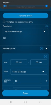

Did you manage to have the Force Discharge Function on your system?
Mine is
Master: 1.63
Slave: 1.02
Manager: 1.68
but the Force Discharge template is not showing up.

Manager 1.68 provided schedules, but if you want force discharge you need Manager 1.70
raise a ticket or send an email to FoxESS support and ask for your inverter Manager to be upgraded to 1.70 (the rest of your module versions are upto date and correct)
