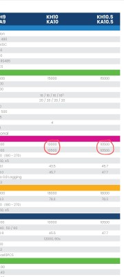

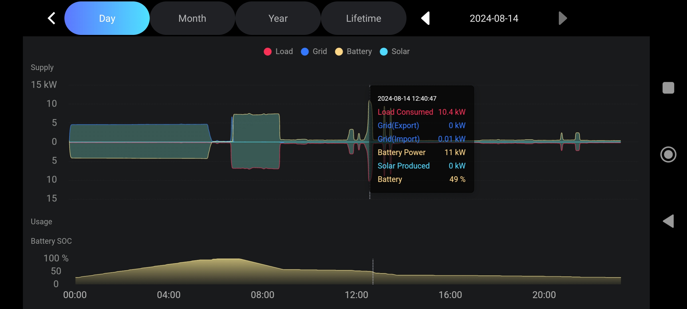

Does the kh10.5 have a higher max power output than it's nominal rating like what you can see on the kh10 stats but it's just not been properly documented as I had a period where the battery was delivering 11Kw today for a short period.

The 10.5 kWh is it’s maximum AC rating it won’t deliver more than this as export, but it does have a short over burst to cover a few hundred watts of house load - you are also looking at the batteries (DC) and so you will see 2 or 3 hundred watts extra there because of conversion losses.
