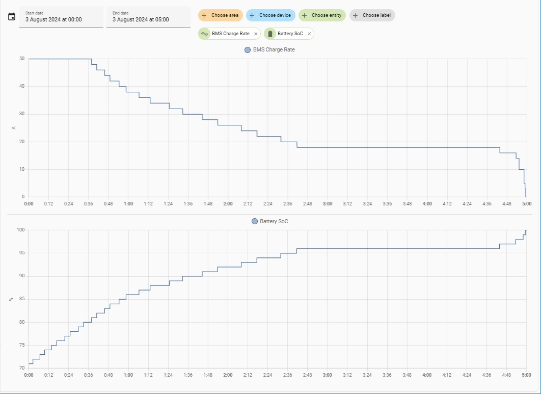

The detailed settings are showing what the BMS is allowing the maximum to be set to - this changes with state of charge and temperature.
But if you have set a maximum DC charge current in the inverter settings then it will not be able to charge any higher than that irrespective of what the BMS would allow.
If you have 7 EQ4800 batteries, the battery voltage will range anywhere between 284V and 361V (10%-100% SoC)
Power = Volts * Amps so with 32A charge current you will have a charge current range of between 284V*32A = 9,088W and 361V*32A = 11.552W
But as already mentioned the BMS will start to very gradually reduce the charge rate above 80% SoC (see attached) so your maximum charge rate will be where it crosses on that graph - on your battery stack that will occur around 350V hence in practice 11.2kW is the maximum you will see which will be capped at 10.5kW as that is the maximum your inverter can handle.
If you want to limit your battery charge to (say) 6kW then set the charge current to 18A which will give you a charge rate of between 5.1 and 6.1kW as the battery charges.
