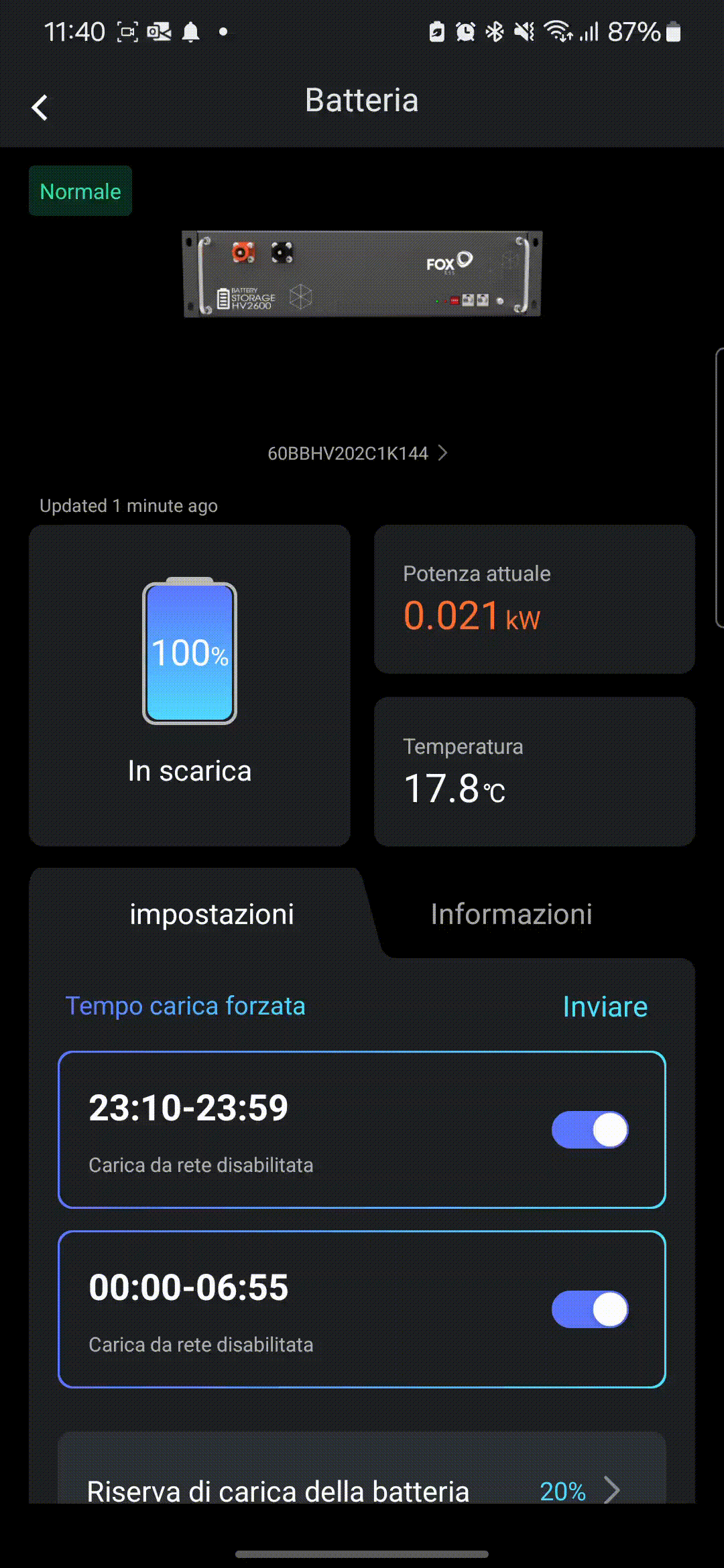

I have the same problem as you mentioned. And I set up the Charge from grid setting for the battery. As soon as the time of charging arrive, my house is disconnected from the grid because it goes over-consuming. I have a contract for 4.5 KW and I assume the battery will try to charge with an higher power... Is there a way I can limit the power being taken from the grid?
Thanx
Posts: 1305
colui77 wrote: Thu Jul 11, 2024 12:31 am Dears,
Thanx
Yes there is a way, buy it can only be done from the inverter menu (unless you have agent access to the cloud) - the item you are looking for is called 'Max Chg Cur' under Settings, Battery - this is the maximum dc charge current the inverter will use to charge the batteries - the default is usually 35A (the maximum it can charge at).
To work out how much power that is, you need to know you battery voltage which you can see in the Inverter menu in 'System, Battery' - If you want to limit the charge to 3kW then divide 3000W by the battery volts and it will give you the current, i.e. a typical battery volts of 220V would be 3000/220 = 13.63A - so round it up and set it to 14A.
