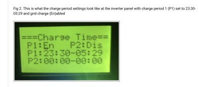

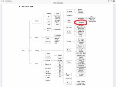

EDIT: For information (i've just checked mine and it times out as well), if that doesn't fix it and you have access to the inverter panel itself, you can change the charge times via Settings, i've attached a system menu screen shot which shows where to find Charge Times. ('Settings', 'Work Mode', 'Charge Time')
And also what the screen looks like to change the times
