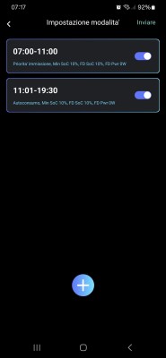

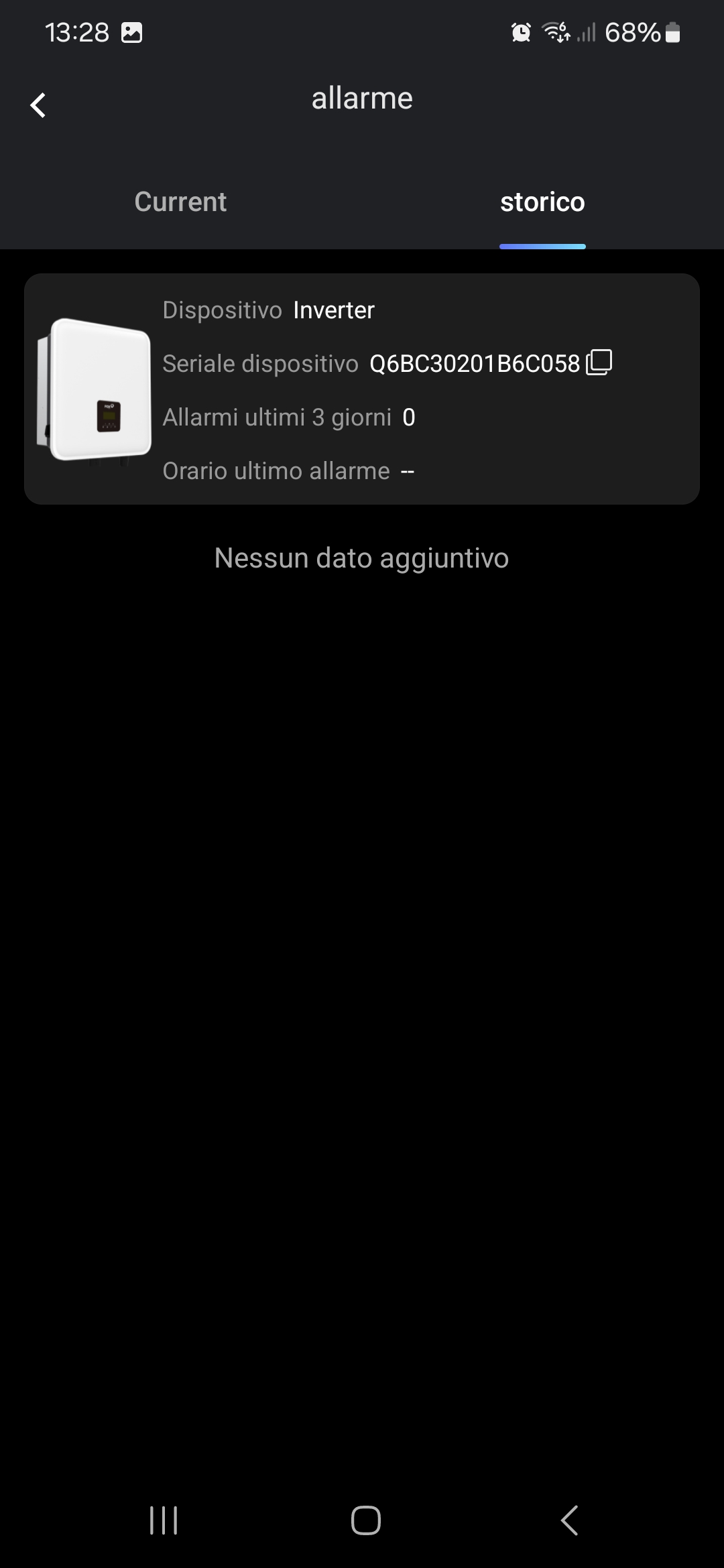

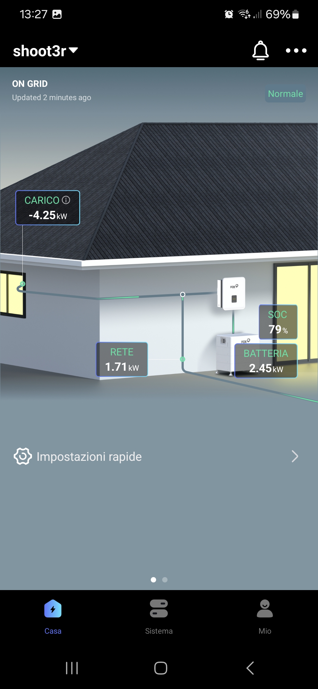

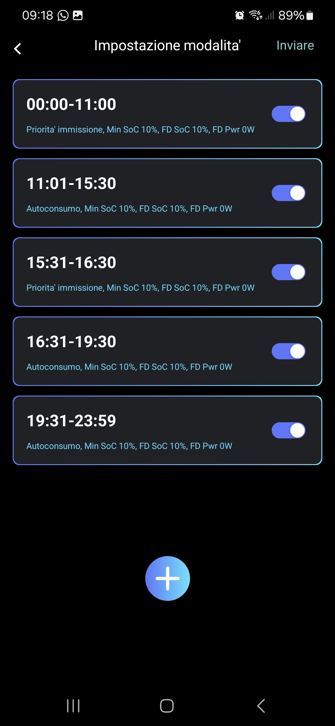

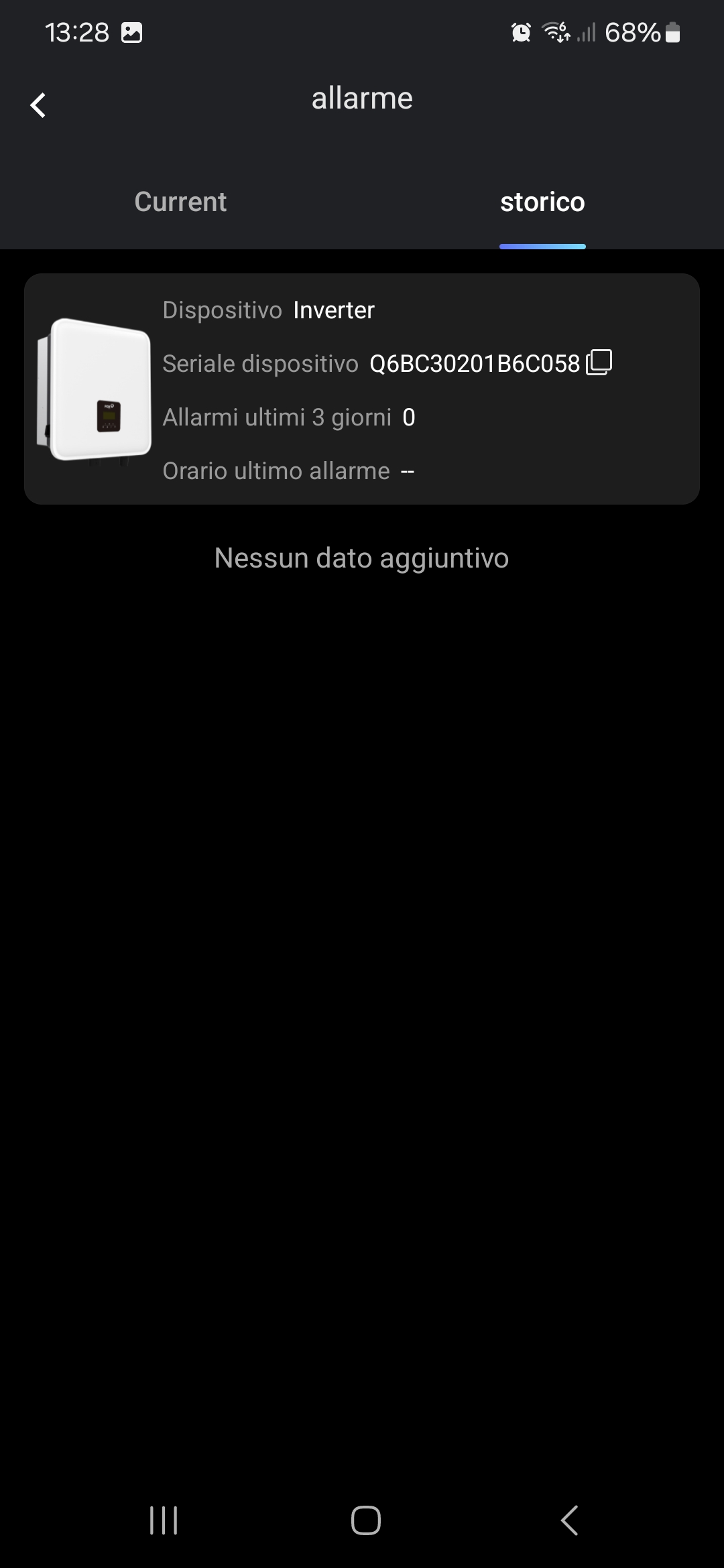

then with the planning it works really well. I detect 0 errors and neither the Solaredge nor the Fox Ess inverter seems to have ever been disconnected. I just have to start understanding how long it takes more or less for the batteries to charge so as to adjust the interval and if I want I can try setting the charge to 8a so when there are peaks the input (during the program) will work well without interrupting

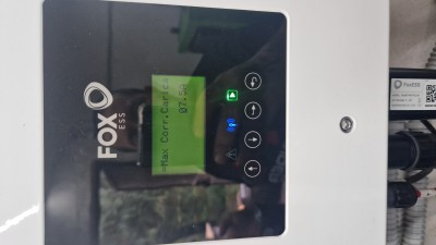

what you mentioned would be really fantastic and I'm very interested as soon as I finish some work I will do it. If you want obviously when you can could you explain it to me? I would like to do it. Another thing is that I charge it at 7.5a, maybe I have to lower it because it charged the batteries in 3 hours and 30 minutes. I'll try to bring it to at least 7a precisely. However, I'm very curious about that really interesting project. If you like, you have carte blanche

good morning, thanks Dave it's very interesting. thanks to your advice and the programming of the work mode based on the time slots you have opened up a world to me and solved many problems. I must say that since our last massage I have had no problems and I am also able to optimize consumption, battery recharges and everything else really efficiently and 0 errors in the evening or inverter interruptions. It's fantastic and only thanks to you and your support/patience I managed it. As soon as I can I'll check the links you put up and I'll see. But already like this I can take advantage of everything 90/100%. Thank you very much

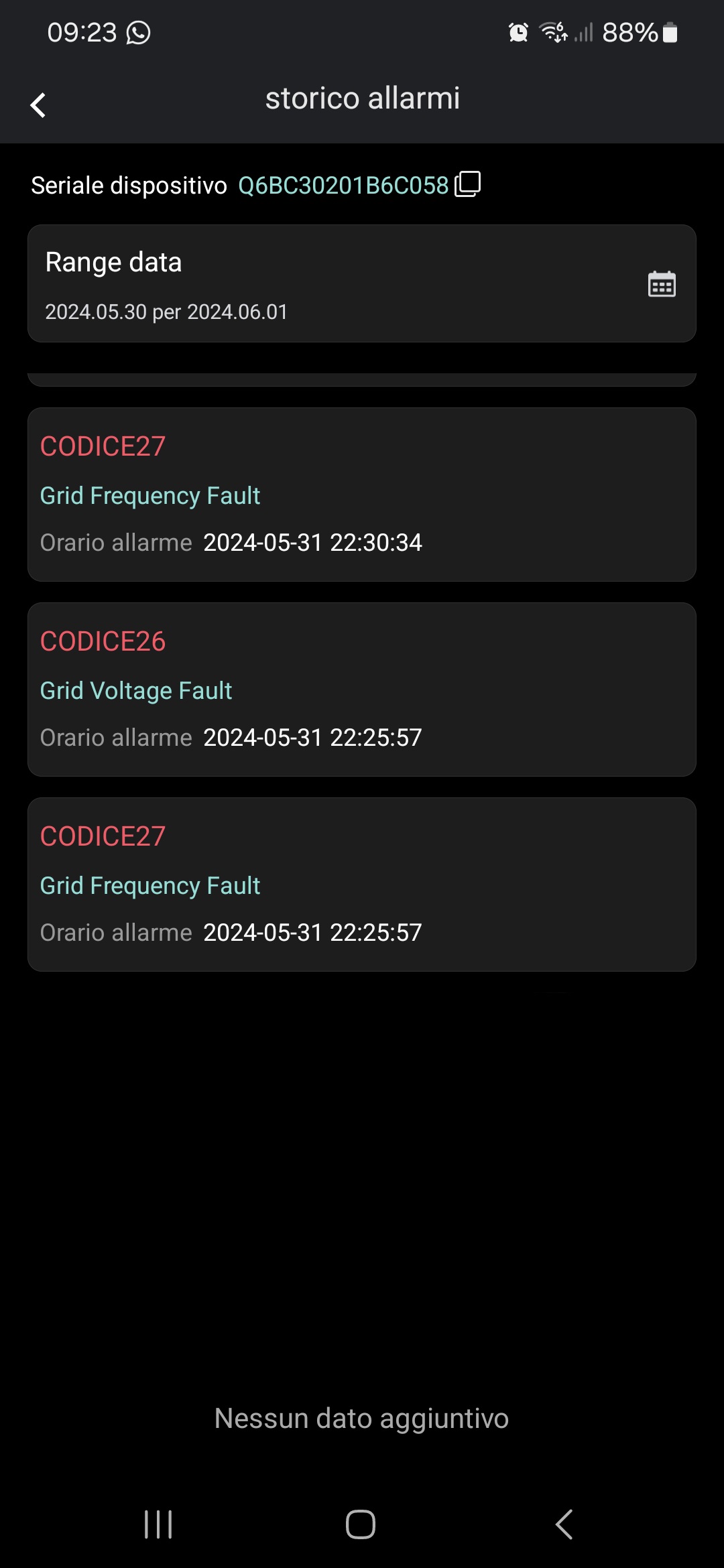

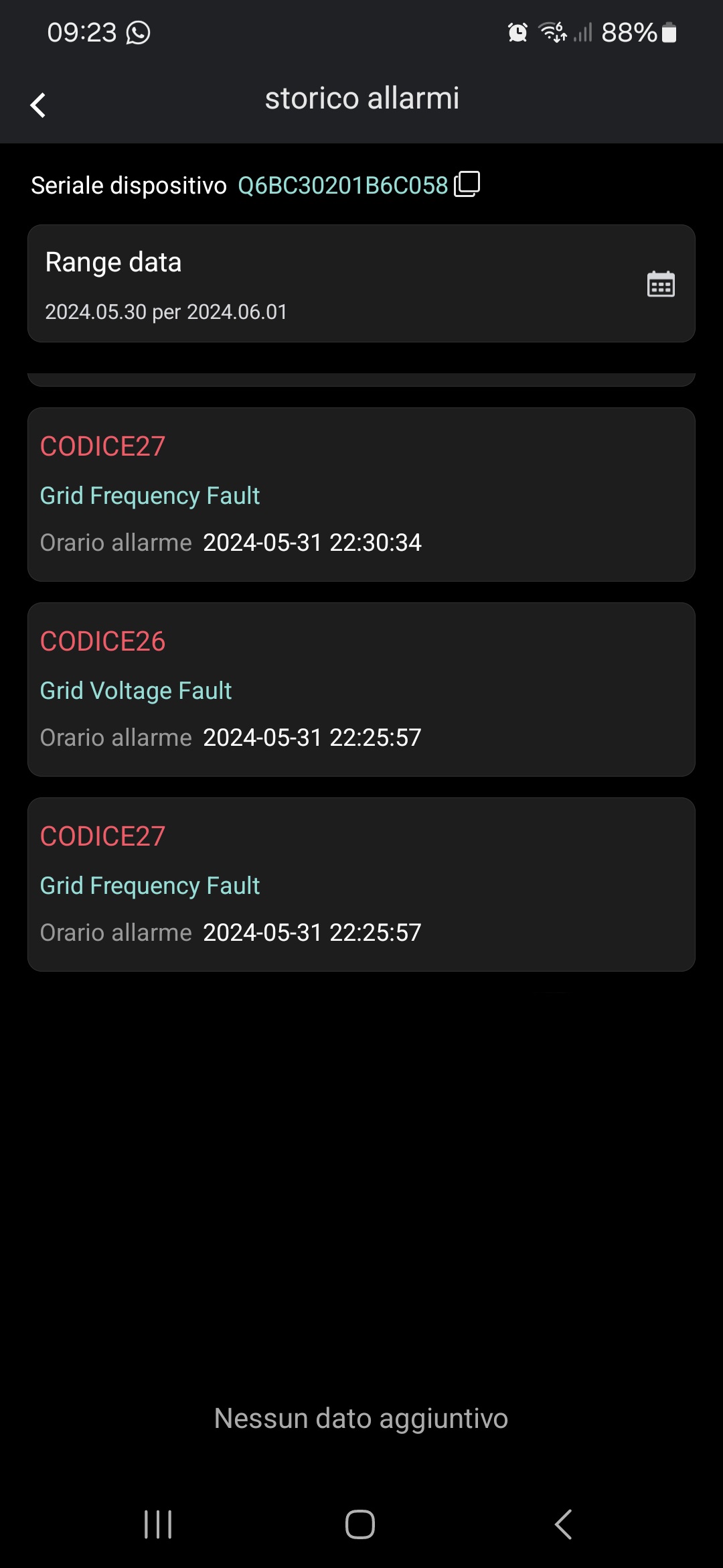

P.s The only errors are from last night but there was a blackout in my area
