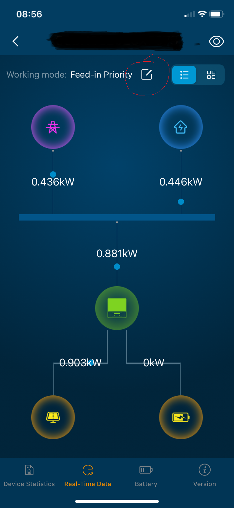

Can anyone help me setup my first Battery Forced Discharge. I can't find the option on the phone app! Am I looking in the wrong place?

The first thing to say is that you have to have Manager firmware 1.70 or later to do this - so just to double check that.
You can get at it in the app, but it's quite clunky, I prefer to use the Foxesscloud wesbite to do this.

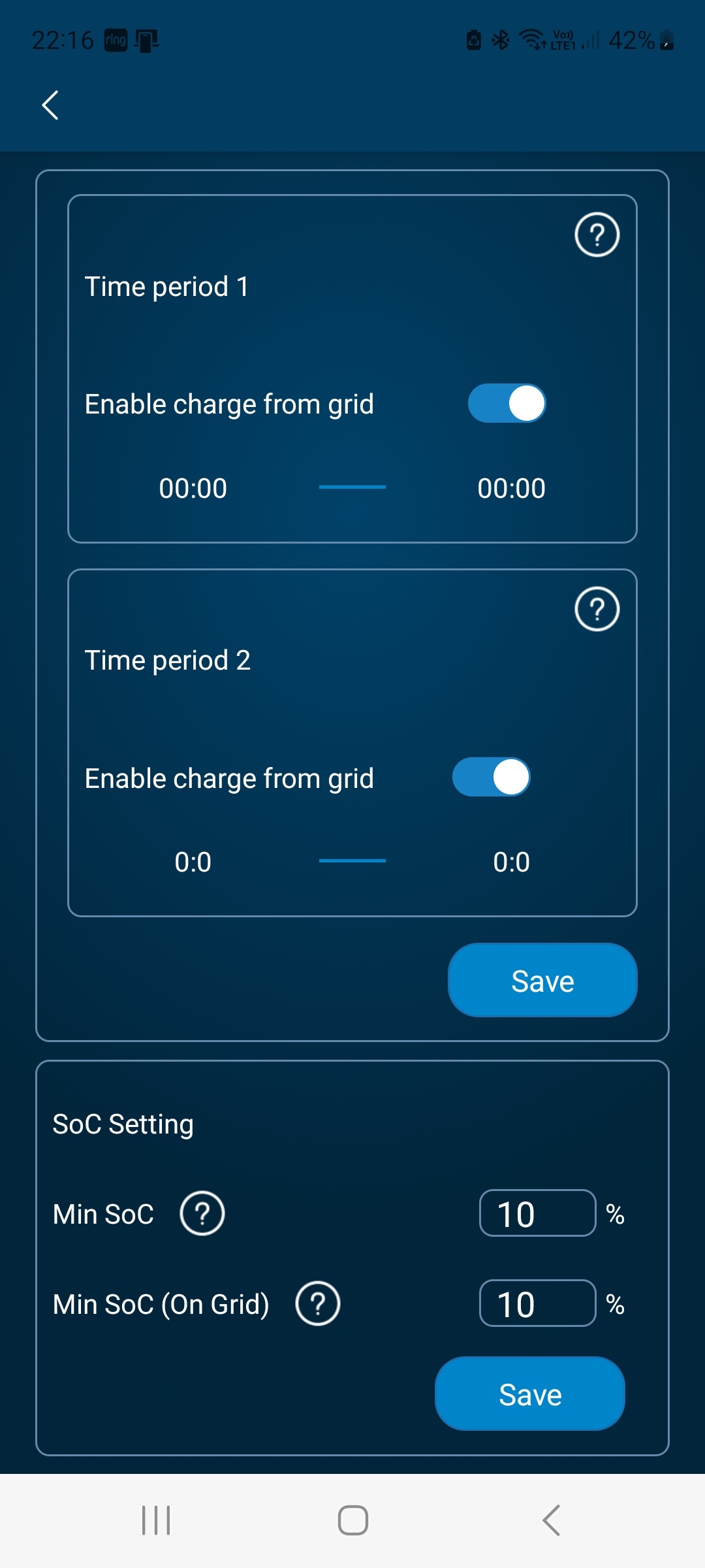

On the V1 app, you go to the Real Time Data page and click in the 'square box with a pen' next to the Working Mode: selector near the top - that will take you to Working Mode, then you click the Cog in top right corner and if you have the firmware that supports it, it will take you to the scheduler.
Or if you use the web-site go to the Energy Flow page and click on the same link which will take you to the scheduler.
I believe that many people prefer the simplicity of the Energy Stats app, it is in Settings and Scheduler
