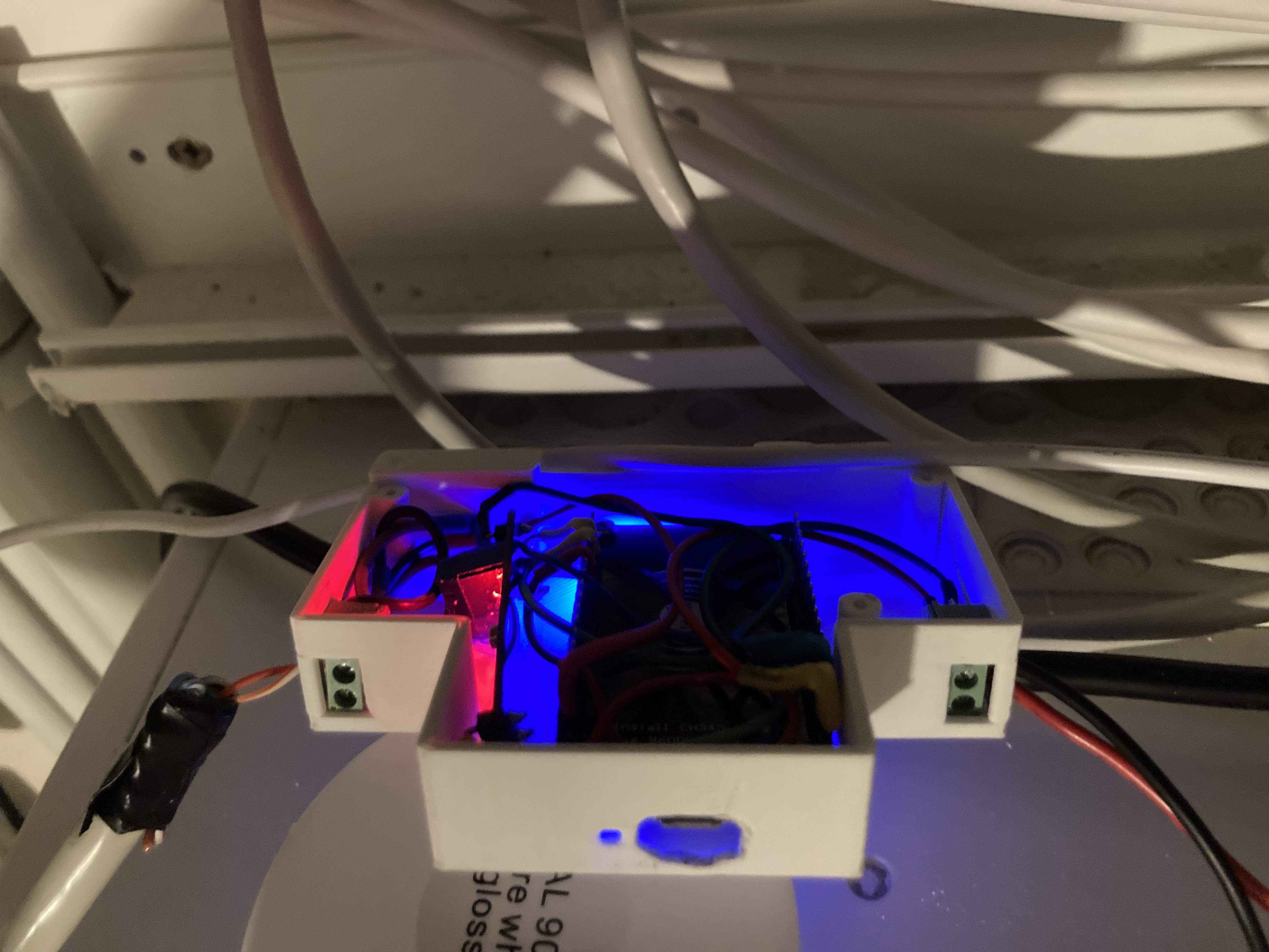

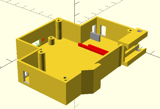

Hi !
I have very simple integration based on ESP8266 :
https://github.com/mypi-home/HA-ESPHome ... ter-Modbus
I have to change just script from H1 to H3. It is working fine. The device is placed in a DIN rail case. After debugging I will install it to the Electrical Control Panel.
