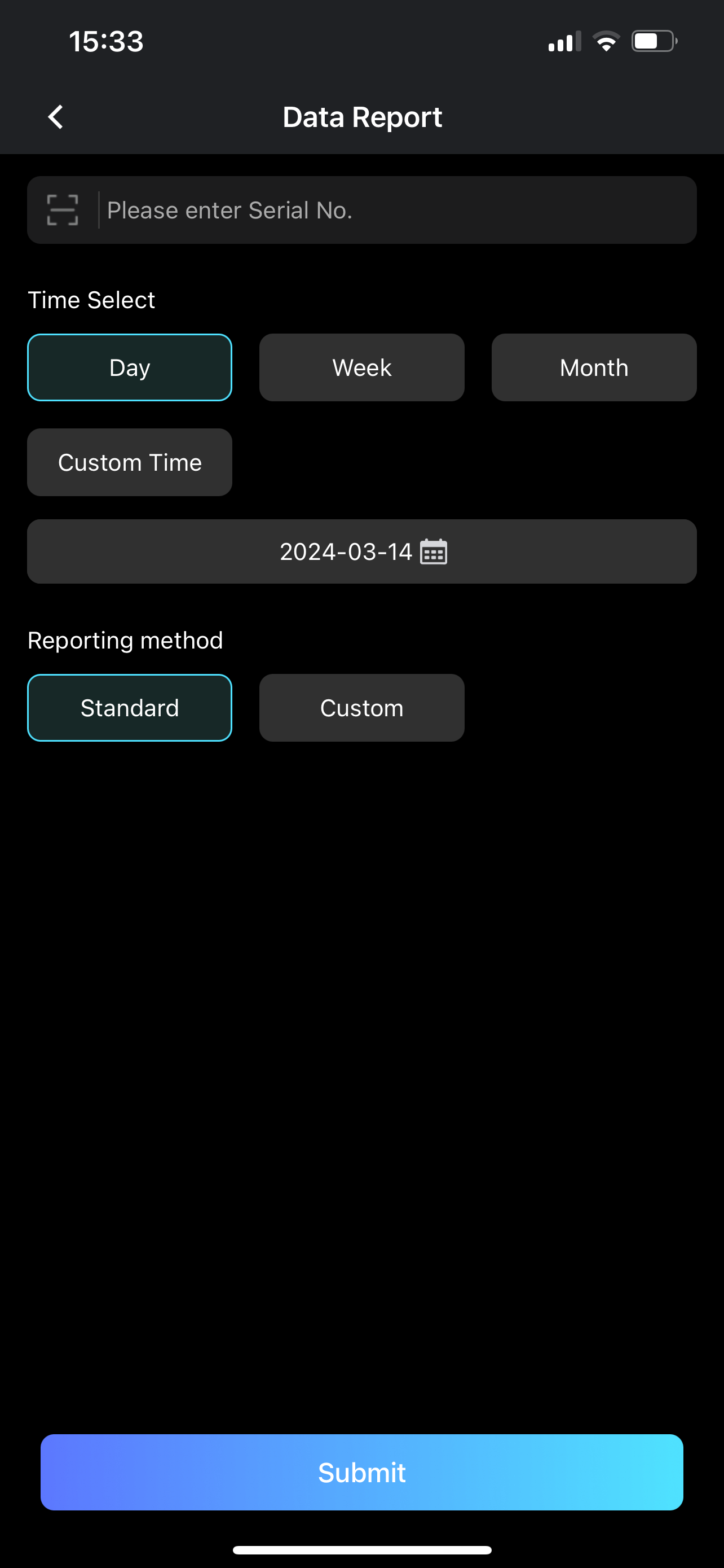

I use the FoxESS Cloud app version 2
Step 1) Go to the inverter page, click on the serial number, when a data window opens
Step 2) I click on the 'SN' field and the serial number is copied, then I close the data window
Step 3) I click on the 'me' icon, then click on the 'Data' option
Step 4) I paste the inverter serial number into the serial number field
Then you have report selections,
you set a custom date from to, or just use todays date
Then you select the data set, either 'Standard', Or 'Custom', where you have four dataset options, then you can select all, or specific data.
The custom selection is saved against a name you can enter
When you have all thew fields defined, and click the submit button at the bottom, the report (as a CSV file) is downloaded to your phone
I then copy the file to OneDrive, where I can get at it via my desktop PC
It would be great to be able to download the data directly from the web app, but I have not discovered a way to do that as yet
I will try and add a screenshot
Please could you advise how you are gathering the data?

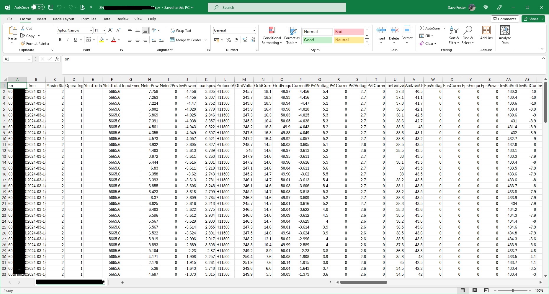

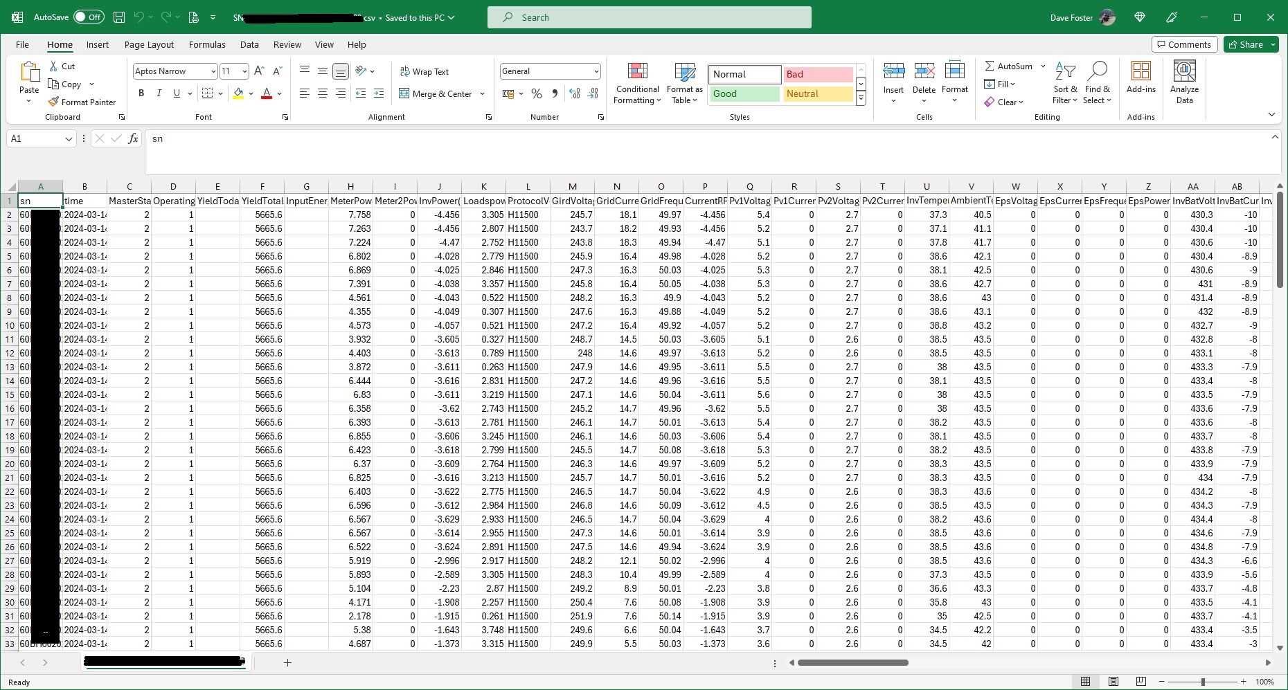

Hi Malcolm, i'm doing what you are doing with the app, choosing download and using i-cloud to copy it to my desktop computer - when I get there I simply double click on the filename (Excel is the default app for .csv's) it then opens it, works out the format and then I can save it in .xlsw format later.
If you go into Excel and open it that way, it's much more difficult as you have to specify the delimiters etc.. - much easier just to browse to it, double click on the filename and it does the rest automatically.
The website does let you download the data but you need agent access, but once the app v2.0 has finished it's development cycle the website V2 is next so hopefully you won't have to go through such a laborious way to get it.
It ends up looking like this -

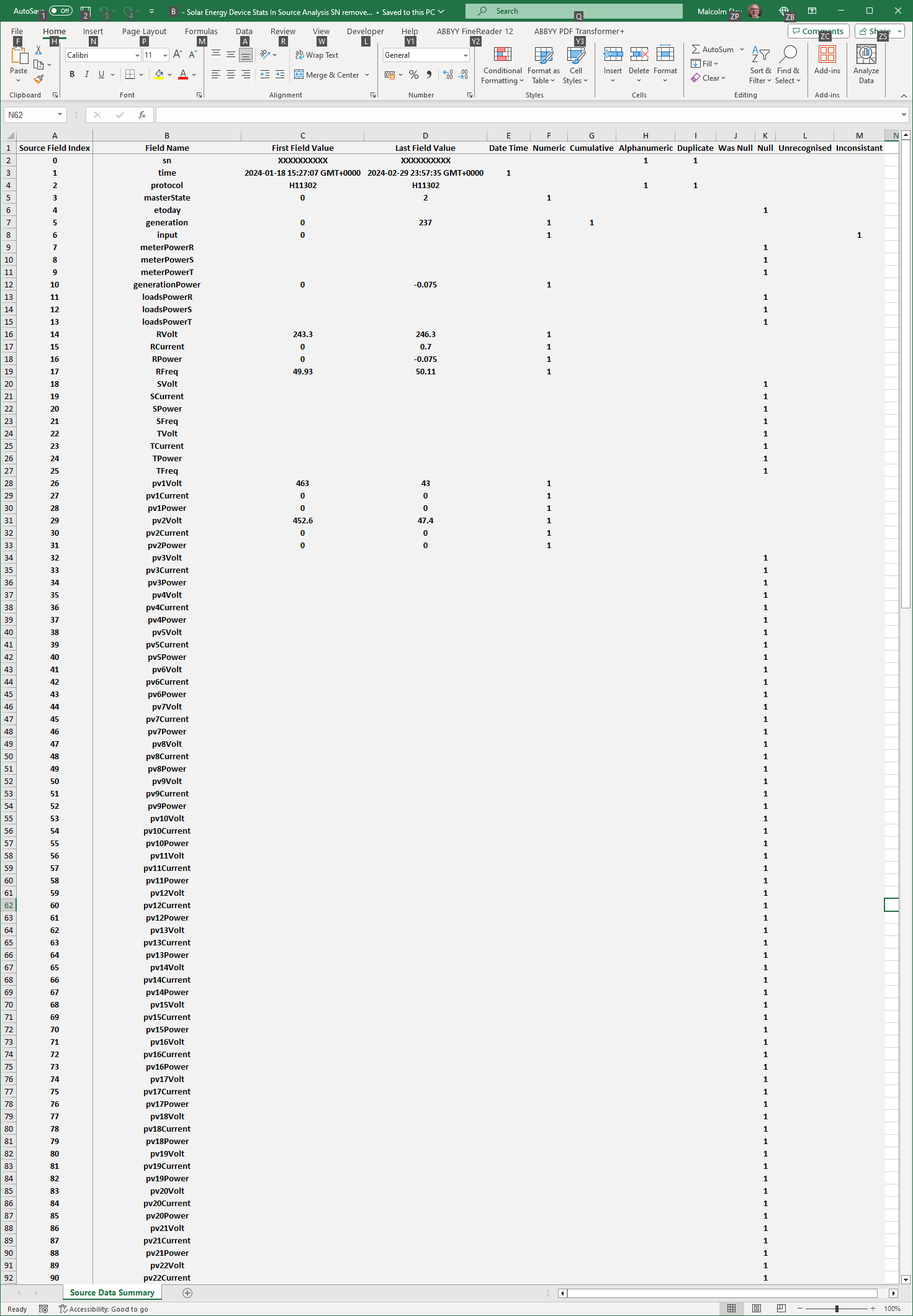

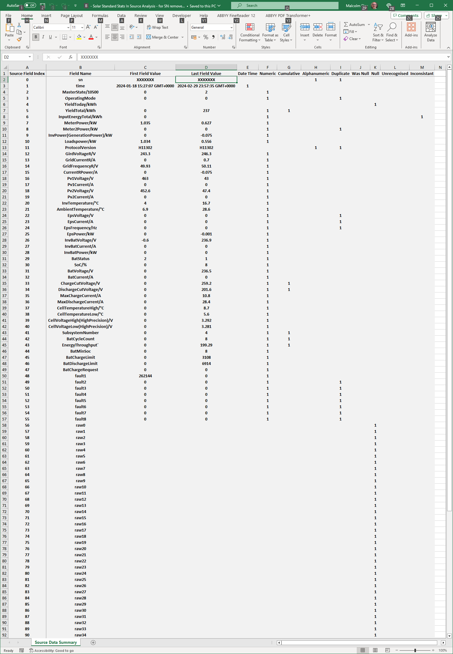

The issues I have are with the larger data set from the 'Energy Storage Device logs
I will try and attach the analysis files here to show...
This is the analysis for the 'Standard' logs (which you use)
This is the analysis for the 'Energy Storage Device' logs

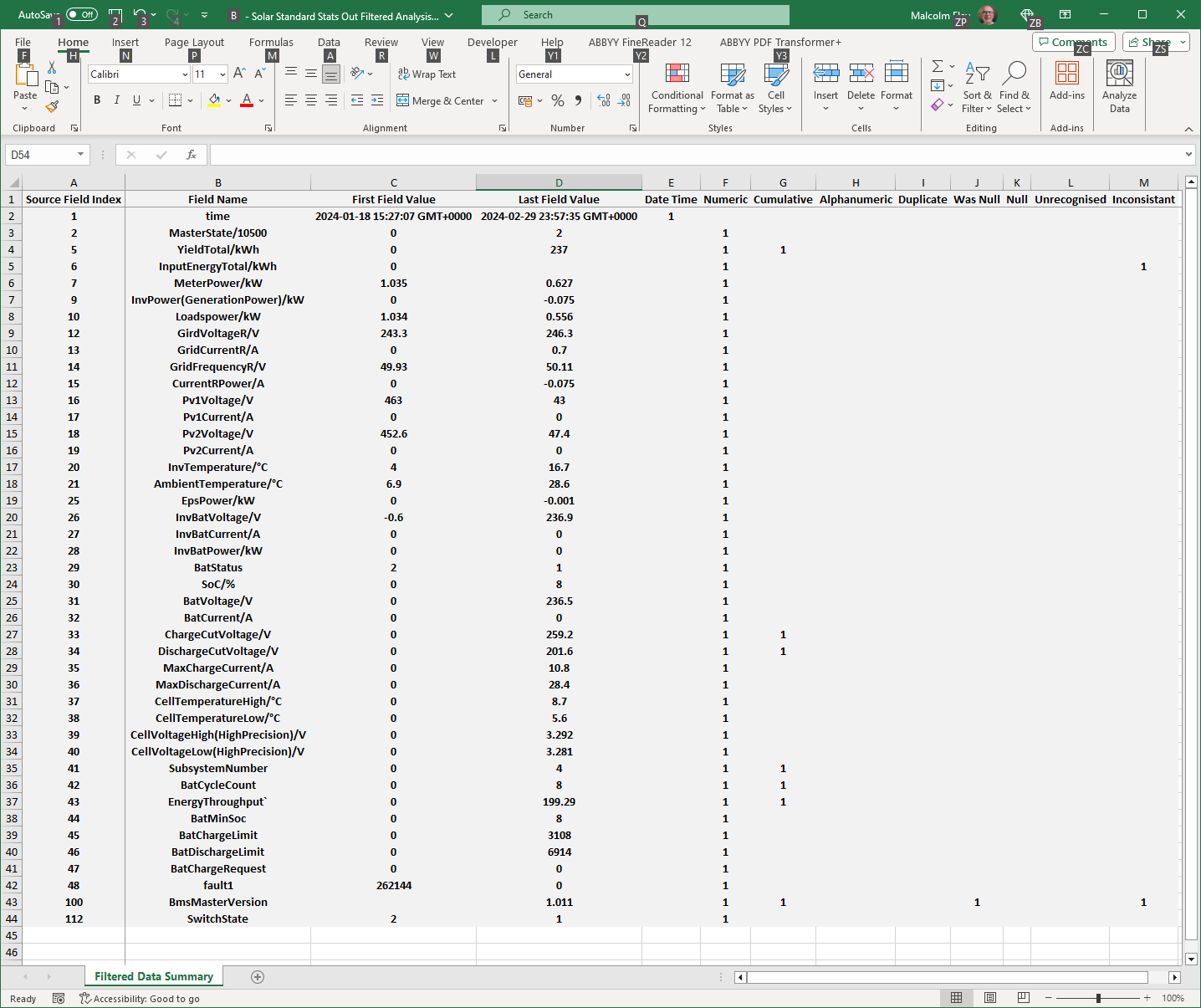

After my perl script filters the data, I am left with the following data...
Standard Logs...

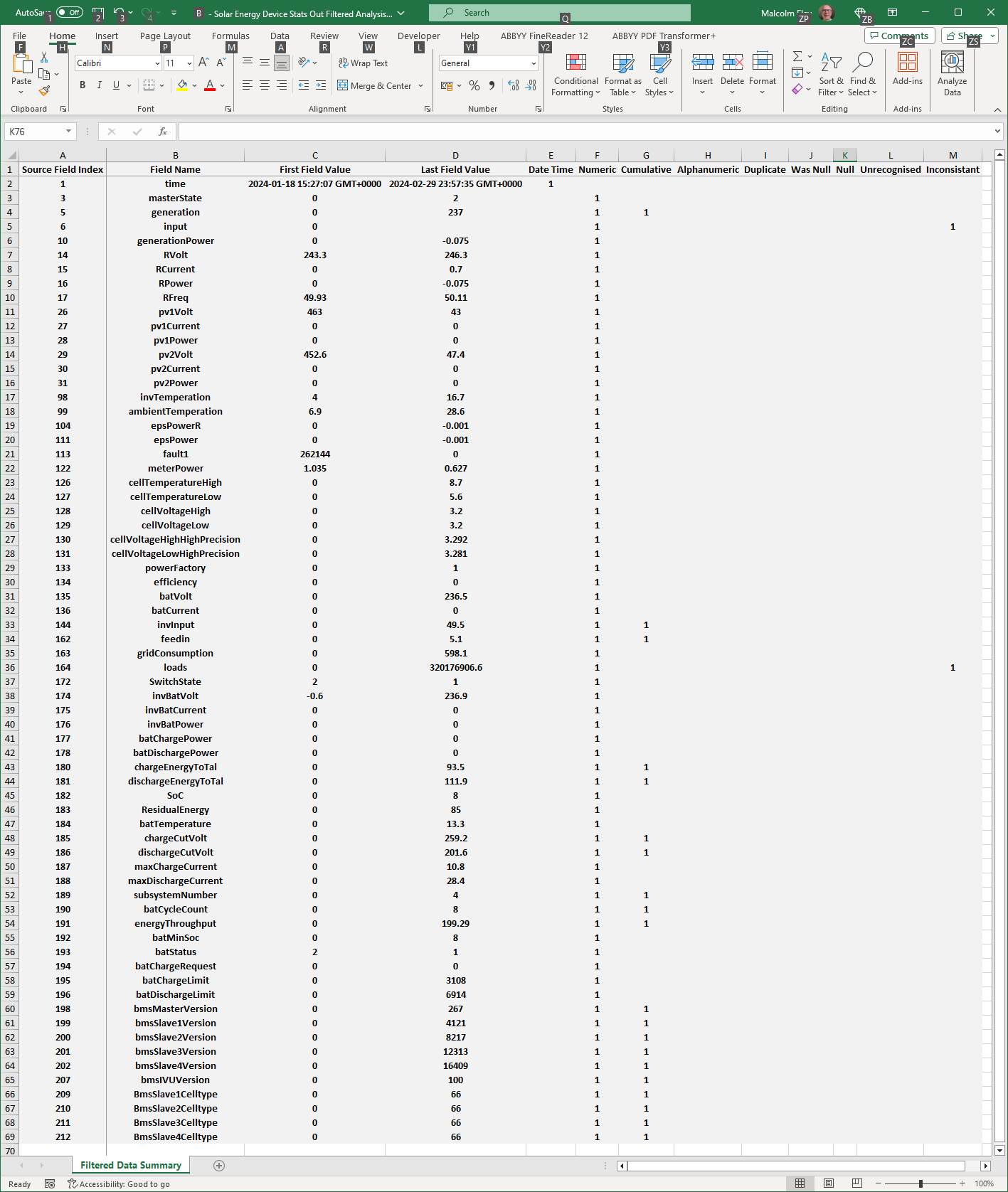

Energy Storage Logs...
As you can see, it reduces the data set somewhat ready for analysis

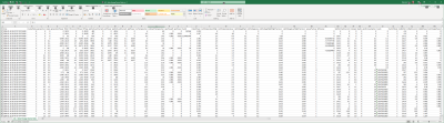

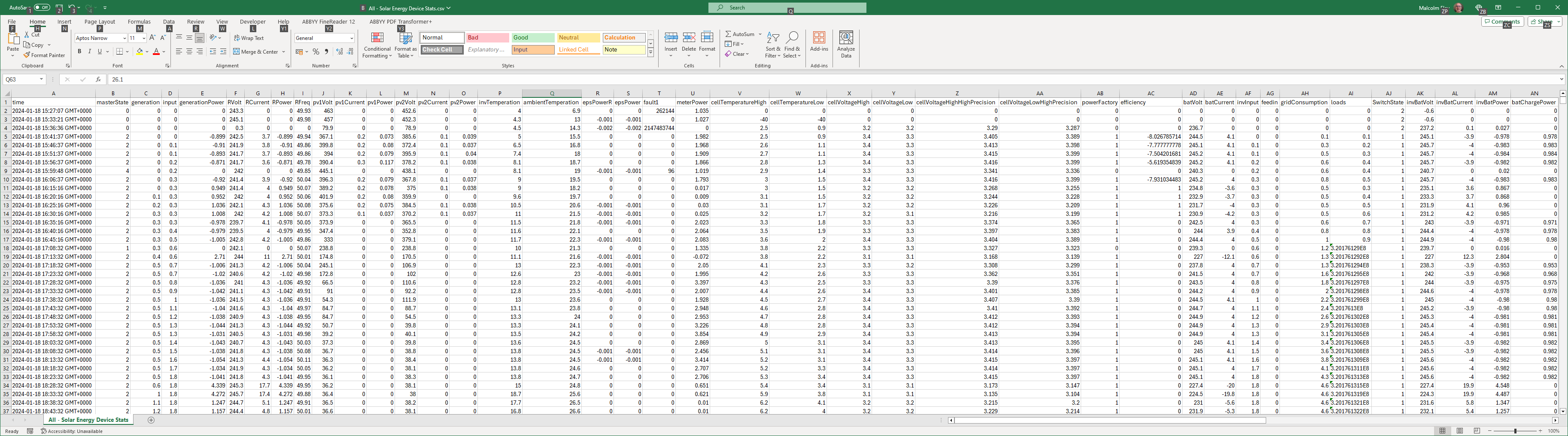

Here is the top of my filtered Excel file (of the Energy Storage Device Stats)
You can see one of the points I made in the 'loads' columb, where there is a number with 'E8' at the end of it

I wonder if the E8 you are seeing is being mis-interpreted by the filters - I would expect this to have a sign such as 3.21076E+08 or 3.21076E-08 - From intercepting the cloud load power variable I can say this would be a negative exponent (i.e. a very small number) - I often see this in the cloud data stream as the Fox cloud appears to perform a float conversion on it which sees it return 3.19999999999999 instead of 3.2, and 3.21076E-08 instead of zero (0) - all of these data values I pass through a validator which rounds to the specified precision from the protocol document.
In the case of the load power the unit is 1W (and reports in kW) and so I would round it to 3 decimal places hence 3.21076E-08 would become zero.

Not sure if you meant my filter in changing the exponant , so this is from the source data using a text editor: 3.201769068E8
I will somehow have to manipulate that, alsways assuming it s of any use at all
