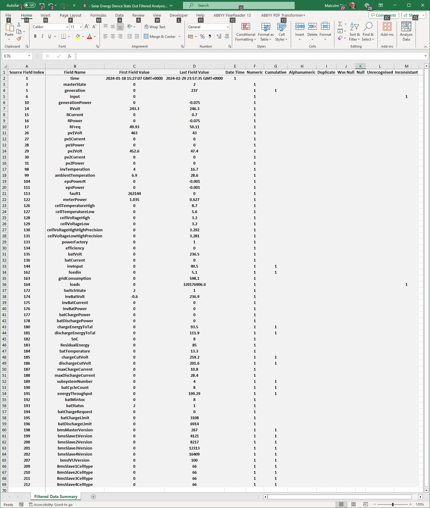

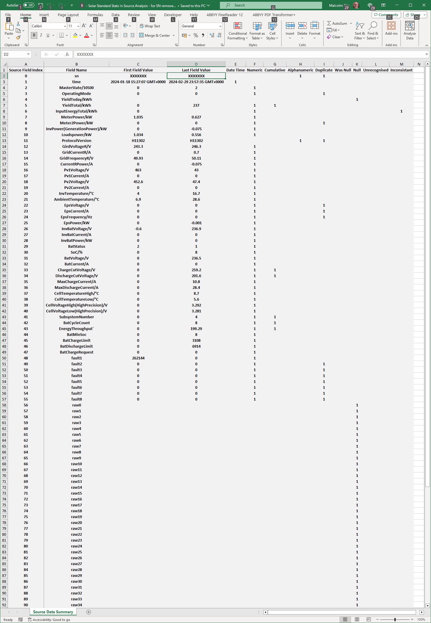

Hi Dave,
Thanks for your reply
I see that you are downloading the 'Standard' data set
As i am new to this, I have downloaded, not only the 'Standard' data set, I have also downloaded the 'Custom' 'Energy Storage Device' Data set (using 'All' data)
So I am dealing with two data sets, until I know what I am interested in
I basically gather a months data or each data set type, which I have as a set of CSV files
I then run my PERL script on the data, which analyses the data set parameters, which creates an excel file that shows what the parameters contain and whether they are numeric etc. The script then automatically creates a csv file with just the fields that are worth looking at (that is, are not null, don't have the same content in each entry etc)
The issues I have are with the larger data set from the 'Energy Storage Device logs
I will try and attach the analysis files here to show...
This is the analysis for the 'Standard' logs (which you use) This is the analysis for the 'Energy Storage Device' logs
After my perl script filters the data, I am left with the following data...
Standard Logs... Energy Storage Logs... As you can see, it reduces the data set somewhat ready for analysis
Here is the top of my filtered Excel file (of the Energy Storage Device Stats) You can see one of the points I made in the 'loads' columb, where there is a number with 'E8' at the end of it
I am currently working on the next part of my script, where I want to extract data by using a csv specification - so for instance it would create an excel spreadsheet with average power created in each hour... either between two dates, or for all data
I am slowly getting there
However on the way, I am finding these quirks
... and that's before I ask what the data actually means (where it is not obvioous - for instance as follows...
This is entered in my debug file
Step 5: Run Spec file
Field: pv1Power, Low: 0, High: 0.073
So the high value is the highest in the data set, so is this value in kW?
Anyhow, if you don't use the Energy storage device logs, I guess I am on my own?
Any comments?
Cheers
Malcolm

In all honesty i've never used the custom data set, the website (as an agent) allows you to download the complete data set in it's entirety - however I use home assistant which gives me near real time data from all the sensors so I build my stats based on that.
Sadly I suspect at this stage you may be on the bleeding edge of this, the V2 app is relatively new and most technical users tend to move to the home assistant solution. But I can answer a couple of things, as the data is derived from the inverter registers and so scaling and precision are defined in the documents and from that pv1Power is reporting as kW to 3 decimal places.
I wonder if the E8 you are seeing is being mis-interpreted by the filters - I would expect this to have a sign such as 3.21076E+08 or 3.21076E-08 - From intercepting the cloud load power variable I can say this would be a negative exponent (i.e. a very small number) - I often see this in the cloud data stream as the Fox cloud appears to perform a float conversion on it which sees it return 3.19999999999999 instead of 3.2, and 3.21076E-08 instead of zero (0) - all of these data values I pass through a validator which rounds to the specified precision from the protocol document.
In the case of the load power the unit is 1W (and reports in kW) and so I would round it to 3 decimal places hence 3.21076E-08 would become zero.
