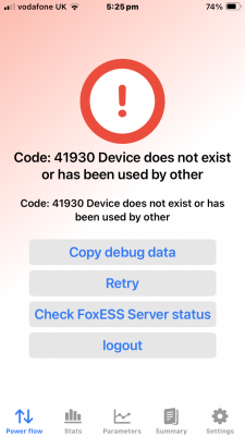

hi dave , re the ES app , i just tried to get in with no success ,.
i have updated the app , and now have a page asking for the API , i click the link , and sign in , however , the display in a i phone se 2020 is showing a tiny strip of the api page ,so i cannot copy and paste it .
i then opened my fox ess portal on my laptop , generated an API on there , and copied it down bit by bit ,on the app on the phone , and it gave me an error message , and no luck .

hi dave ,
thank you for the quick reply , i did exactly that lol , with no luck just an error message , i did just now work out how to get my phone to show the whole api page , and that was to turn it on its side... doh !
but now on my phone i click generate api , it then warns me a new api with delete the old one and i click ok , and then nothing happens , no api .

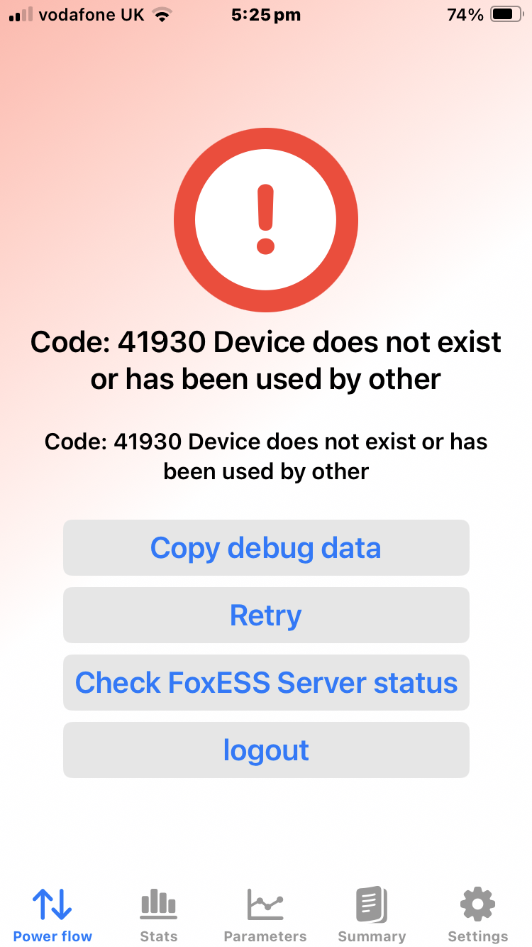

okey dokey !
managed to copy the number , paste it to an email , take a photo of it with the phone , then highlighted the number and copy and pasted it to the app , and got this
i searched for code 41930 on the net, and it came up as "odd coloured socks on " so i checked but no they are both black .

Hmmm it sounds as if all that transferring of data may have induced a typo, or missed a character - the error 41930 occurs if the key is invalid, or re-used.
Some users have found they only way they could get this to work was by manually typing the long key by hand from the website straight into the app.
Can you re-generate the key on the webpage - and then type exactly what it gives you, including all of the '-' characters into the apps api_key, there should be 36 characters in total.

Nope Sadly no luck dave , :(
interestingly , if i follow the link on the app to go to generate key , i can click on generate key , but no key will appear .
if i go into my laptop , and do the same i get a key , if i take a picture of that key with my phone i can highlight the number and copy it , and paste to the app , but the process can change symbols , so you have to check through to see if it has copied it faithfully .
i have also copied the key in digit by digit manually , and that didnt work either .

Re: FoxESS cloud status Energy Stats, Home Assistant Cloud
The key you sent me worked fine, so it must be some kind of copying problem - I think given what you have said manual entry is the only way to do it reliably if you cannot copy and paste it.
in which case apologies if I am teaching you to suck eggs but -
the entry is always structured as x characters then - then next block of x characters
And it is always in blocks of 8-4-4-4-12
The numbers are hexadecimal so only numeric characters and a,b,c,d,e,f can be in the string with '-' in between
the hex letters are always lower case
so for example this an old one of mine, the format will be similar:
2c557f7f-1ae8-46af-bb78-a124adbbd22b
If you could double check all of that and failing that i'll message Al and see if he has any tricks up his sleeve.

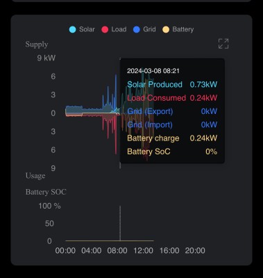

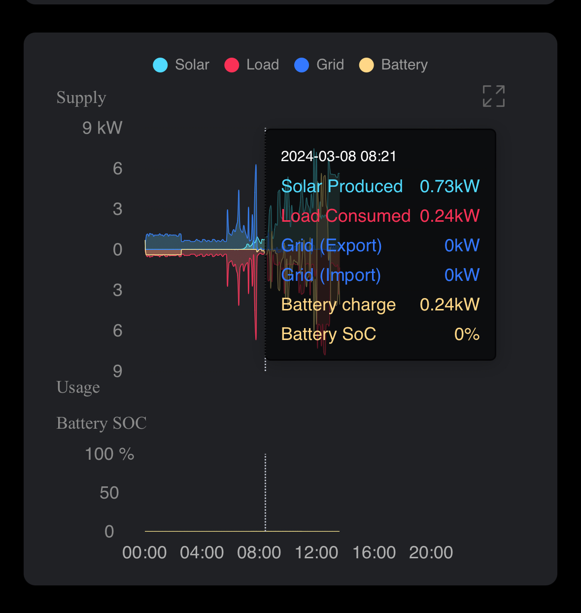

I've just had an H3 system installed. I've setup an integration into Home Assistant using the cloud integration and noticed that Battery SOC% is not pulling through.
The official 2.0 app shows the battery % on the home page but nothing when looking at the daily graph. Also tried the "Energy Stats" app and SOC% also 0 there, so clearly an issue with the API.
I have contacted foxess support but yet to hear back. Is this something effecting just me?
timsdrew wrote: ↑Fri Mar 08, 2024 12:57 pm I've just had an H3 system installed. I've setup an integration into Home Assistant using the cloud integration and noticed that Battery SOC% is not pulling through.
Mine is working, but I have heard a few people saying there were issues earlier and that again some maintenance was being done - interestingly the battery stats are stored separately from the main database and so i'd wait 24 hours and see if the problem persists.
