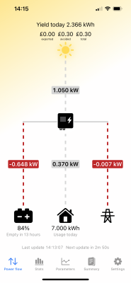

I may have found a small bug in the updated Energy Stats app. When the solar is putting power back into the battery the value used to be green. When taking power from the battery the power is depicted as red. Now it appears that the value is depicted as red regardless of topping up or discharging.
Also says under the battery symbol that the battery will be empty in xx days/hours whereas it should be saying it will be full up as it is actually putting power in. The battery value is going up so it does work.
Makes no difference, just an observation!

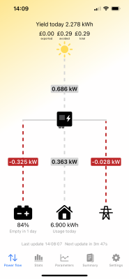

Another screenshot showing same issue:-

Dad wrote: ↑Tue Feb 20, 2024 2:16 pm Another screenshot showing same issue:-
Looks like Al has already picked up on that bug, he asks to update to V2.1 when you can.

I emailed Al and he is aware of the battery flow bug (it’s actually a second bug as it is now showing the flow the other way around) and will release a new version in the morning.

Latest state of play is Android 2.3 now in the store, Ios 2.2 coming very soon and these should be the flow fixes
