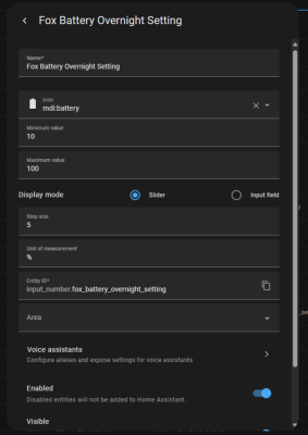

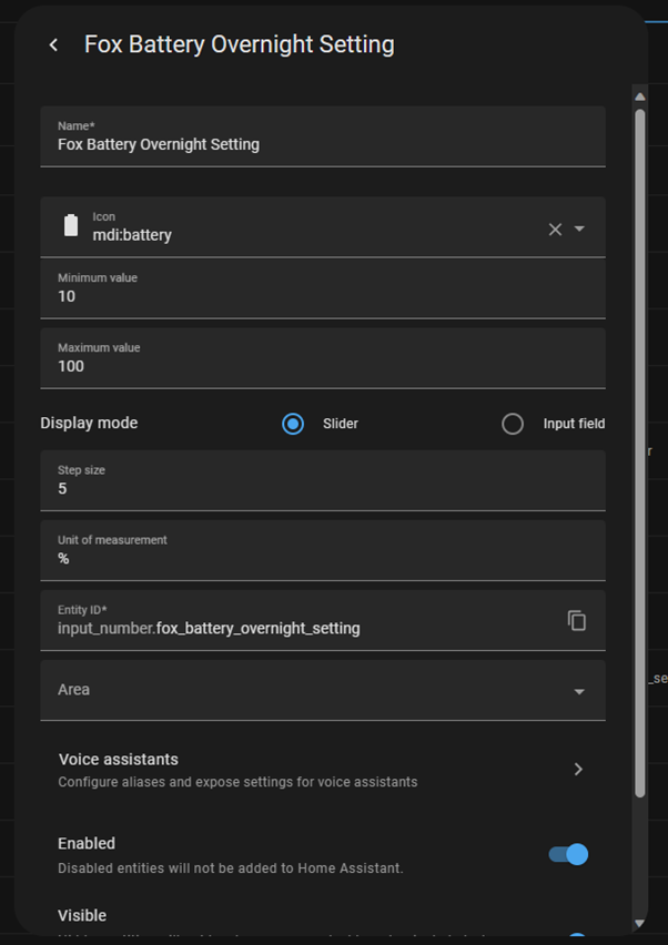

1) Set up an input number and name it "Fox Battery Overnight Setting".
Copy the settings in the image below.
You can modify the step size if you want more precise control over the SoC - I've set 5% as the step size personally.

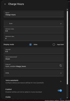

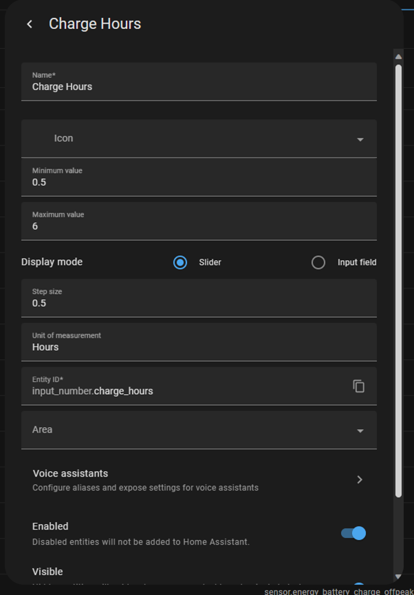

2) Set up an input number and name it "Charge Hours".
You can amend the hours accordingly for the slider - I have it set from 0.5 hours to 6 hours which is more than enough for most off-peak periods.

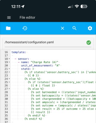

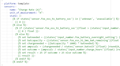

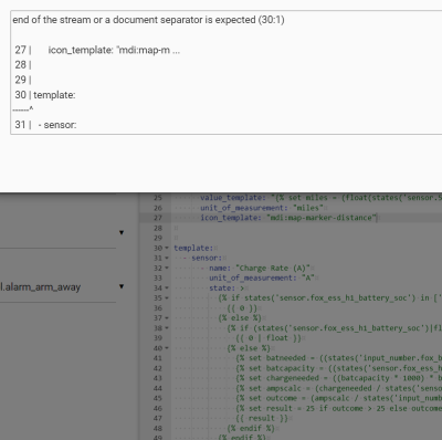

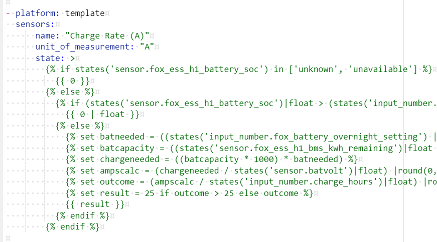

3) Copy the sensor YAML into your configuration file under one of your templates.
This is a "new" style sensor format so will need to be placed carefully in your YAML to group with existing sensors under the new format. If you use the old style format, make sure this is placed above the row that says "sensor:".
Just make sure that the sensors and input numbers in this code match what you have for your HA.
If you have just one inverter, have Nathan Marlors FoxESS Modbus integration and have the above two input sensors set up - then this code should match perfectly.
Code: Select all
template:
- sensor:
- name: "Charge Rate (A)"
unit_of_measurement: "A"
state: >
{% if states('sensor.battery_soc') in ['unknown', 'unavailable'] %}
{{ 0 }}
{% else %}
{% if (states('sensor.battery_soc')|float > (states('input_number.fox_battery_overnight_setting')|float * 100)) %}
{{ 0 | float }}
{% else %}
{% set batneeded = ((states('input_number.fox_battery_overnight_setting') | float - states('sensor.battery_soc') | float) / 100) %}
{% set batcapacity = ((states('sensor.bms_kwh_remaining')|float / states('sensor.battery_soc')|float) * 100) %}
{% set chargeneeded = ((batcapacity * 1000) * batneeded) %}
{% set ampscalc = (chargeneeded / states('sensor.batvolt')|float) |round(0,default=0) %}
{% set outcome = (ampscalc / states('input_number.charge_hours')|float) |round(1,default=0) %}
{% set result = 25 if outcome > 25 else outcome %}
{{ result }}
{% endif %}
{% endif %}

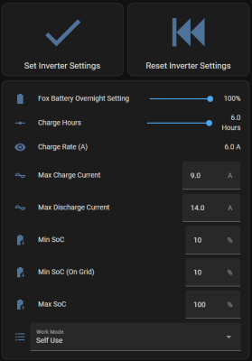

If you want to have the card in the image below on your desktop - create one with the YAML code below.
You can also create buttons that trigger the first two automations and force them to run if needed during the day.
