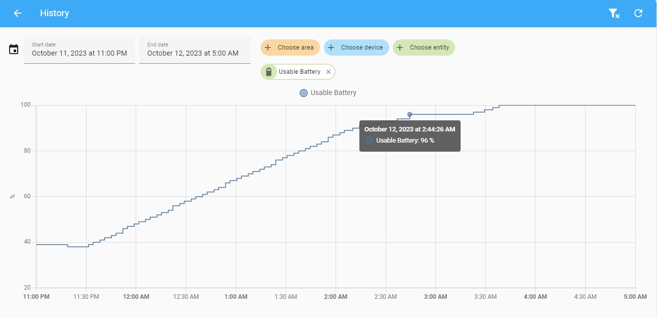

Just coming back to this now that we're firmly back in "charge battery every night" mode - especially now the weather is getting cooler and our heatpump is taking the strain.
As I speculated earlier in the thread, our 3.6kW inverter won't charge our battery bank (6*HV2600) from 10% SoC to full in a 4h Octopus Go off peak window, at least not with the Jinja night curve file as posted at the top of the thread. If you have a longer off peak window, or a more powerful inverter, you will probably be fine.
In my case I am experimenting with a later and slower rampdown, while still avoiding charging the battery hard at the end of the charge curve - I'm trying to gauge how hard I'm pushing the battery (or not) by how much the battery imbalance (the % difference between highest and lowest cell voltages) spikes when the battery approaches / reaches 100% SoC.
Separately I'm looking into the possibility of upgrading the inverter to a 6kW model, as part of upgrading some of the house circuits to work off EPS in the event of a power cut, but that's got bogged down in G99 approvals with ENWL...

I changed to Octopus Intelligent 2 months ago, and having the 6 hours is a real game changer. Even on the 3.7kw inverter you'd get a full charge with the slow ramp - is your car/charger supported - it's worth looking at, not least as it's 7.5p vs 9p for GO.
The latest firmware is much better with SoC predictability, but i've noticed my pack seems to pause at 96% and have a think about it's capacity, that one % always elongates and is twice as big as what i'd expect (my pack ~200w per %), thereafter it plays catch up to hit 100% - perhaps 95% is the magic number to start ramping down at?
Just wondering what you mean by "latest" in this context? I ask because I upgraded the system firmware (for all the components) at the end of April, but I've not looked at new versions since then (too much else going on). I still have the Agent Account and the alternative Wifi dongle so I can do the same process as last time, if things have improved again.The latest firmware is much better with SoC predictability,
I've just checked the SoC history graph in HA and mine looks very similar to yours, with a "pause" at 96%, so I'll have a play with into the "ramp down from 95% SoC" idea, thanks for the suggestion.
The car isn't, and the mfr (Hyundai) shows no signs of doing the necessary validation. The Zappi integration looks to be going through teething pains so I've left it for now. I do keep an eye on it though, will take a serious look once it comes out of Beta.is your car/charger supported - it's worth looking at, not least as it's 7.5p vs 9p for GO.
Lol, no the ‘latest’ hasn’t changed since late May, I suspect your on the same as me - Master 1.020 and Slave 1.06 it’s been very stable throughout summer, so i’m hoping for better things this wintercalum wrote: ↑Fri Oct 13, 2023 3:00 pm Just wondering what you mean by "latest" in this context? I ask because I upgraded the system firmware (for all the components) at the end of April, but I've not looked at new versions since then (too much else going on). I still have the Agent Account and the alternative Wifi dongle so I can do the same process as last time, if things have improved again.
I ended up with this for the night time charge curve:
With this profile my 3.6kW inverter will take a "flat" (ie 10% SoC) battery bank (6xHV2600) and get it to 98% SoC in the 4 hour Octopus Go off-peak window. Not quite fully charged, but close enough.
