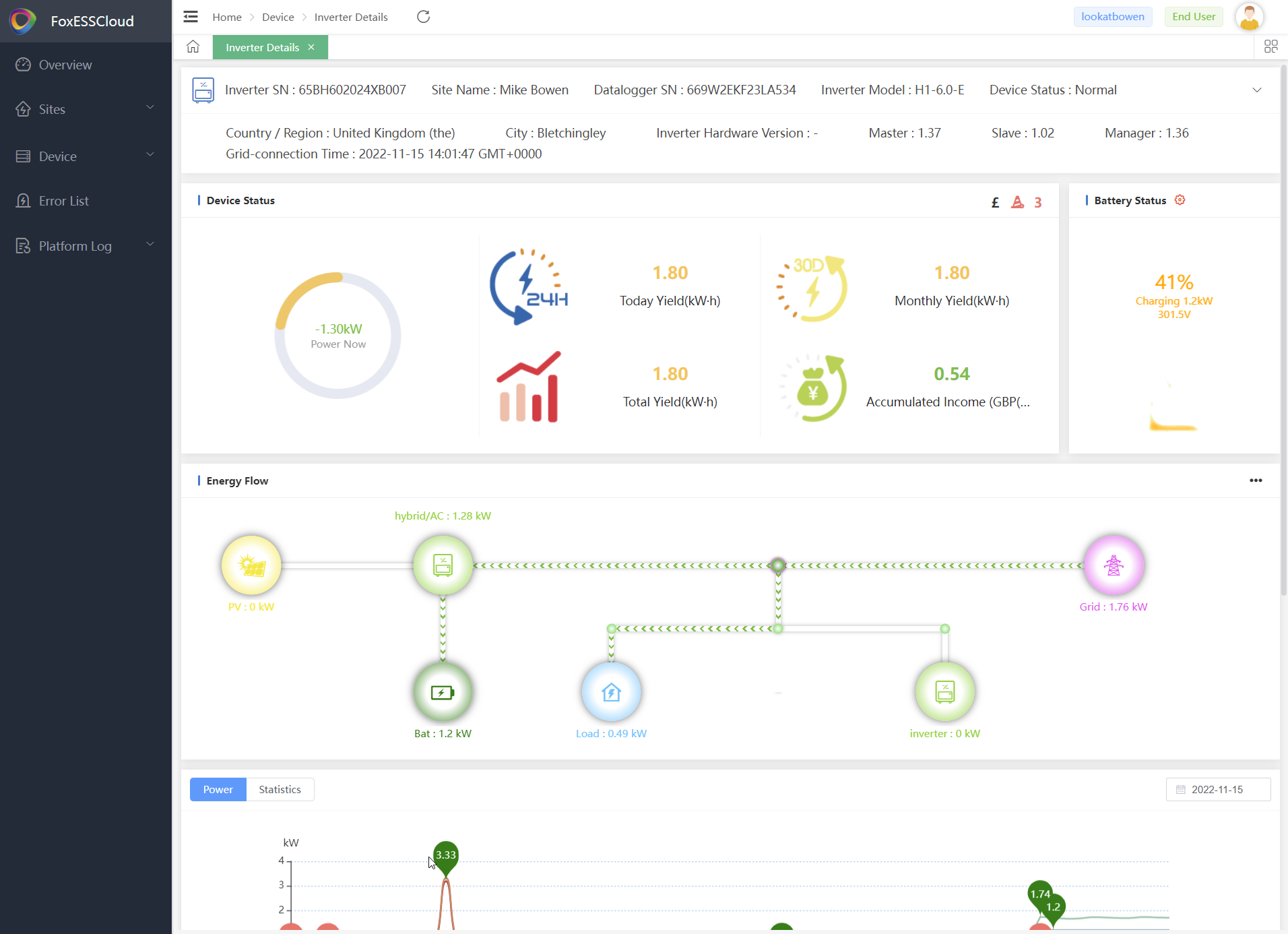

The battery and 6kW hybrid inverter were installed today. I watched the energy flow diagram on the FoxESS cloud website after the installer left this afternoon, and it looked okay.

I don't know if it is a coincidence, but my wife came home and plugged in our EV. I checked the energy flow diagram on FoxESS cloud, and the battery is now charging at 1.21kW. Why is this happening? I don't want the battery to charge during peak time. It is odd that is it charging at 1.2kW as well. If its going to charge at all, then why not at a higher kW?

I am confused as to why the battery is charging now. Could it be a time zone setting? It seems to be ignoring the times I have added to the time frame?
Can anyone provide an answer?

I watched the video on Understanding FoxESS reporting and answering "Why am I exporting, Why am I using the grid", which explained a lot of what I was seeing.
The other problem was the Min SoC (On Grid) was set to 100%, and that is what caused the battery to start charging during peak.
