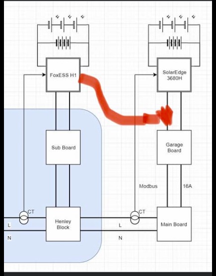

You can have a solar only inverter with a Hybrid battery system, but you cannot daisy chain 2 Hybrid systems as they will fight with each other to balance the loads - the only way to do it is to split your consumer unit into two and then wire them in series (see sketch courtesy of the Facebook group - the red wire is CT2 which you will need if they are not both Fox inverters so you can see all your generation in cloud)
If it's a solar only and Hybrid battery then you would install the Hybrid as normal with main CT connected on the tail of the incoming meter.
