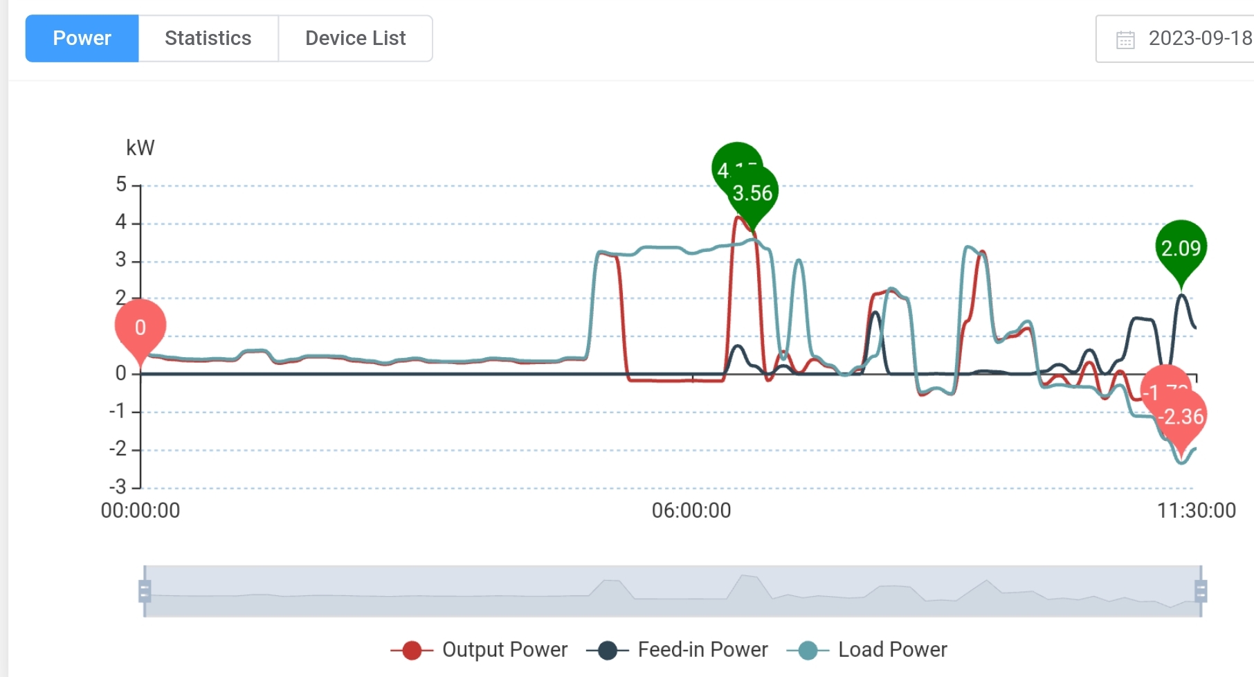

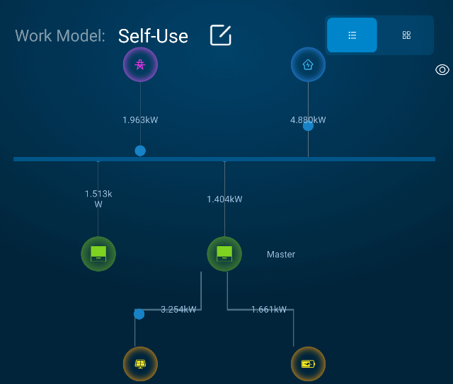

Hello Everyone,
I have a Fox system which consists of the Fox ECS battery storage system and 2 X Fox H3 inverters. It's a large system with both inverters being at 12kw each and a large battery backup.
For some reason I just cannot figure out and try and reduce the constant pull from the grid. My battery is at over 95% when the attached picture was taken and I am still pulling over 0.1kwH from the grid. This is adding up since I've used over 100 units of energy on my electricity meter in 3 days, even though I have maintained over 40% battery at all times throughout the night and I am fully charged up in a few hours in the morning.
Why the constant draw from the grid? How can I stop this completely or reduce?

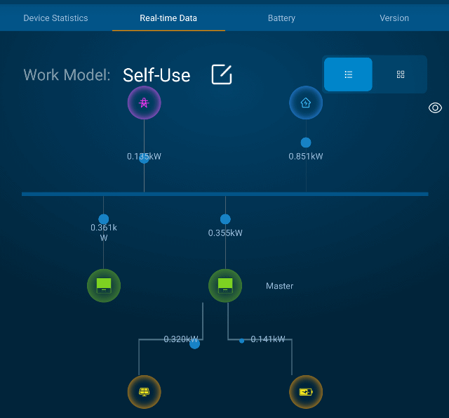

Here is another image taken just now.

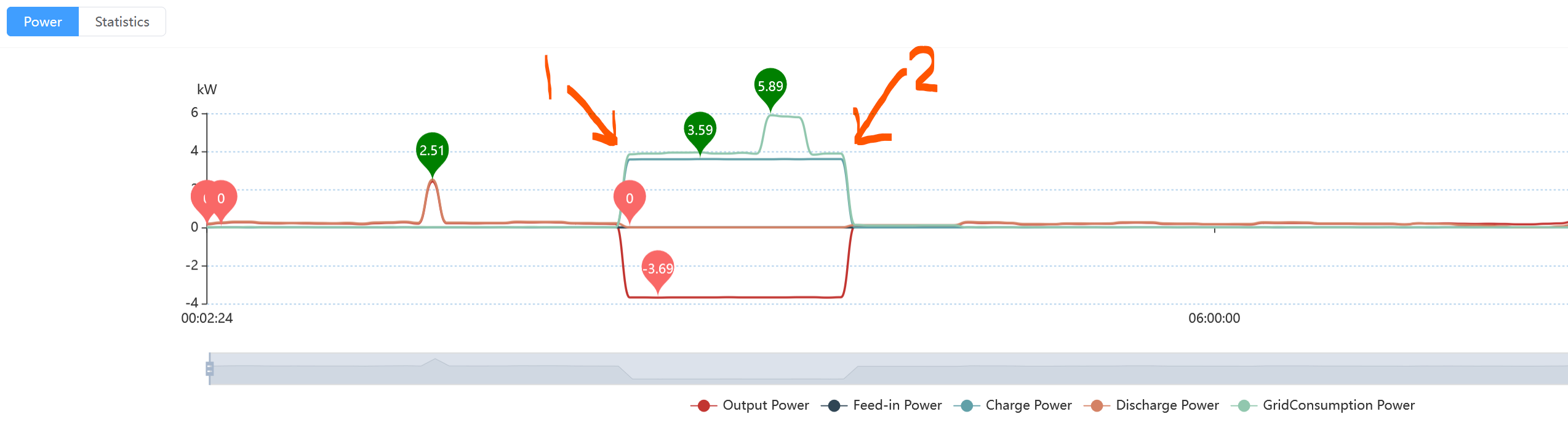

In the example I've just taken from my own system, you can see the grid consumption line is very close to zero until 2.30am, when it starts to charge the battery from the grid (labelled "1" on the screengrab). At about 3.20am you can see the consumption increases to nearly 6kW, this is because the dishwasher was finishing the drying cycle at the same time as the battery was still charging. At 3.52am (labelled "2") you can see the charging stops, as the battery had reached the MaxSoC I'd set it to. Then at 4.30am the grid consumption line drops back to almost zero again, because that's when the charge period I'd set ended.
If your grid consumption line strays away from zero without good reason, then something's up. Otherwise, you're maybe just seeing the effects of only taking a reading every 5 minutes - it can be misleading.

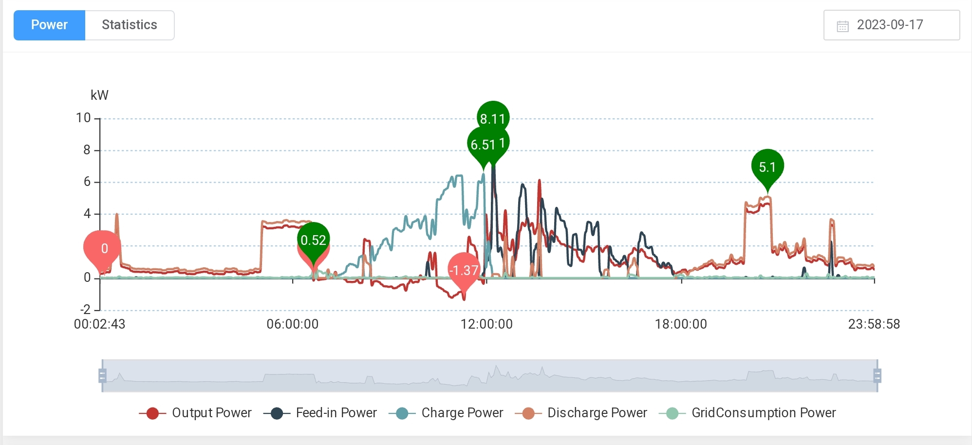

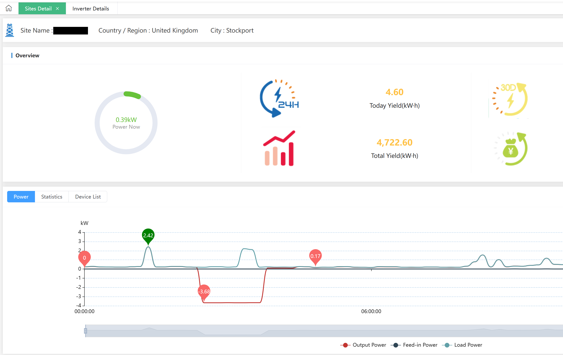

That's very interesting. I have just logged in and pulled the following 2 screenshots from today and yesterday.
Does this look normal?
The spikes in usage are due to the immersion being switched on.
Thanks in advance.
Posts: 392

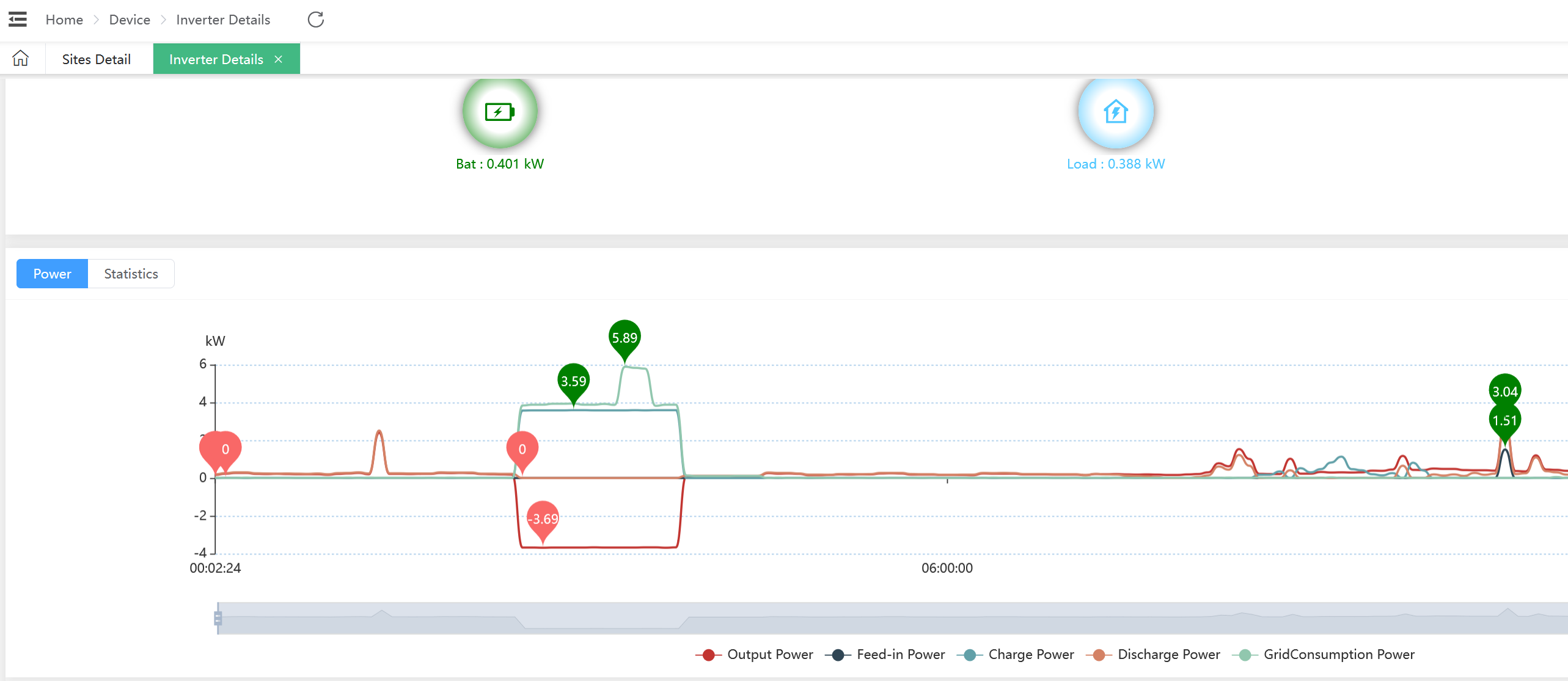

You need to be looking at the "Inverter Details" rather than the "Site Details" (see the tab name at the top in green):
"Inverter Details" - shows power to and from grid
"Sites Detail" - doesn't help you as no grid trace

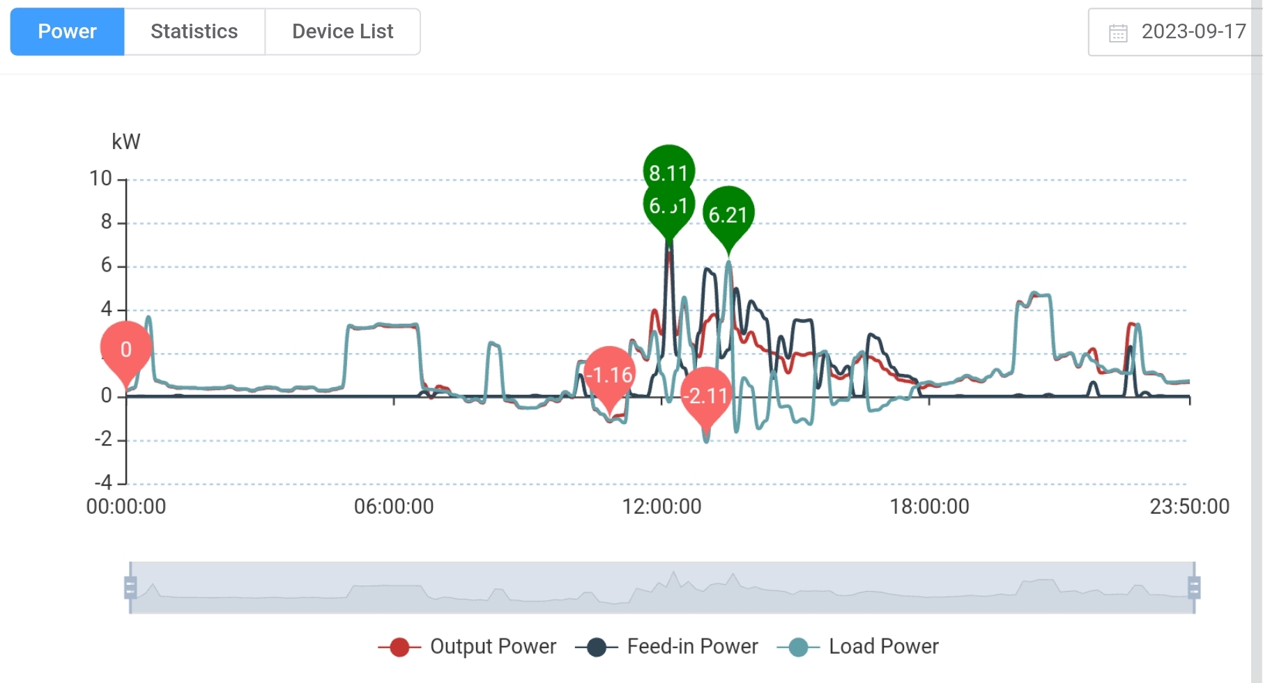

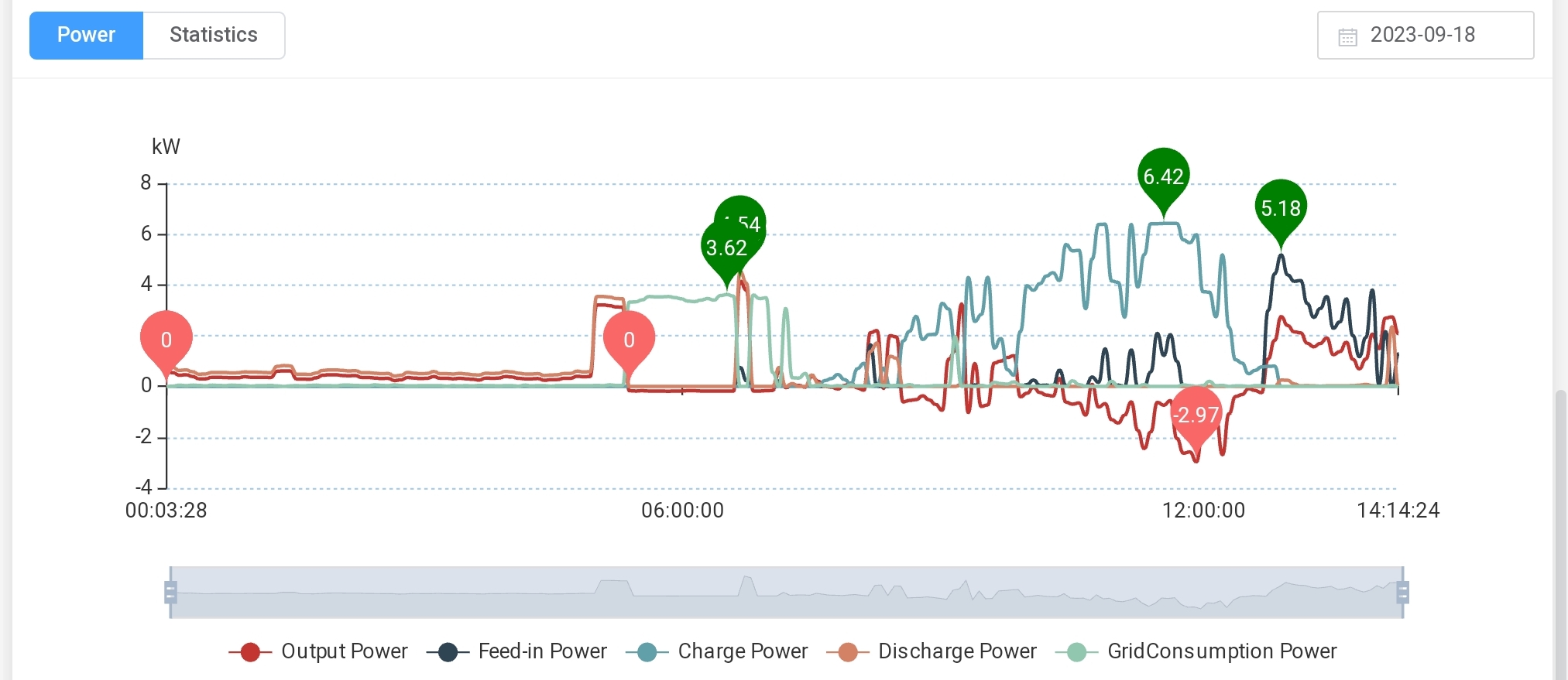

I think I have it now:
Posts: 392
Looks fairly normal to me, ie your system is pulling from the grid at certain times of the day, but not all the time. Do the times it's pulling in grid power make sense to you?

These surges are in line with my timer controls on the immersion heating. Although, I'm concerned that if I'm mainly pulling from the grid for whatever reason at these times instead of from the solar panels or battery, I can't see the point of using the immersion. From the graphs it looks like the grid pull actually continues for the entire duration.
canton7
Posts: 42
Joined: Sun Oct 23, 2022 12:17 pm
The only time I see you pulling from the grid is in your first screenshot around 6am, and that's presumably because you depleted the battery: suddenly the discharge power drops and you switch to the grid, and remain on the grid until solar picks up.
Add the battery soc to the graphs, and you'll see for sure.
