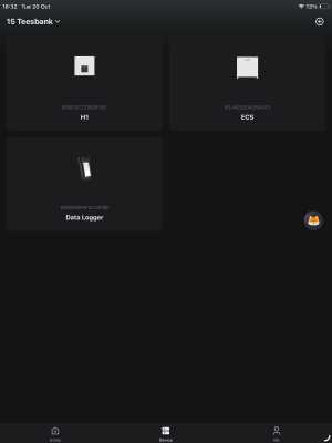

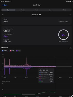

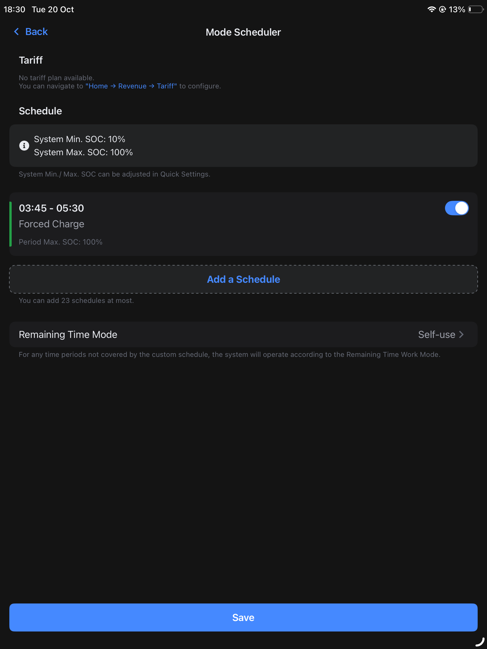

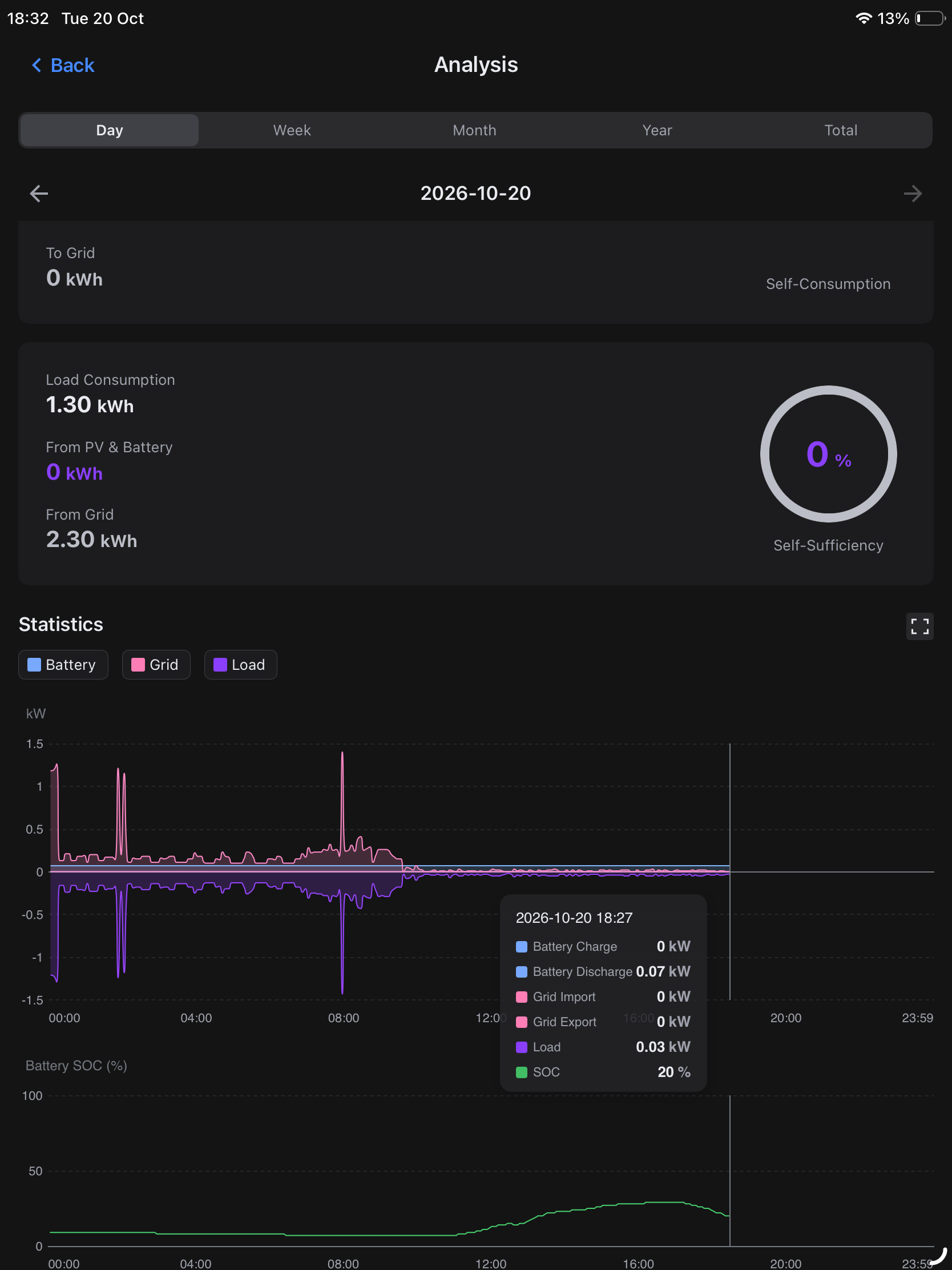

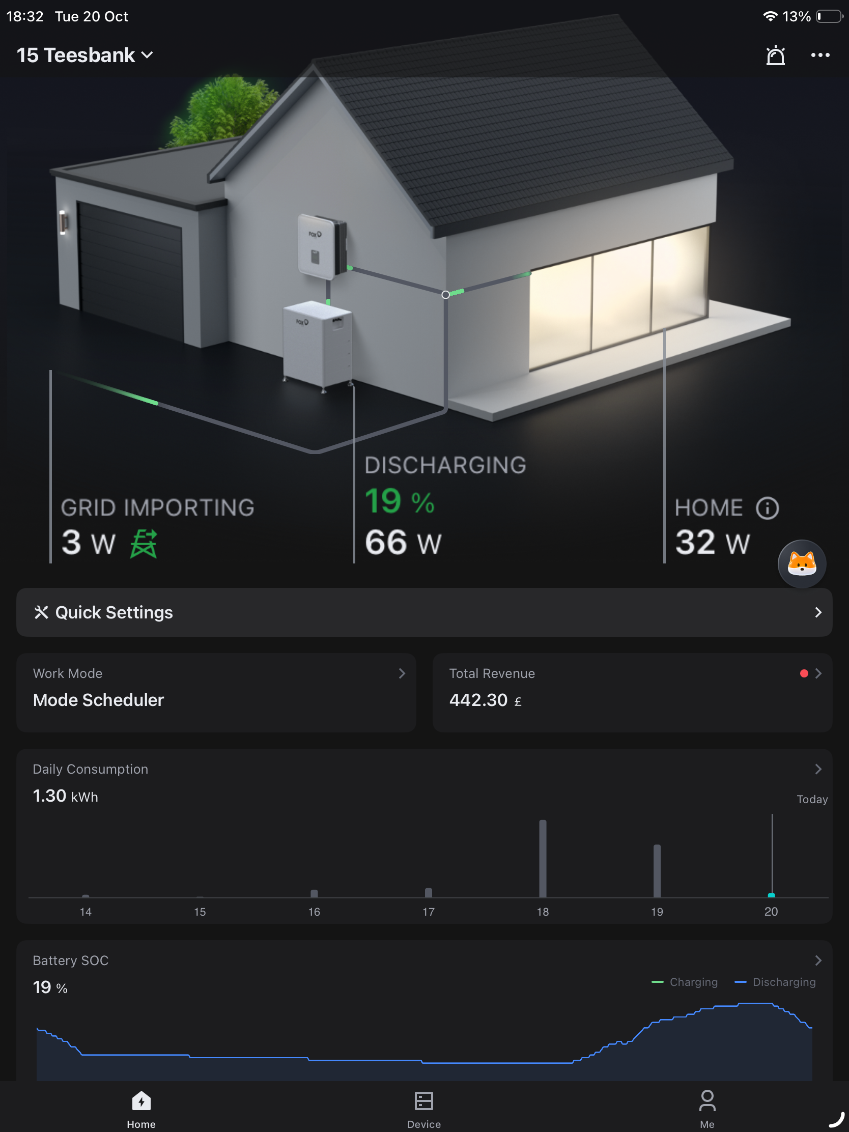

If you are using the FoxCloud2.0 App, can you take a screenshot of the following if possible;
1. Home screen
2. Work Mode, show your schedule
3. Daily Production
4. Statistics (bottom of Daily Production page)
1. Home screen
3. Daily Production
Your mode scheduler looks a lot more basic than mine, just wondering if there is any firmware upgrade available?

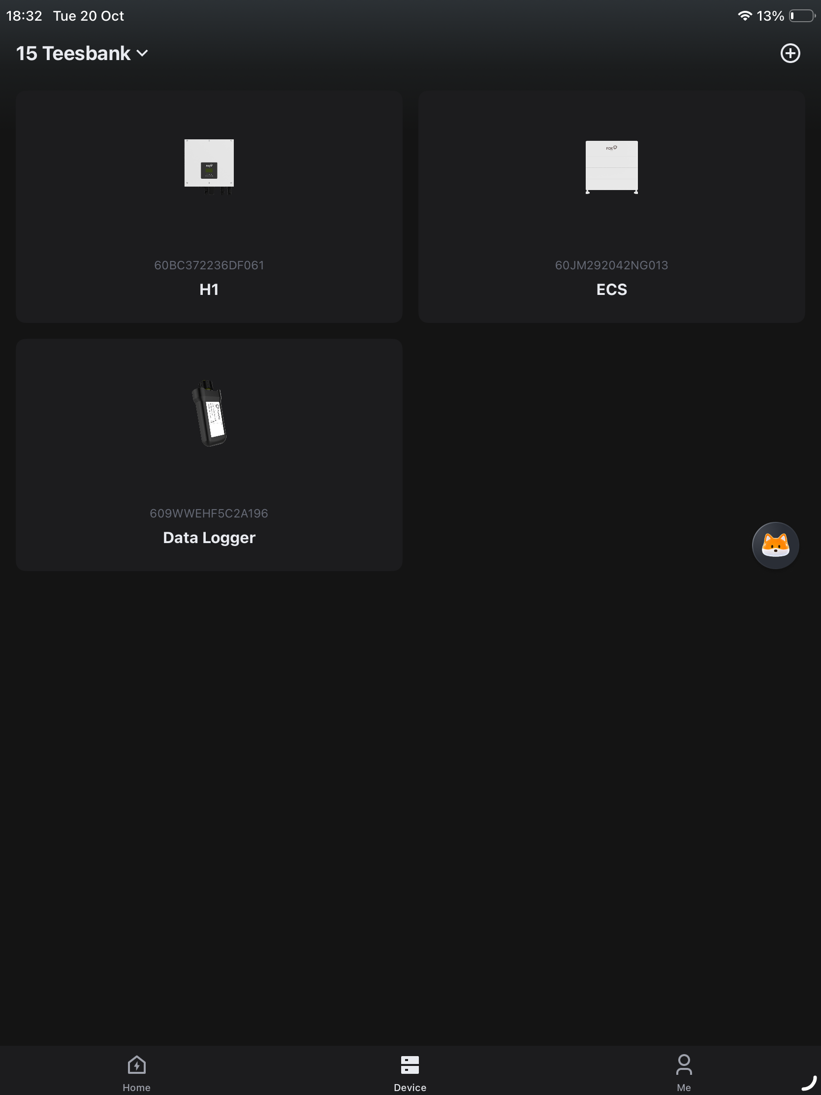

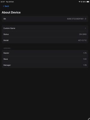

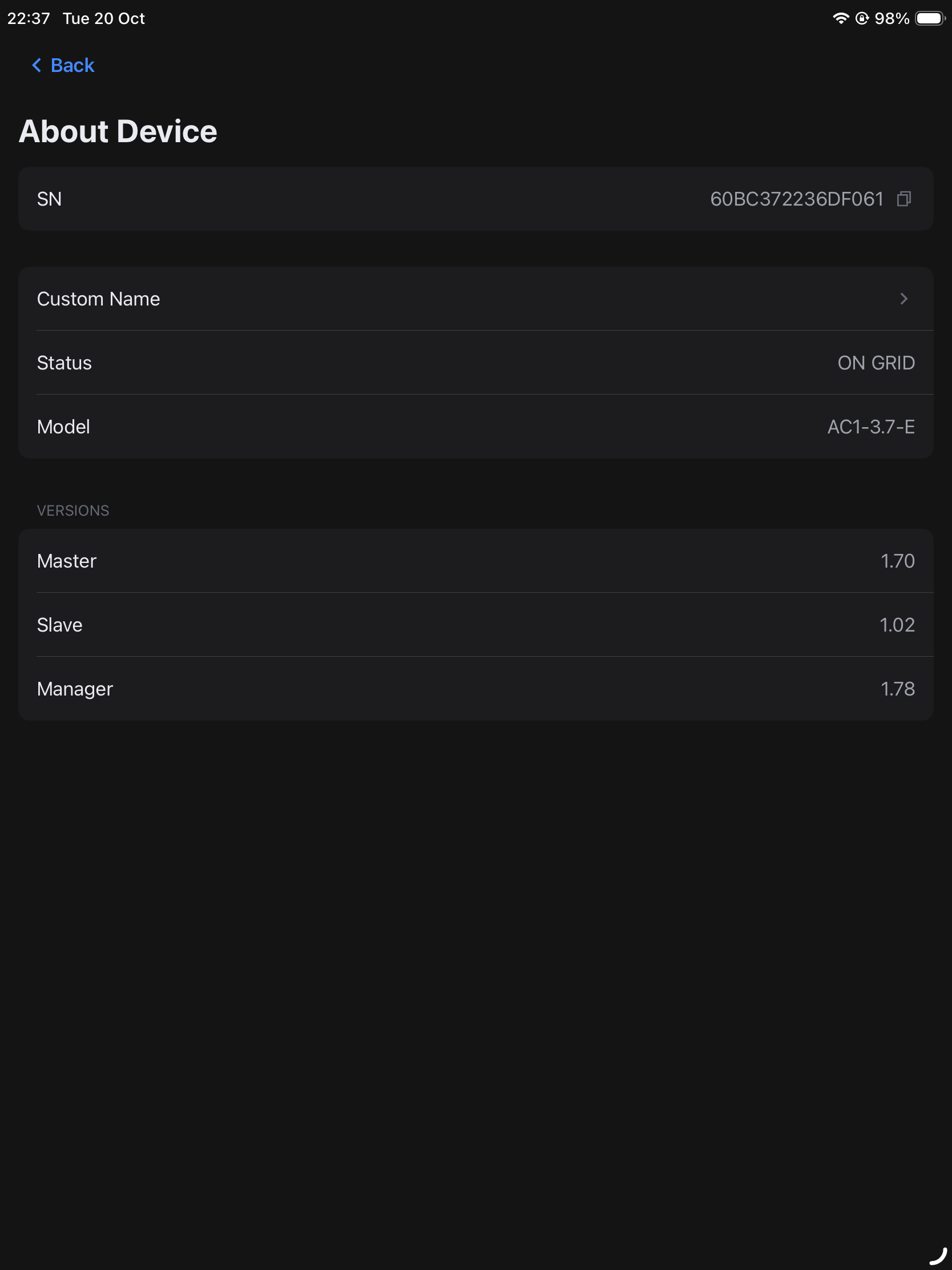

On your last picture, if you click on the Inverter SN, there you should be able to see what is loaded currently.
If there is an update, and you can apply it, I recommend you do so. Grab screenshots before/after for own records of course.
Nothing happens when I click inverter SN. Is there a different way to check this?
I’ve checked all the devices in the mobile app. None show they need updates. That would have been far too easy!
Your picture says 1,000 words (firmware is current)
H1 (legacy) if I am not mistaken...

Two final suggestions, at some point, restart the system https://www.youtube.com/watch?v=xBTtKaX-k14
and if the App still won't charge it, then you should be able to set a charge up on the inverter screen directly https://www.youtube.com/watch?v=wDY3DllWakQ
