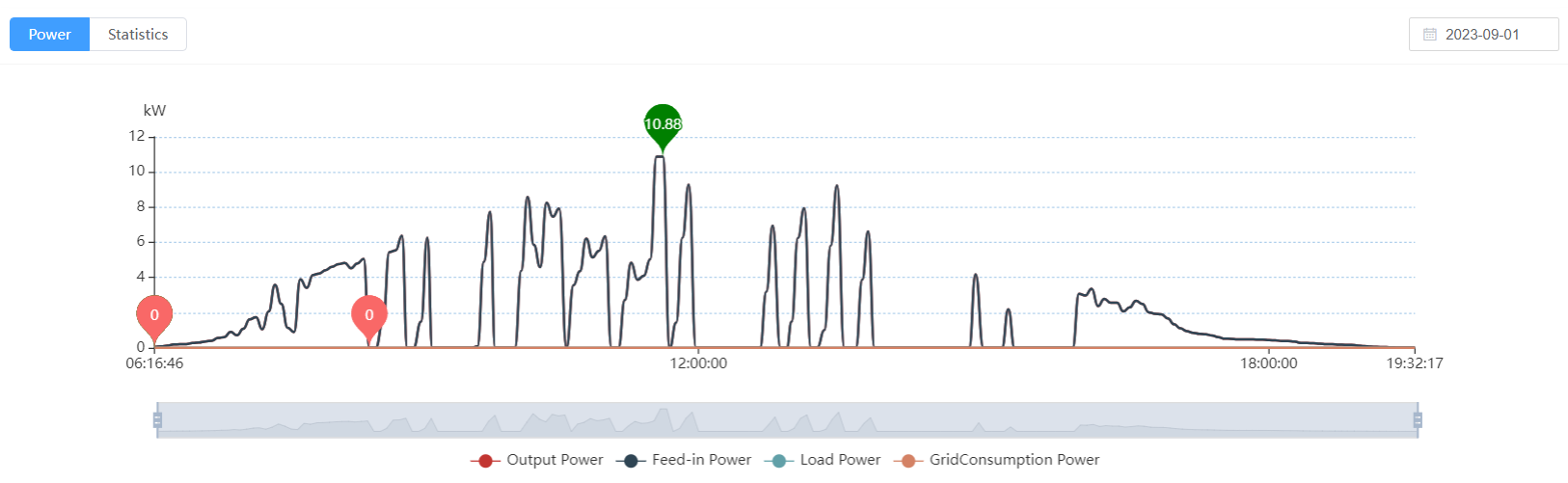

I've been dealing with a persistent issue involving Error Code 28, also known as the "10 Minute Average Grid Voltage Fault," ever since my FoxESS 3PH Inverter T12-G3 WiFi was grid-connected in March 2023. I had been waiting for an electrical grid upgrade in my neighborhood, which took place last week, in hopes that it would resolve this issue. Unfortunately, the problem persists.
Each day, I experience multiple instances of this error (around 28-30 daily), and it seems to correlate with 'RVolt' values reaching as high as 254.7 V. Due to this, my system's efficiency is severely impacted; I'm only generating between 18-28 kWh per day, although I should be getting way above this amount.
Picture for reference is attached of sept 1st kwh production

Ha ve a read of this thread https://www.foxesscommunity.com/viewtop ... ltage#p668
Do you have an equivalent setting on your T12?
