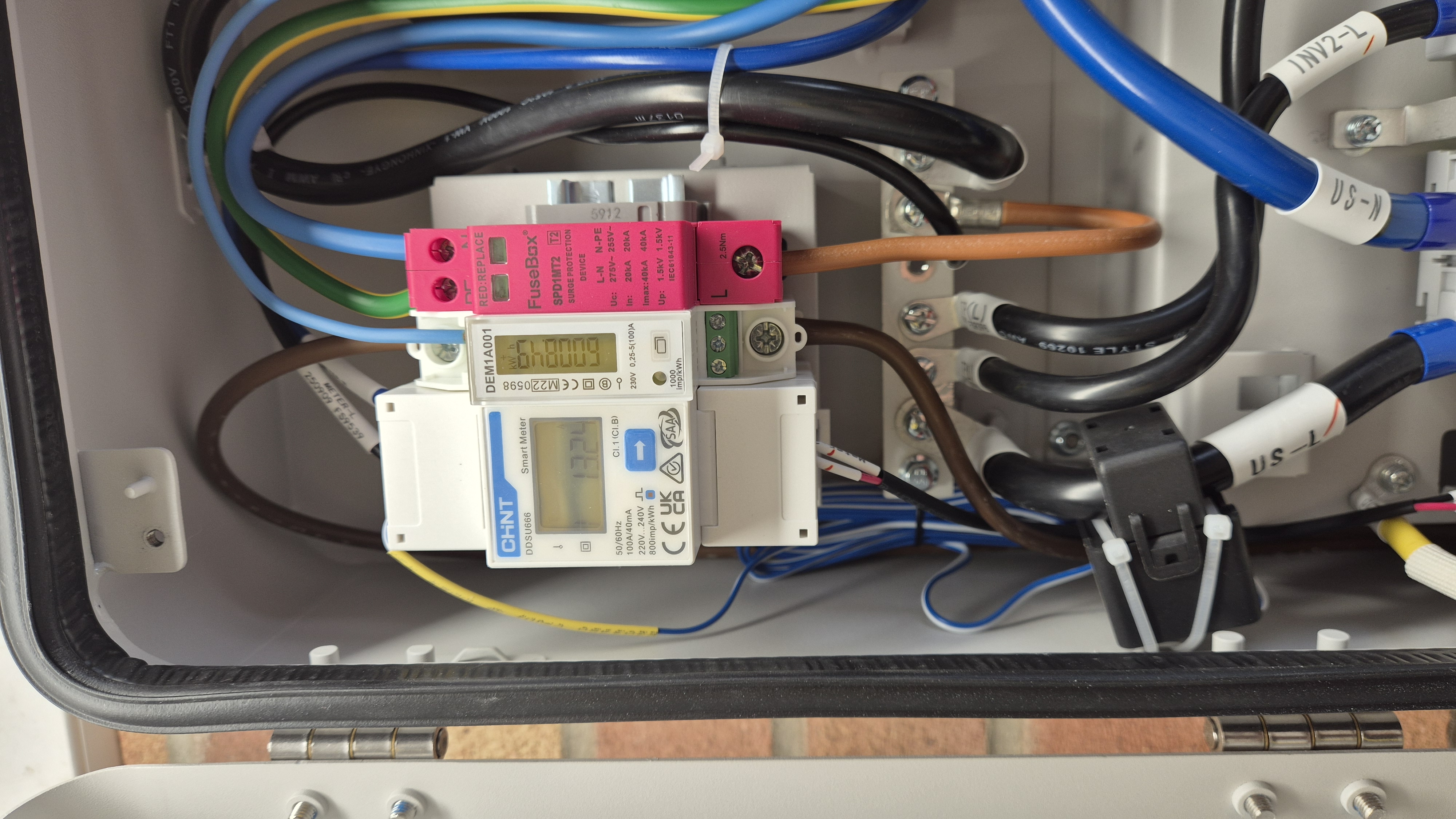

When on grid, the inverter and dashboard display tie up precisely with my smart meter IHD so am assuming the data is fairly accurate..

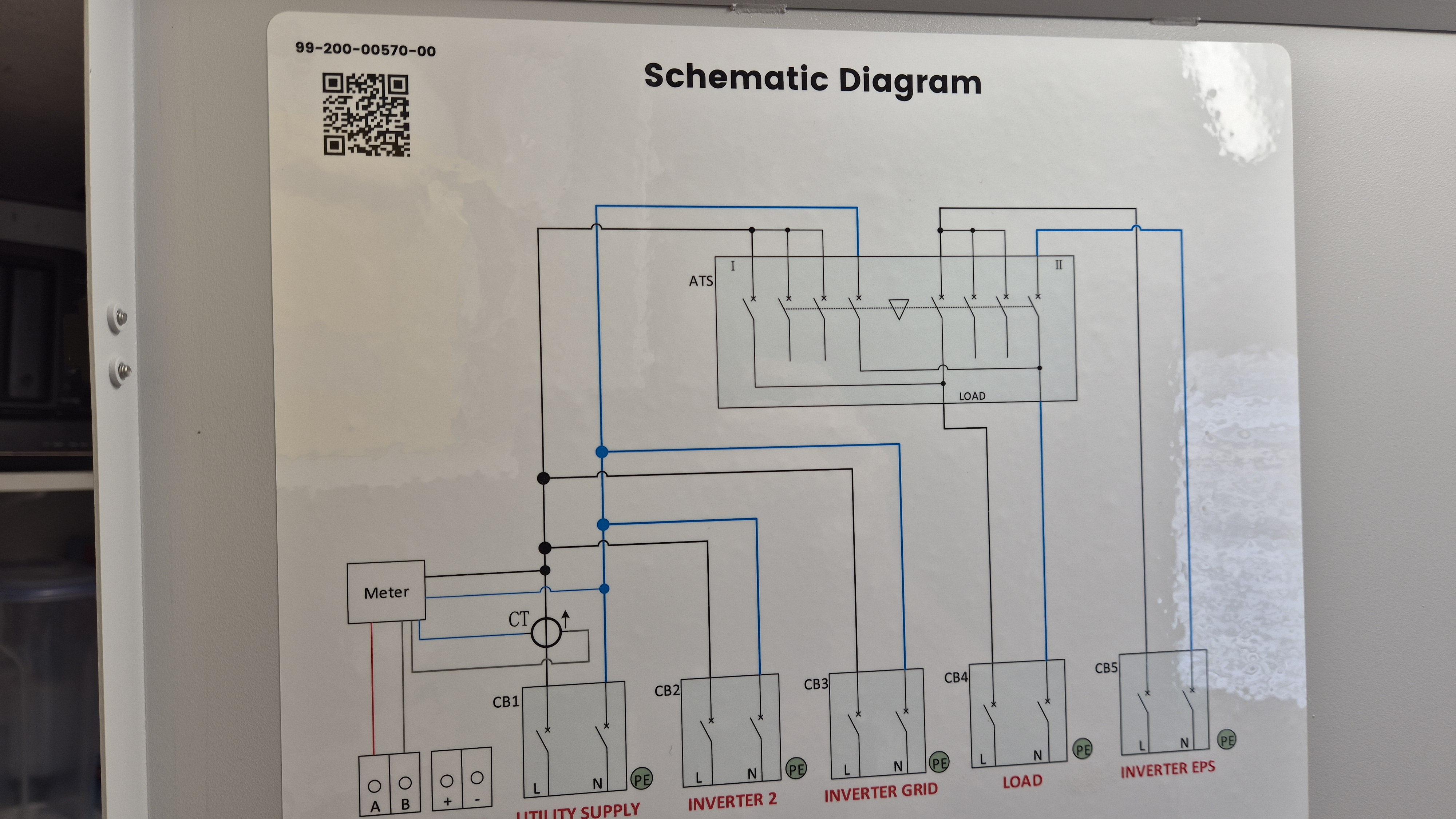

We have a Chint meter in the EPS box which is cabled back to the inverter so presumably giving more accuracy, this has a wired CT clamp on the incoming supply feed, presumably monitoring the loads and directions?
FOX KH7 7kw hybrid inverter
EN-EPS-BOX-SP gateway
