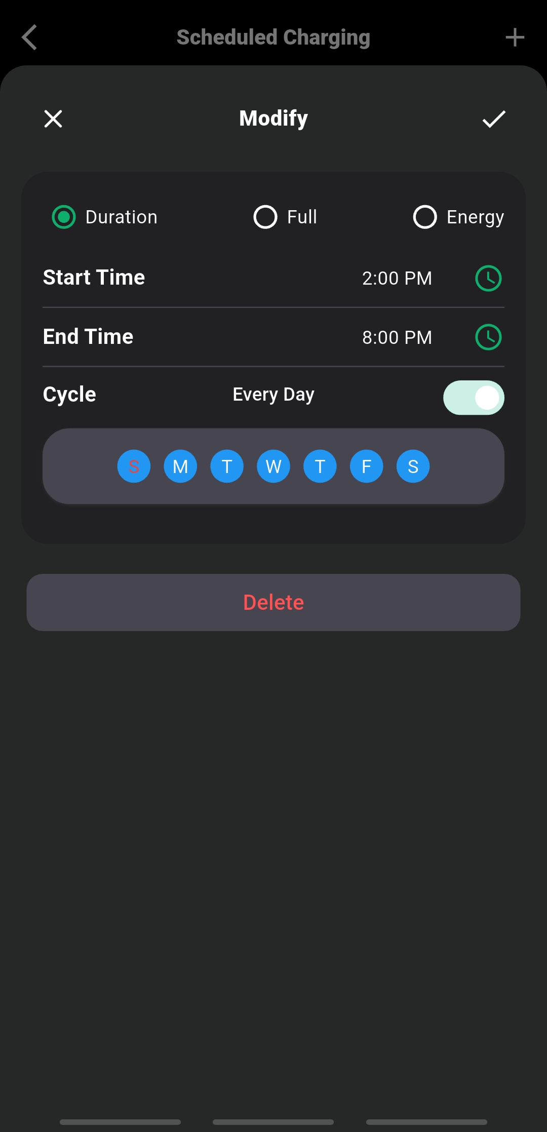

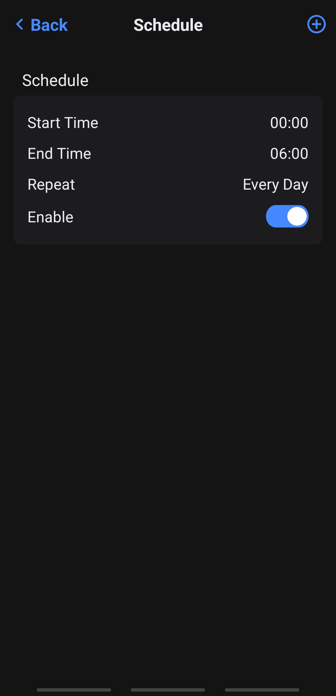

The charger has its own app, FoxSwitch, but it can also be linked to the FoxCloud 2.0 app. When I create a charging schedule in FoxCloud, the schedule also appears in FoxSwitch, but the charging times shown are completely different. Both apps are set to the Melbourne/Sydney time zone(Also logged in with the same my FoxESS account)

Ps. I've attached 2 screenshots where I set the EV charger schedule for 00am - 6am on FoxCloud 2.0 app but it then syncs to the FoxSwitch and shows a completely different time of 2pm-8pm
I have the same scheduling issues in Fox cloud, have to use Fox switch app for the schedule to be in the right Timezone with the a series charger
