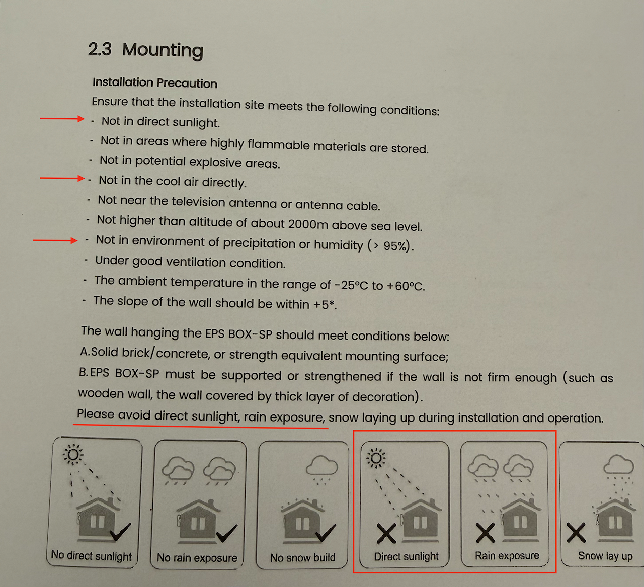

Thanks for the heads up on installation location.
I asked my installer if this should really be fitted outside, as we are coastal and everything metal rusts,
they said no problem the boxes are fully IP66 and meant to be installed outside and close to mains supply.
I found an installation manual, which essentially says install out of direct rain & sun ... I have both ... so am a bit worried.
What did your installer advise?

I pointed this out to my installer but they saw no problems with it either.
To be fair it shouldn't be a problem if the case coating didn't leave an exposed metal ring around the earthing point. They may have altered their production by now to correct it, so in the future it may not be an issue.
I think if you want longevity of any of these powder-coated metal boxes (EPS, Inverter or battery) the best approach is to put protection around them for UK installations. It could also help with the inverter getting too hot in summer and the battery getting too cold in winter.
