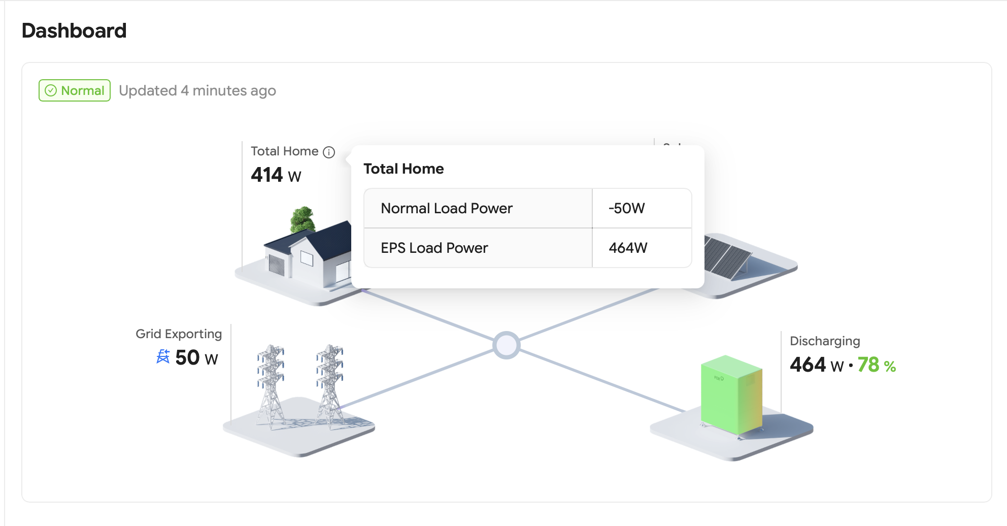

Have moved into a new property with FoxESS Inverter, Battery Installed.
EPS Load displayed is the same as Total Load.
When I saw EPS load I was hopeful that it might mean we could avoid power flick overs but no the inverter records events when the mains flicks over.

They also have the same dashboard display where EPS Load matches Total Load.
The installers technician confirmed that there was noting connected to the Inverters EPS output.

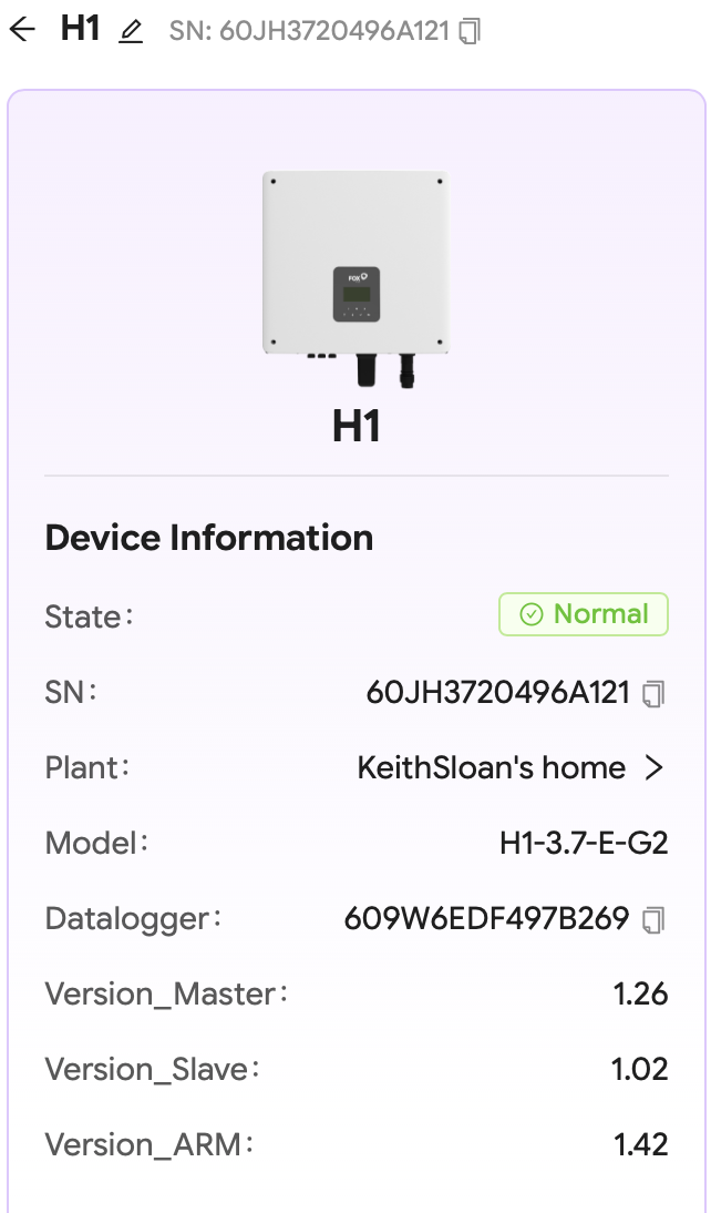

The firmware levels seem quite old. Would anybody be able to confirm that firmware updates would fix the display issue.

The answer to the EPS load = Total Load is not straight forward as there have been numerous problems with the app mis-reporting Total Load as EPS load and also different firmware versions have exacerbated the display problem.
That said your firmware is very old and needs updating, the latest firmware versions are listed here viewtopic.php?t=1927
