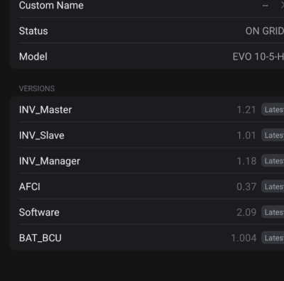

All other firmware stats 1.x apart from AFCI which is 0.37.
The fix was pushed on the 2nd July, so must be taking a while to debug the 1.18 that caused the issue.

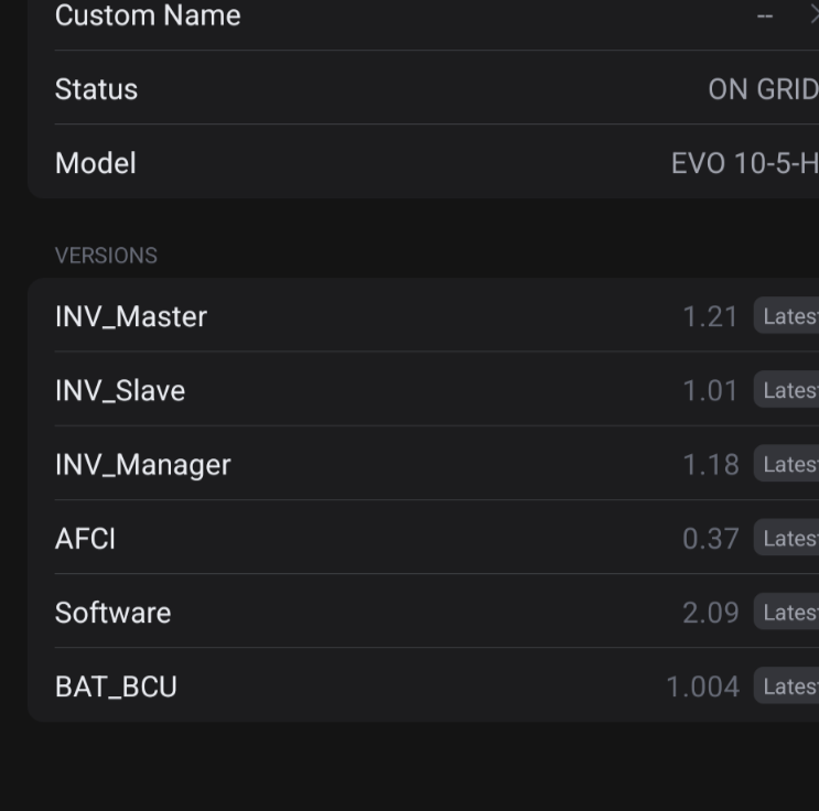

Fox has made further changes to my firmware which they claim will make the alarm messages "disappear".
These are the versions I'm now running.
Re: Evo 10 Inv_Manager Firmware issue 1.18

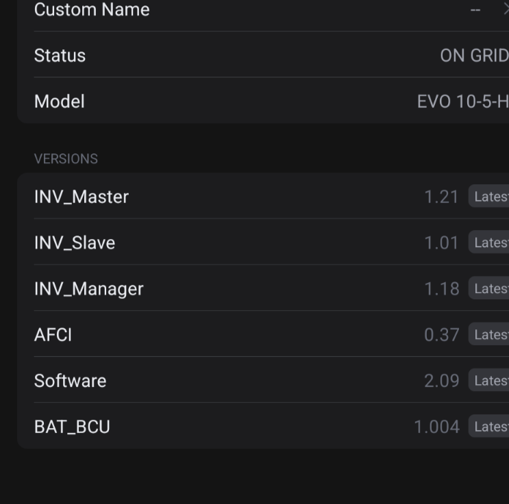

That looks like new releases then, I still on 1.18 for MASTER and 0.16 for MANAGER. All others the same.
Hopefully they’ve fixed the 1.18 MANAGER update then. Still no updates showing on my unit though. I’ll be reluctant to installed them anyway to be honest.
The last update, as well as the fan update, has caused the app to show 0w import when I’m not exporting, which is not the case as I’ll usually be pulling 10-20w for grid sync etc. It has also caused “Grid Information” to show just a dash rather than import too. Fine when exporting.
