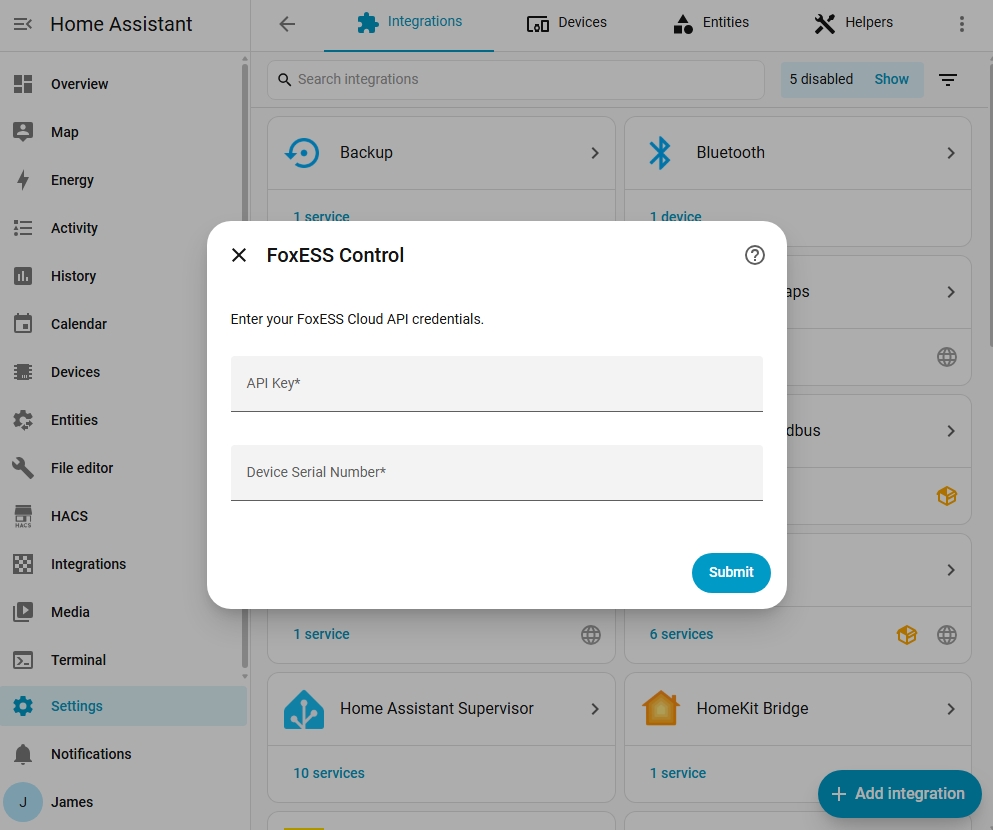

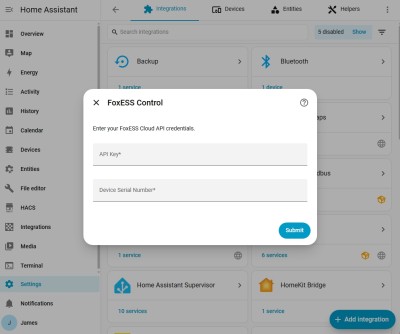

Just an FYI/heads up, it doesn't seem possible to enable the Addon without providing API Key.
I was intending to use Modbus.
Is the API key still required? Is this a bug (feature) or oversight on install? i.e. could the user be provided a toggle to chose API/Modbus at time of install?
If you install the modbus extension too, you can still use it. It's referred to as entity mode in the readme.
I've already got the Modbus extension installed. But in order to add/enable "FoxESS Control", it first prompts for API information
It should be optional. If you provide it, it will be used as a fallback, but you should be able to configure the modbus entities without providing any keys.
Looks/sounds like a bug in the enabling of the addon workflow then. I’ll get some images.
I have an installer account so can’t get the API info from ‘user profile’. Nor do I want to expose my setup to the web.
I haven't seen bug reports from other modbus users. Have you installed the modbus extension in a nonstandard way which might be causing my extension to not think it's present, and so hiding the entity mode configuration workflow?
Tomorrow I'll push out a release which should help capture some more information when people make bug reports. This might show what's different about your setup.

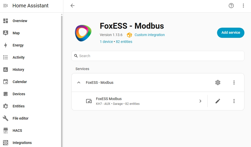

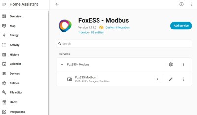

I have v1.13.6 of foxess_modbus installed via HACS. This was installed ~12 months ago.nicois wrote: ↑Tue Jun 02, 2026 12:59 pm I haven't seen bug reports from other modbus users. Have you installed the modbus extension in a nonstandard way which might be causing my extension to not think it's present, and so hiding the entity mode configuration workflow?

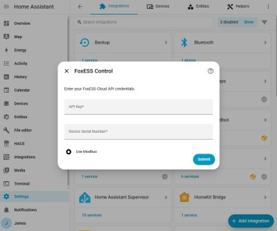

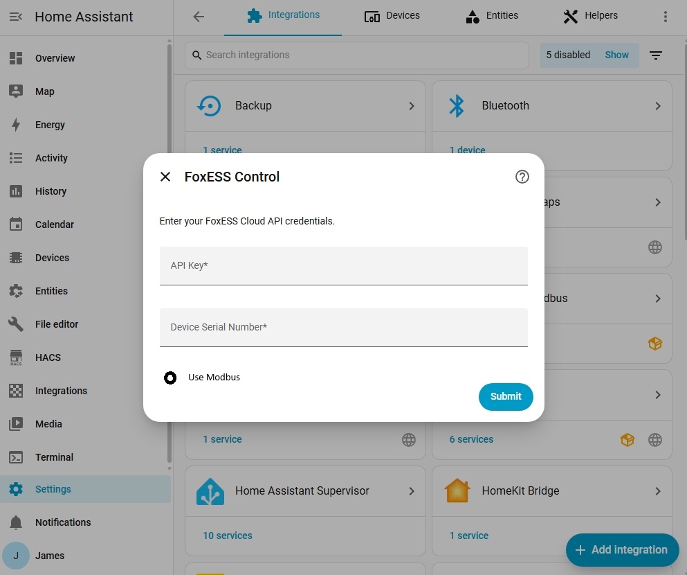

I have just stumbled across your addon and installed it this morning, when trying to install the Addon via Integrations > Add Integration > FoxESS Control, the first thing I see is;
Which is prompting me for API Key and Serial number, both of which are required fields. So I am unable to proceed without populating the details. I'm assuming a connectivity check occurs when submitting, as entering dummy details does not work.
Unless I'm doing something wrong, having the ability to select "Modbus" at this point in time would be really beneficial, no?
