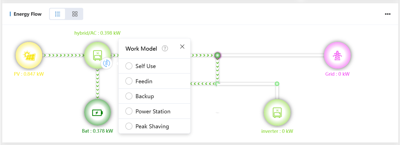

Has anybody noticed the new functionality within the cloud (via web) ? Think it's only appeared today
Work Model
Options are
1) Self Use
2) Feedin
3) Backup
4) Power Station
5) Peak Shaving
Sounds exciting
Haven't dared to change mode yet :-)
Appreciate some of these options are similar to those accessible via the inverter itself, but great to see them available via remote access.

Interesting, now all we need is a guinea pig and to understand what the different modes actually do.
Do you think Feed In or Power Station could be a force discharge to grid?

This is what I've learned thus far:
1 - Self use seems to prioritise my own consumption and battery charging.
2 - Feedin seems to prioritise feed to the grid over battery charging in that any solar I'm not using directly goes to the grid. It seems to happen at peak consumption times eg this morning around 9 am my bats weren't charging and I was exporting.
I imagine that some of the remaining 3 options will set my installation to run as a mini grid backup during excessive grid load. Now call me cynical but how long until this is a mandatory feature for those with battery backup? By that I mean, will the gummint rule that we MUST donate a % of our stored energy to the grid?

Give it a try! Select the item you want to test, eg Power Staion, tick the box, enter your Foxess password then give the system 10 minutes or so to react/respond. See what's happening and if you're not happy simply tick the original box (probably self use) and go back to where you were.
I'm guessing here but Power Station would seem the logical choice if you want to feed battery charge to the grid unlike Feedin which appears to prioritise export over battery charge, certainly at peak times when I tried it.
EDIT: I tried "Power station" at noon today and received the error "40257 Parameter does not meet expectations". Whatever that means. Gone back to Self Use.

I got the same error with power station mode, same with peak shaving. Still, being able to change between Feedin and Self Use remotely is a solid improvement. Backup mode I'm still not sure of, surely the same can be achieved with Battery settings?

Currently, they don't do anything, I would presume (but certainly don't know) that they are there to support features that are under development for future firmware versions. As to the timing of any such future releases, I suspect your crystal ball is as good as mine.
In this thread, Will (who set up this forum and has a good tecnical understanding of these things) said
FoxESS and just about all G99/G98 systems for UK use won't be able to discharge to grid sadly.
Now, given that my system absolutely can feed into the grid when I have excess solar, I'm not sure exactly what he means by this, I've asked him to clarify as you see.
But to answer your original question, I don't believe there is currently a mode on the inverter you can use to do what you're asking.
